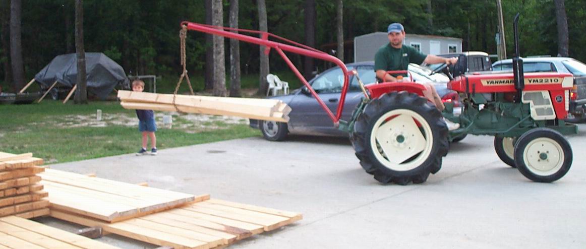

Just wanted to show off my hard working little man helping ole dad out with some fresh cut lumber off the homemade sawmill. I hope he remembers these moments for a life time. I know I will. Thats my YM2210 I just got for $3,500. It shows 212 hrs and looks to me in perfect condition. I didn't get any implements with it, but I did pick up a boom pole for $75. It sure does make moving those logs & cut boards easier. I want a box too but not sure if I should get a 5ft or 4ft. Is the 5ft to big? I have a couple of weeks before I get it so I'm just inquiring about it now. I have more questions but I'll have to get a pic before I post so be ready for it /forums/images/graemlins/grin.gif
Thanks,
Kip

I used a 5' box with my 1700.. and hte 1700's and the 2000's have the same basic size frame... your machine should rock with a 5' box.
nice pic.

Yeah I have to concur with Soundguy. Go ahead and get a 5 ft box for your 2210. It will pull it just fine.
