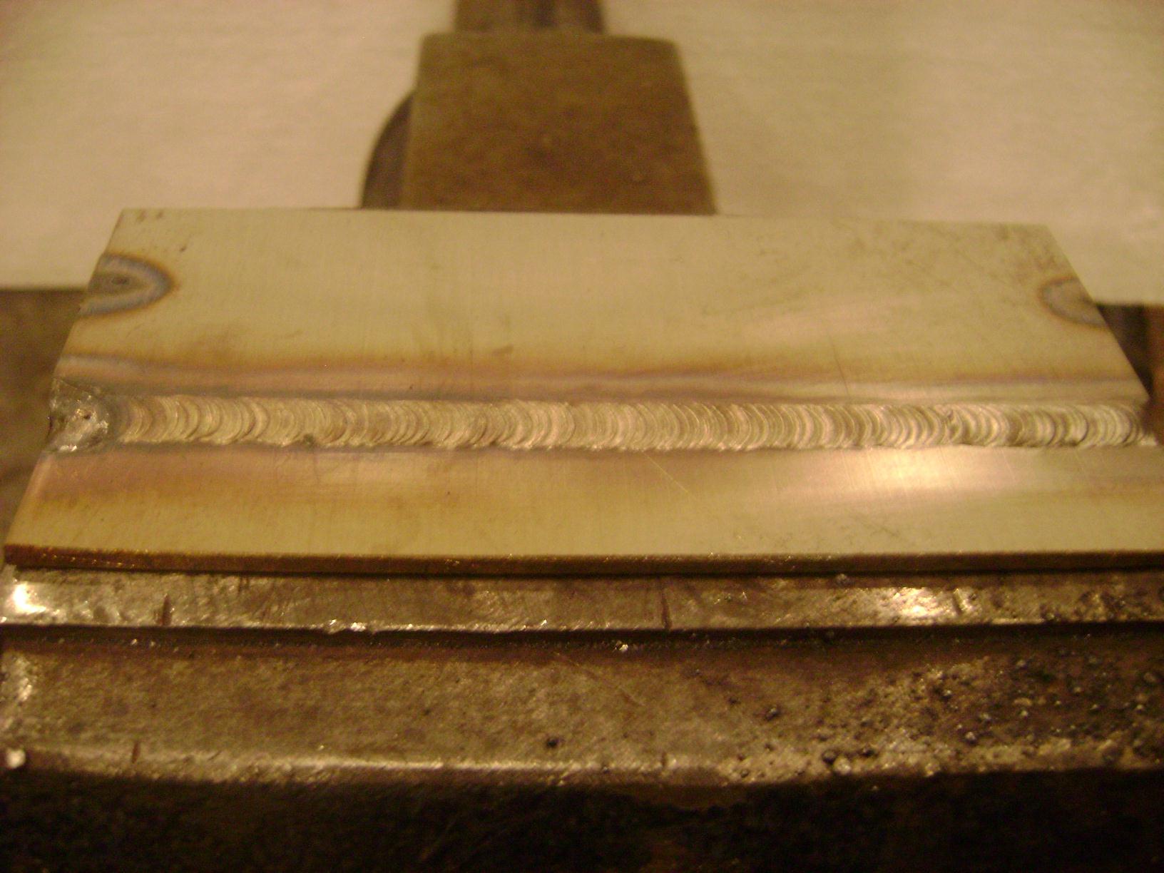

Here's a 10-GA stainless steel lap joint Tig weld I made with my Everlast PowerArc 200 and a Tig rig.

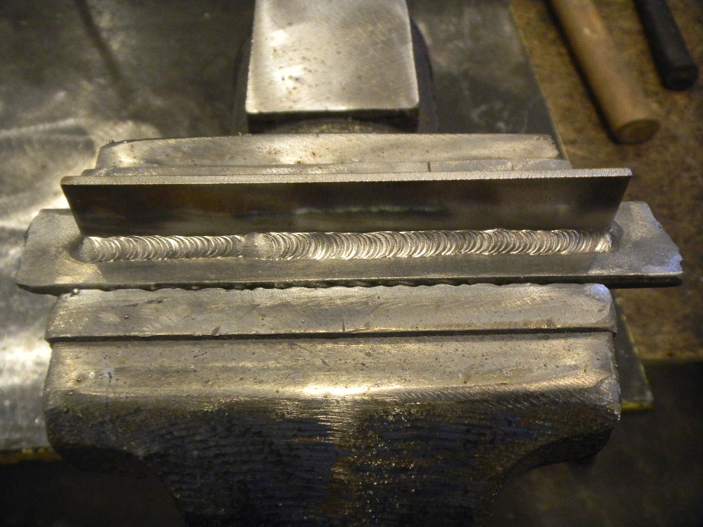

And a 10-GA stainless steel to 1/4" mild steel fillet weld I made with the same equipment.
