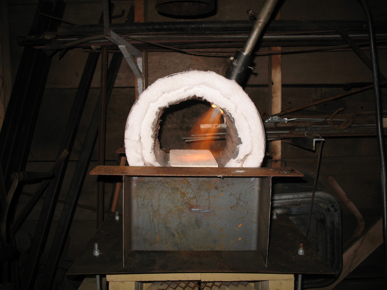

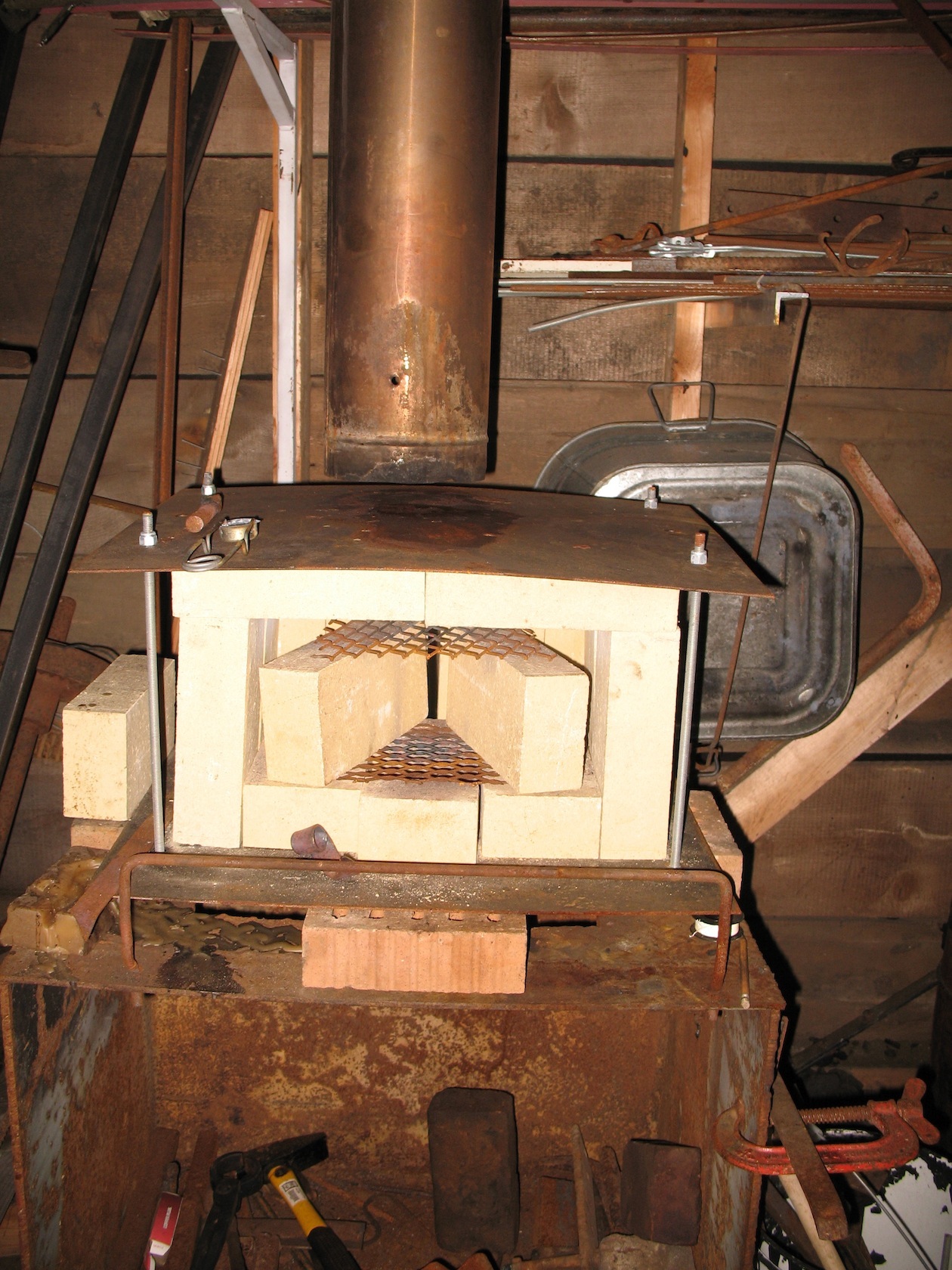

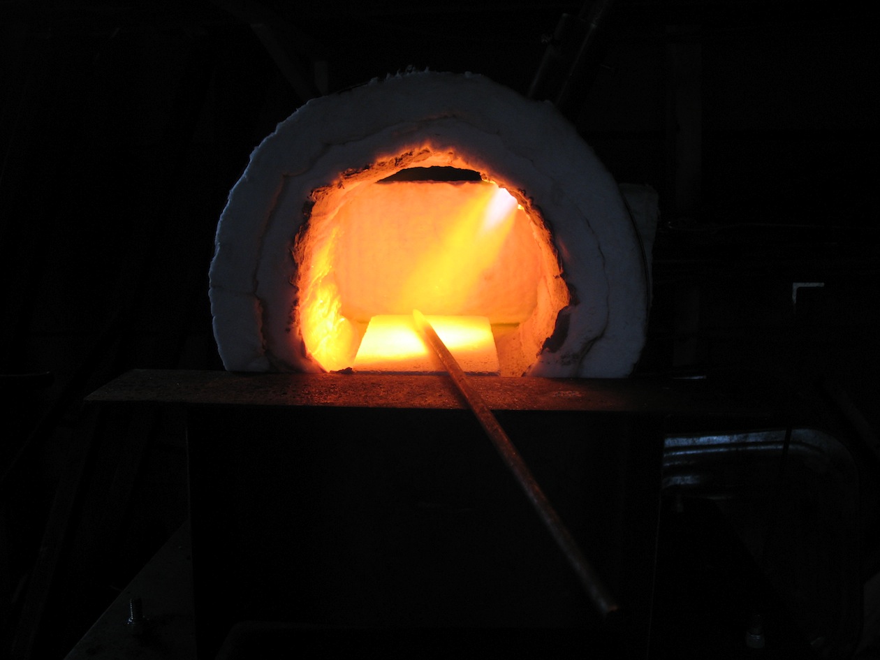

Very creative. I went from a coal forge to a propane one. I found the coal to be too messy/dirty and I always had to check on it (wood building/floor) sometimes late into the evening/morning hours. The propane is instant and when shut off I have no worry. I can get a good welding heat on a 1/2" or 1" bar no problem and it is very conservative on fuel.
I don't do as much as I should... but do enjoy it!
The first photo shows a forge I made using brick and roofing torch for heat. The torch was mounted below so the flame would travel up - heat rises! It worked great until we( Maritime Blacksmiths Association) had a weekend of building propane forges - other photos...
