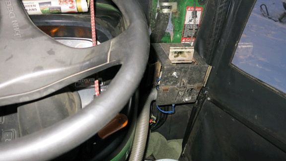

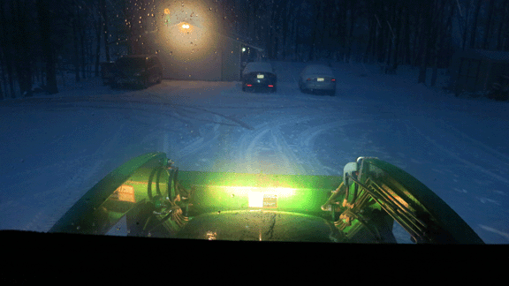

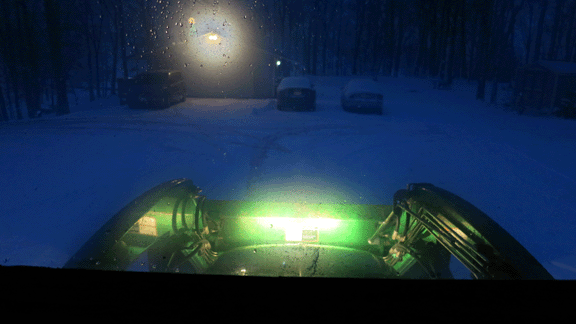

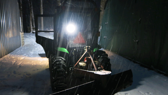

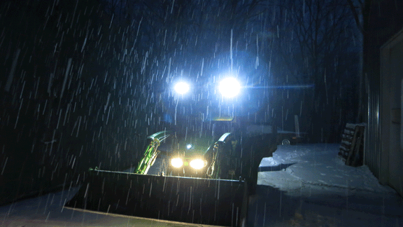

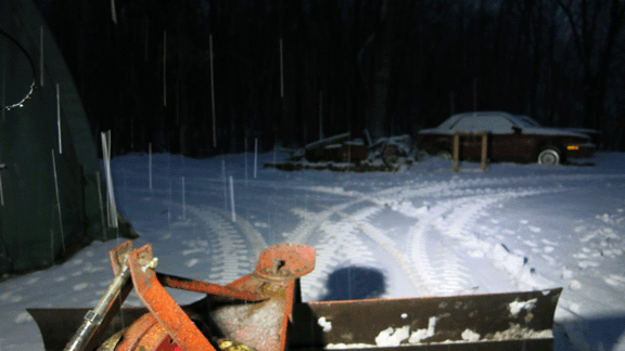

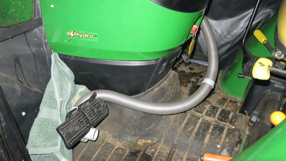

Some pics of my LEDs and heater.
I got the LEDS on Ebay for under $40.00. 2-18 Watt slims on the front and an 18W round on the back.
The heater is a $10.00 swap meet find and I used a vacuum cleaner hose I had laying around to put heat to the other side of my enclosure. The pictures don't really show how much more the front LEDs light the area ahead, but they do!

If you really need to warm up fast take the end of the vacuum hose and run it up a pants leg! :shocked:
   / My heater and LEDs
I can stick it just-a-bout anywhere! :laughing:
   / My heater and LEDs #4
May be someone on the forum works for NASA and can get you a used space suit to wear in cold weather where you can just plug in your heater hose! It would double as a great costume for Halloween also.....:D

That's sweet the heat is going to make it much nicer. I just did the same thing as u except I purchased the factory heater. I did not get any where near as good a deal as you. I did well on the lights though. I'll post pics when i can.

I like those 18 watt slims, was thinking on 18 watters, I now have 27 watts in the front,
and wanted 18's for the rear, just wasn't sure if they were bright enough, they are, thanks.
   / My heater and LEDs #8
Ratings on LED lamps can be misleading. A 27W lamp may only draw 1.5A. I found this out when playing with some I bought. They rate the power as "9 x 3W LED inserts". However they do not drive them to anywhere near 27W. Mine where only drawing 1.25A.
