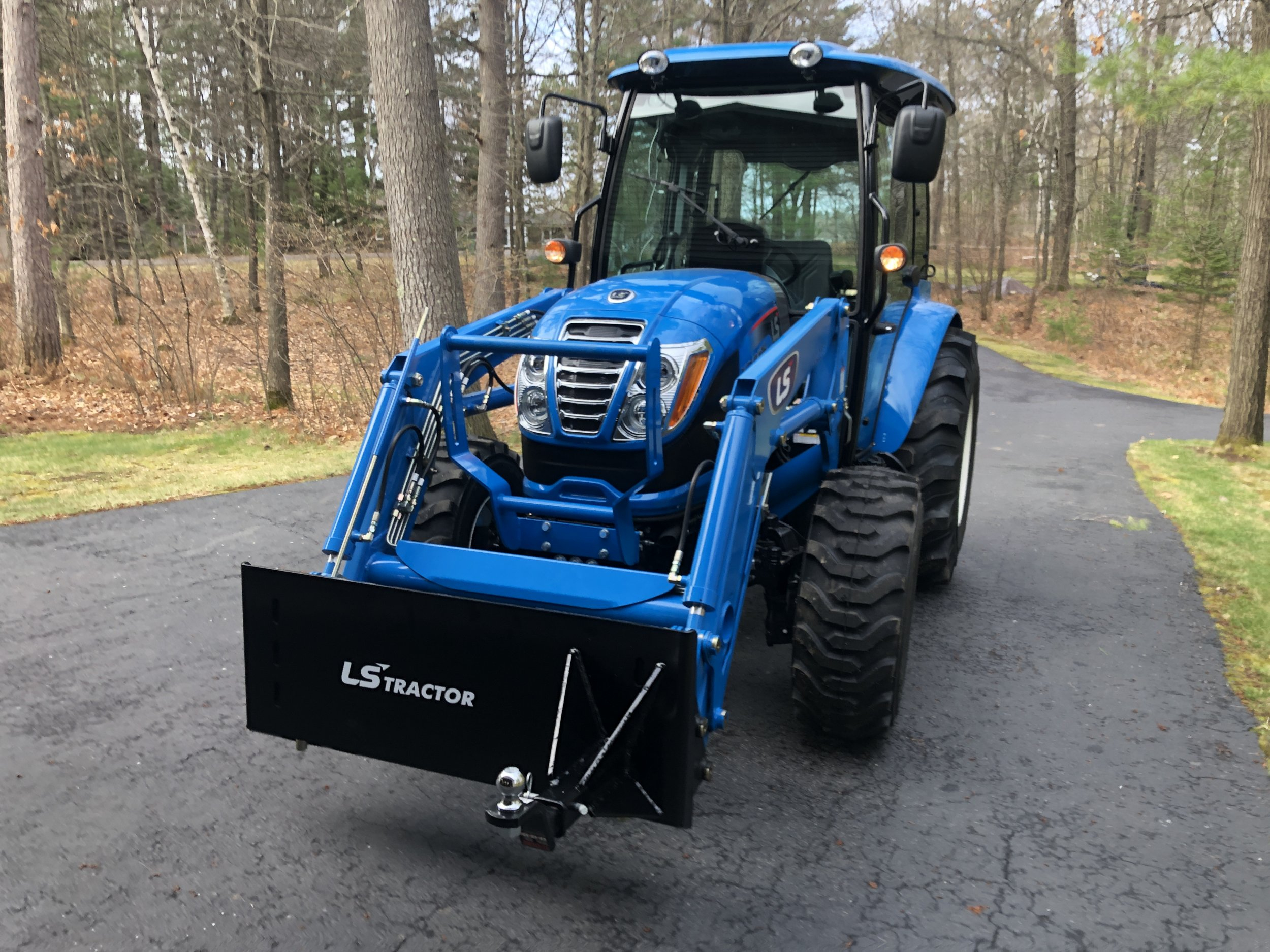

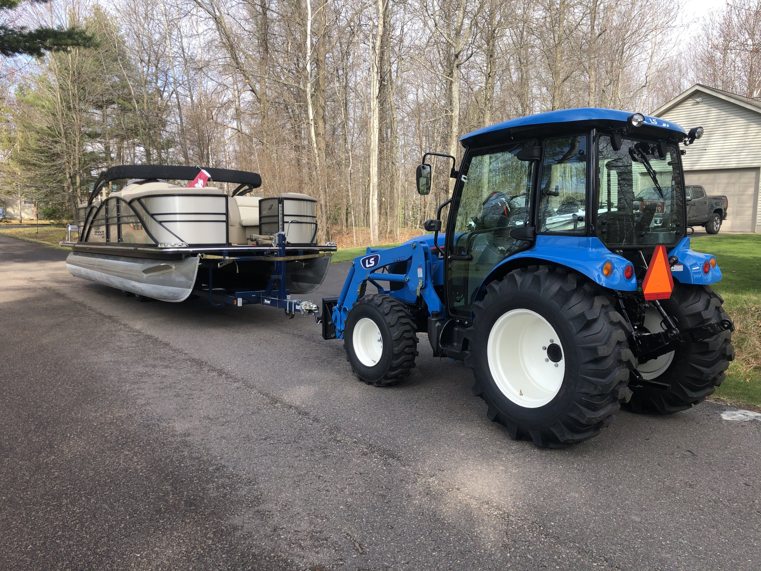

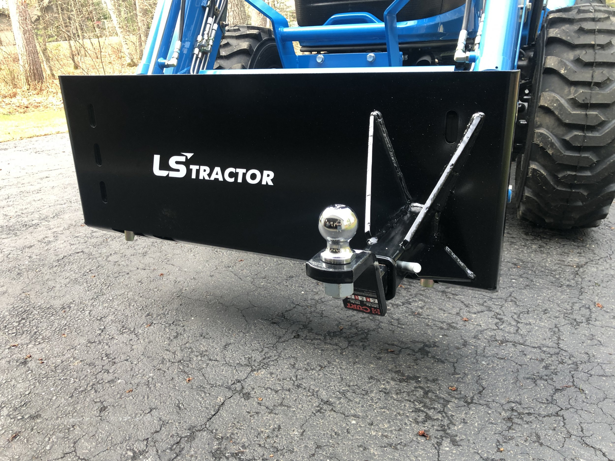

I thought I would share this with everyone. All the quick tach hitches I looked at were in the center so they are blocked by the hood. I offset mine so it is visible between the hood and loader making it easy to put the ball up and into the coupler. Here are a few shots:

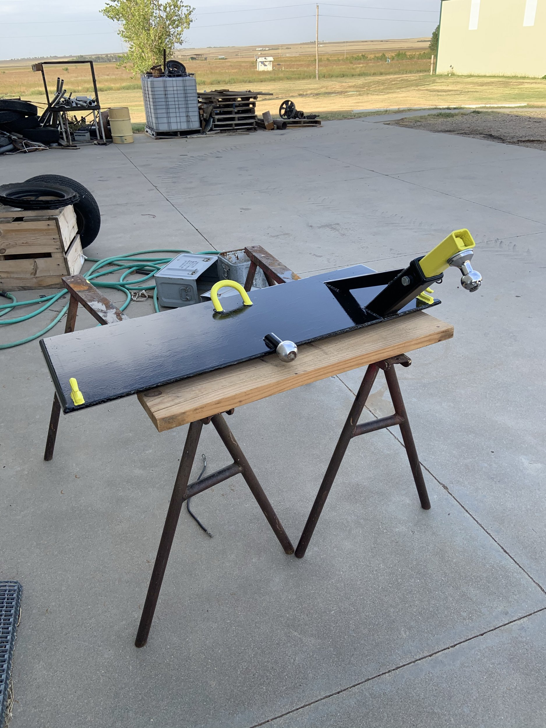

I did basically the same thing, so much better than anything you can buy.

TT, I'm guessing you angled your hitch up so that when it is level to the ground you can see what you are hooking up to and not have the SS plate in your line of sight?
