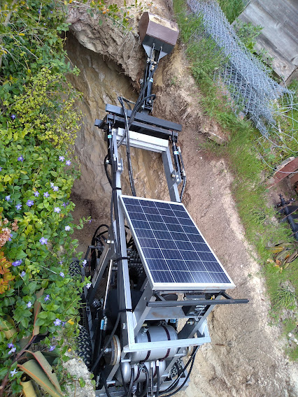

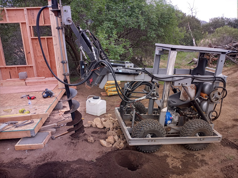

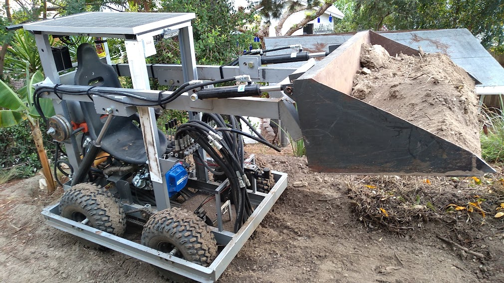

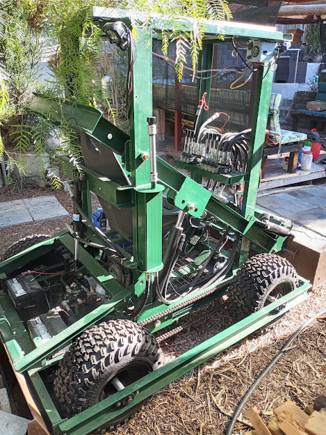

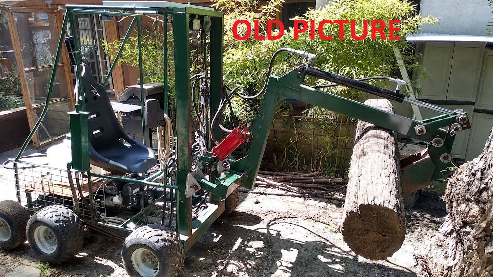

Hello all, this forum helped me out in the past (thank you!) and I again need a little help. I've built from scratch two skid steer machines with various interchangeable attachments, not sure what to call them but they dig, drill, lift and can move about 500 lbs of materials at once. I recently did some major upgrades to my first machine, the green one (Its been hacked up and redesigned a few times). New engine, pump, cylinders, chain drive, wheels, arms, valve body, flow control valve. They both are low pressure systems (2500 psi max). Try not to laugh at them too much, they work well and cost only a couple thousand to make.
My issue now is I cannot crawl up a steep 50 degree incline as I am with my other silver machine. The system pressure will not rise above 2000psi when attempting to crawl up said incline. The motor wont stall out just bog down and sit at 2000psi. The hydraulic fluid heats up pretty quick in this situation.
The machines now are now identical in powertrain terms other than the capable silver one has two 17 cu in. drive Gerotor motors and the green one has two 19 cu in Gerotor drive motors. Could the 2 cu in. difference between the two machines be the issue? The silver machine has tons of power and torque. It almost seems like fluid is getting bypassed yet I've maxed out all pressure relief valves and even bypassed the flow control valve. I understand the GPM of this system is incredibly low to what the motors call for, but I'm fine with 5mph top speed, torque is what I need.
Other general info:
16 hp gas engine
Tried both a .45 cu in. and .74 cu in gear pump, no difference
Green machine is about 300 lbs heavier then the silver machine
Green machine has much smaller fluid tank, 2 gal vs 8 gal on silver machine
These are direct drive hydraulic motor to driveshaft setups. No gear reduction. A chain links front and rear wheels together.
Silver machine has two 1/2 hoses feeding valve body, Green machine just has one 1/2 hose.
Fixed displacement pump, open center system.

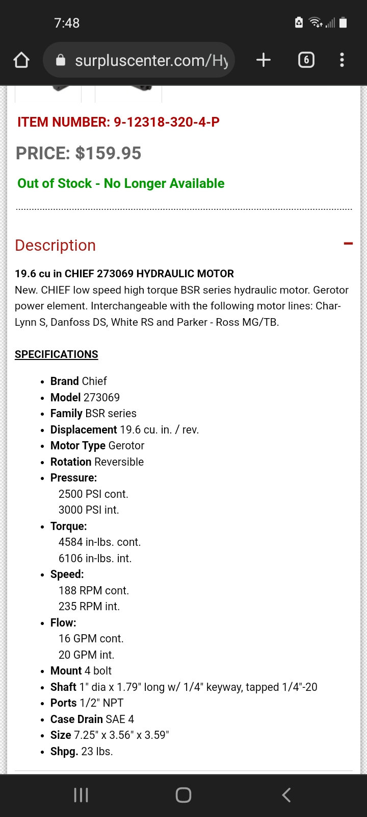

Post the brand and spec's for your motors.
You need to have an idea of the torque requirements of your drive system. A quick and dirty way would be to remove the motor, rig up a way to connect a simple torque wrench to the drive and see how many foot pounds is required to rotate the wheels.
Without that number the rest of what you are trying to do is a waste of time and effort.
Some motors are described as high torque low speed which strike me as describing your application but in the one case I looked at the motor is turning 1,000 rpm which seems far too fast for your direct drive system.

Thanks Dave. Here at the only specs I have, the current pump is putting out roughly 10 GPM-and that feeds the two 19cu in motors.
What's strange is that the other machine which works great is running roughly 6 GPM feeding two 17cu in. motors. Something isnt right...
We need the spec's for the other motor also.
You also need to do the torque wrench test I suggested

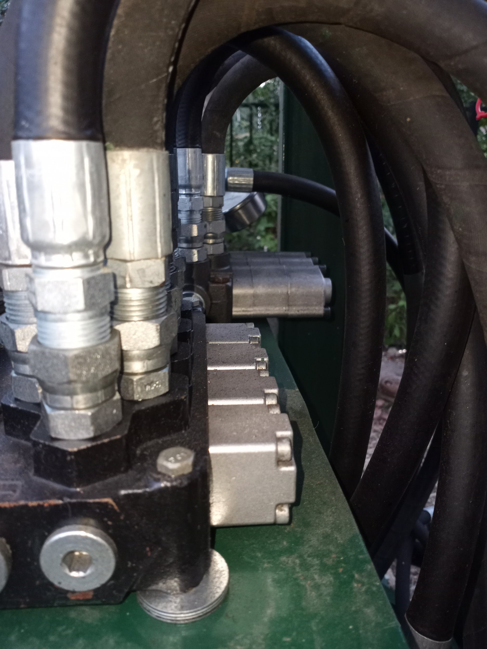

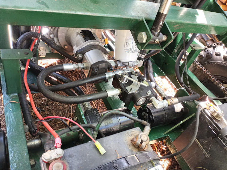

I would like to see better pics of the valve sets on the machines, but my guess right now is that there is a leak between valve sections in one of the valve sets that just isn't becoming an external leak.
   / My Homemade Skid Steer Machines
Left side fine metering spools, 1st aux, 2nd left side motor, 3rd right side motor- through power beyond fitting to lift,tilt, rear blade, aux. I wonder if power beyond fitting is leaking.
No problem hitting high psi and stalling engine with cylinder dead head.
