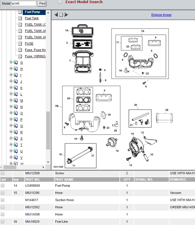

Does your engine have a pulse type fuel pump? I found the operators manual, but it doesn't spec the pump.
If as you said, you get no fuel out of the pump, you may have a bad pump, or the pulse line is broken or leaking.

I'm not sure. This is the fuel pump I was told I needed by the dealer and that's what I just installed:
Amazon.com : Briggs & Stratton 88656 Fuel Pump Replaces 69134/88281/692313/55733 : Lawn Mower Tune Up Kits : Patio, Lawn & Garden
Is the pulse line the short one coming straight down out of the pump? Do you know how I'd replace that?

John,
Yep, that's a pulse fuel pump. It is driven by the pressure pulses from the crankcase. You can learn how it operates by doing a google on pulse pumps.
I am not familiar with your tractor. Can you provide a photo or two.
Richard
   / My JD LA145 Isn't Starting #9
OK, some new things happened this morning. I took the fuel line off the outlet side of the fuel pump and attached another hose, turned the engine over and gas is coming out now. Not sure why, maybe I did something wrong before. I also removed the pulse line and manually turned the air intake screen thing and air is puffing out of the hose.
