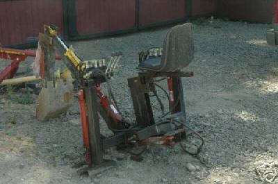

My latest pickle is, I picked up a small 3pt backhoe for my 155D that already has a loader attached. I am in the process of trying to figure out a way to mount it to the subframe that is already under the tractor from the loader that is there. Shouldnt be too difficult but.....

I cant find any model or serial or any #'s on it at all.
But it is pretty small. It looks like one of those cad planned ones you build yourself.
I cant see it weighing more than 500lbs max. But even that estimate might be kinda heavy.
The guy I bought it from said it was a manufactured type and parts are still available. But I still think it is one of the do-it-yourself kits.
It has a 12 inch wide bucket, running 3/8 diameter hoses for hydraulics, and has category 1 hookups.
Let me see if I can attach a pic?

Well, you do what you think is best, but if it was me and I had to get that stuff done, I'd hook it up and try it out. I would just take it easy and it should be Ok. If it starts thrashing your tractor around, then I'd reconsider of course.

Well I tried...
Apparently the backhoe weighs more than I thought. The 3pt could only lift it about and inch or two. Then couldn't hold it there.

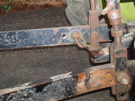

Isn't a 3pt backhoe supposed to have a solid top link, not a typical upper flex arm?
I suspect you are not hooking the backhoe up properly. It should have a solid arm sticking off of it for the top link. This holds the hoe steady on your tractor. The lower arms don't hardly lift anything - they are just stablizer holders.
This is why 3pt hoes are hard on tractors - they put _all_ the stress on that top link. The stress gets transfered to the middle of the tractor, and some are built with rather weak housings in the engine to tranny area - so a hoe can crack them in half there. The 2 weak spots are the top link, & the middle of the tractor.
As well, get the boom sucked in close to the tractor - this makes them a lot lighter for the tractor to lift. Tho in all the 3pt hoes I've seen & the one I own, that upper link is a solid, ridgid deal & you can't really lift the hoe at all. You need to adjust the length of the upper arm so it sits level on your tractor - not lift the bottom arms.

Well I got the 3pt hooked up properly and it lifted it. Although it was straining, I got it up enough to get it unloaded from the trailer.
I had to reposition the links that connect the lift arms to the lower arms, not sure what to call them. But once I got them mounted a bit farther back it had more power to lift. Leverage is everything!!
Here is a pic of what I am talking about. The pic shows the "links" attached at the forward position that would not lift it.
