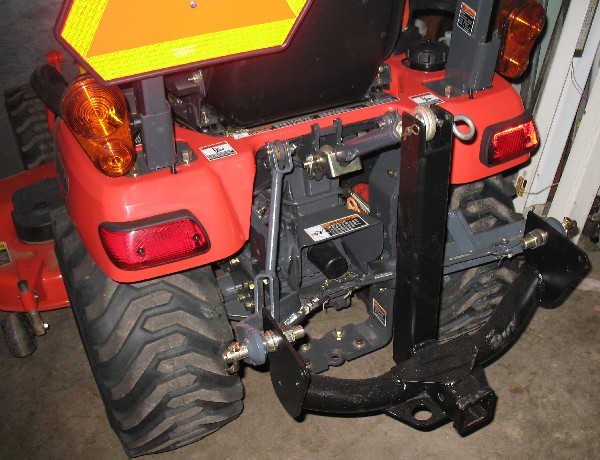

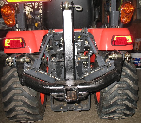

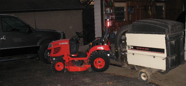

Thought I'd post my most recent homemade implement, picture of my leaf eating machine, and a pic of my little son getting a ride on the hay rack ride utilizing my new implement.......
The receiver was an old hitch my dad had removed from a customers truck.. I just shortened it up and added the center link...
Cost,,,, $6.00 in the pins from TSC, a little electricity, some weld wire, 2 hrs time, and a little paint,

This goes to prove that nothing is ever wasted by someone that has time and a welder. It is an interesting adaptation of an old hitch. The only thing that I don't understand is the strange colored hair...... LOL... Dusty
   / My Leaf eater / & Homemade receiver.. #3
Looks great. I really like the receiver. Nice job.
   / My Leaf eater / & Homemade receiver.. #4
Great job and excellent idea.:D
