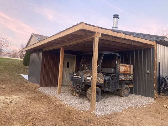

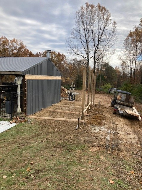

I really want to build another pole building as I’m running out of space for all my junk/projects. I plan to wait off a bit in hopes that material prices come dow.
After looking at a lot of lean to postings on this forum, I decided to build one off the back of our pavilion.
The existing wall is 24’ long, I went out 12’ with a 2’ overhang. I wanted to keep as much ceiling height as possible so roof is a only 12-1 slope.
1/3 of it will be an inclosed lockable storage area, the other two “bays” will be left open for my RTV and 4wheeler maybe some firewood storage.

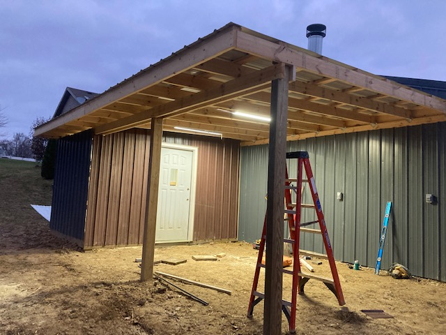

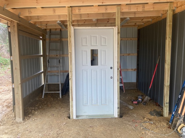

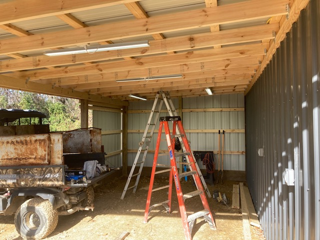

I closing one bay, added some lights and outlets.

I had some used metal (brown) and a door, free from a tear down I did a few years ago, I finally found a use For them.
