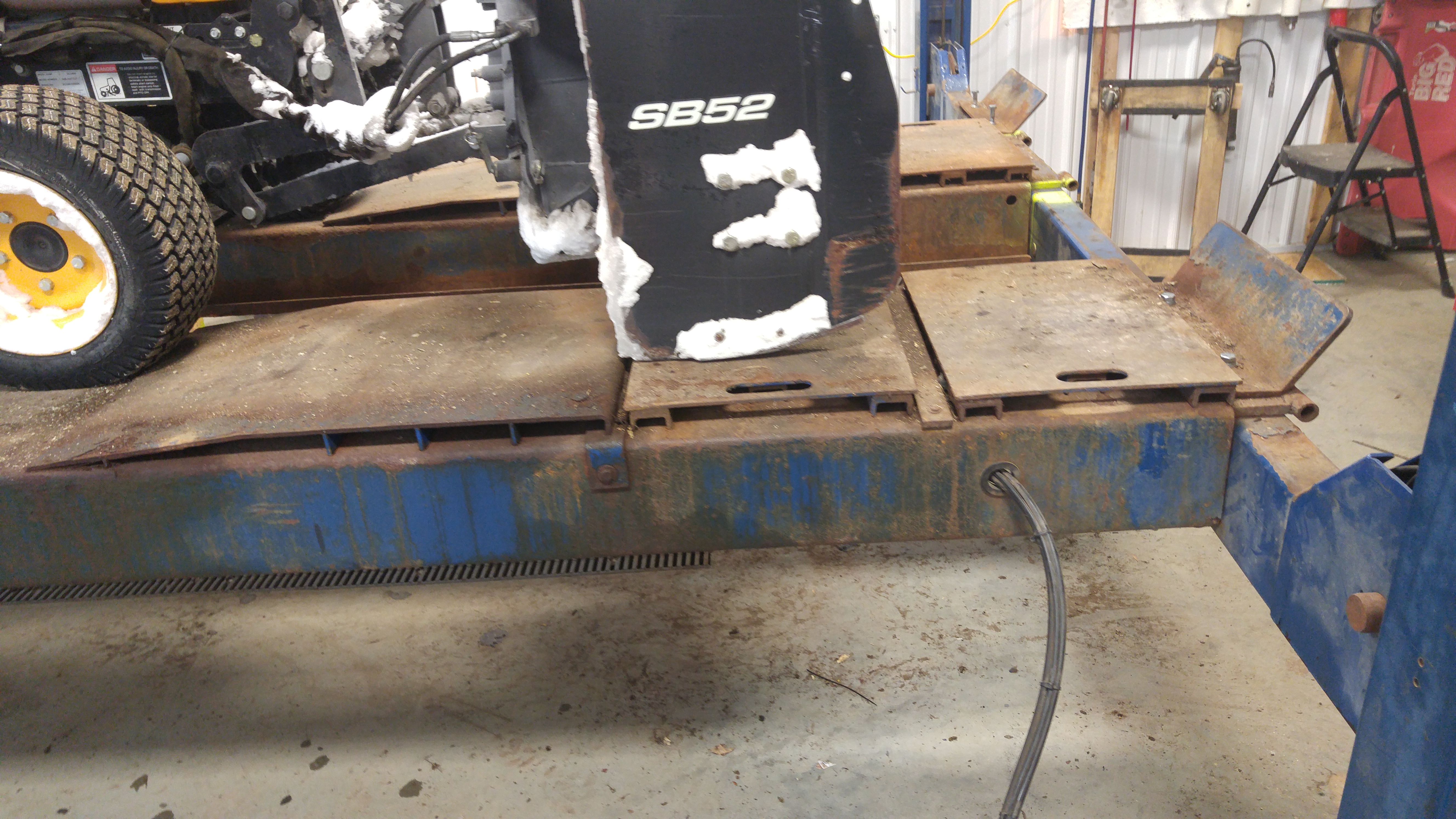

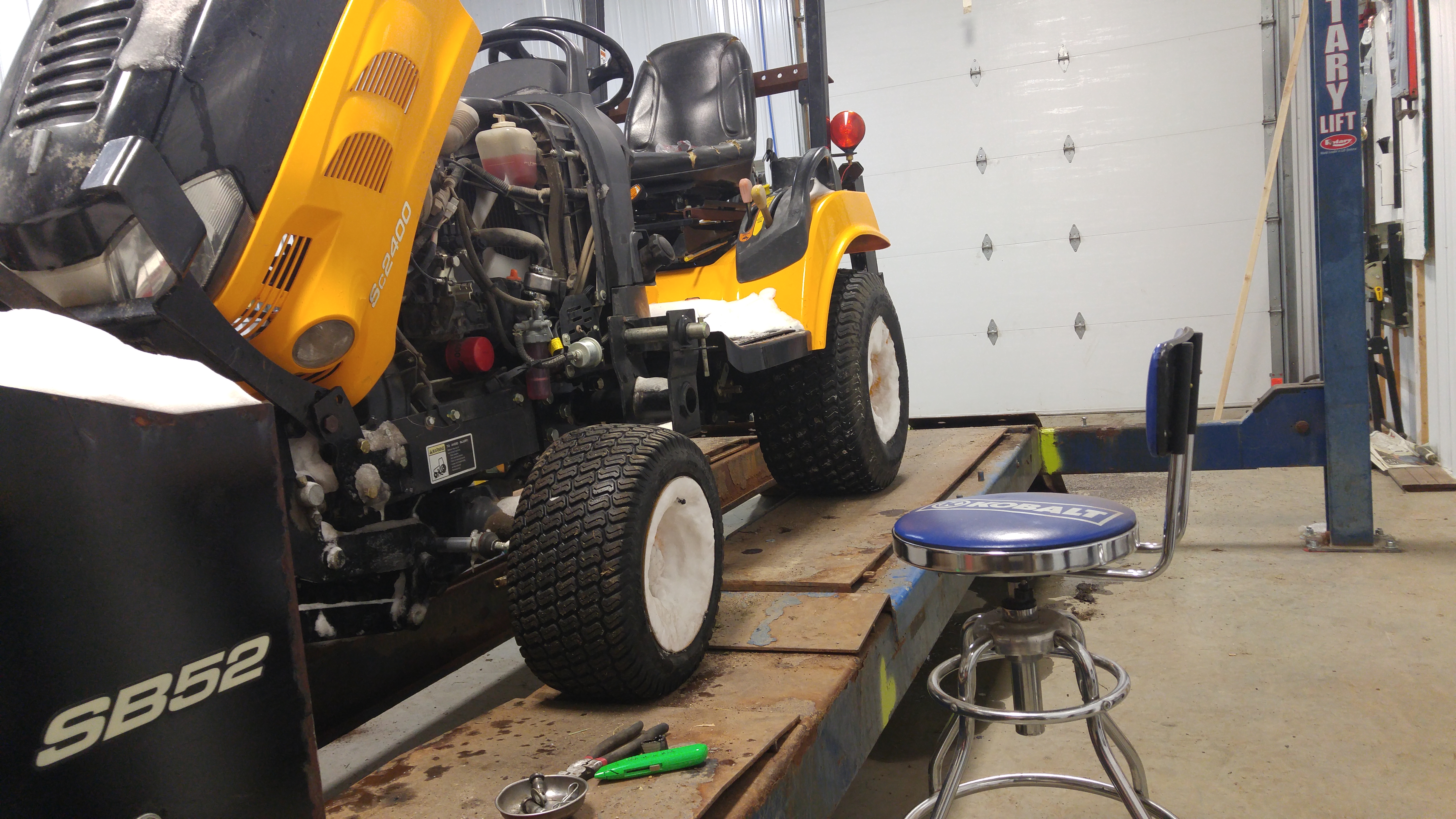

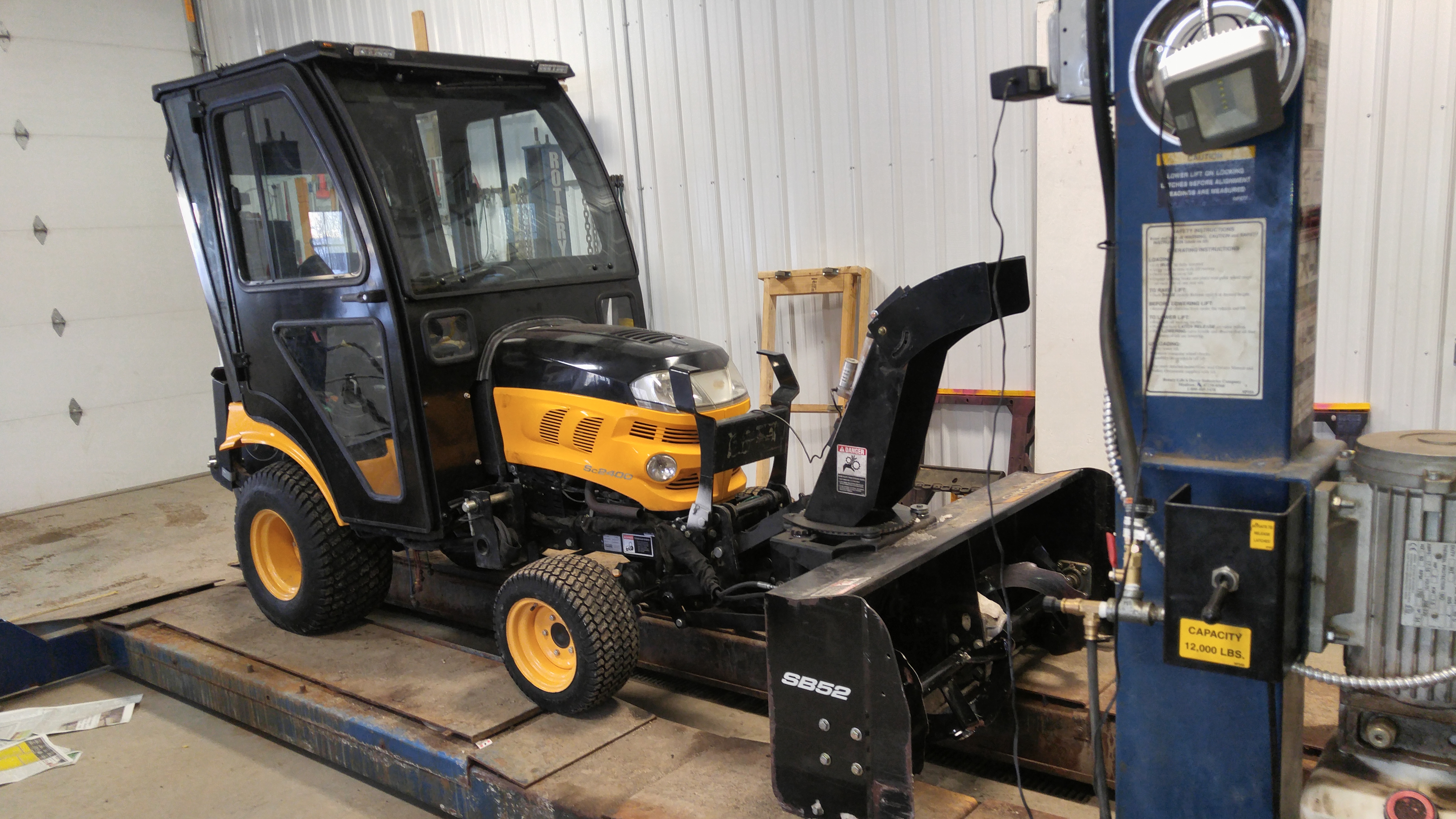

Ended up moving this year, so had to set up a new shop.
Bought this 14000 lbs hoist to use I am on my 3rd right knee so getting down on the floor isn't bad getting up takes a heavy anything to help me up. LOL

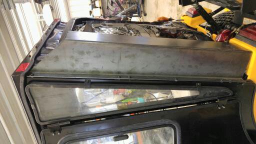

Also putting a cab on the SC2400 built a new back for it still a work in progress, Curtis can take the soft back and wad it up put it anywhere but on my tractor LOL Now if any of you are looking for a vinyl replacement back let me know it will go away cheap.

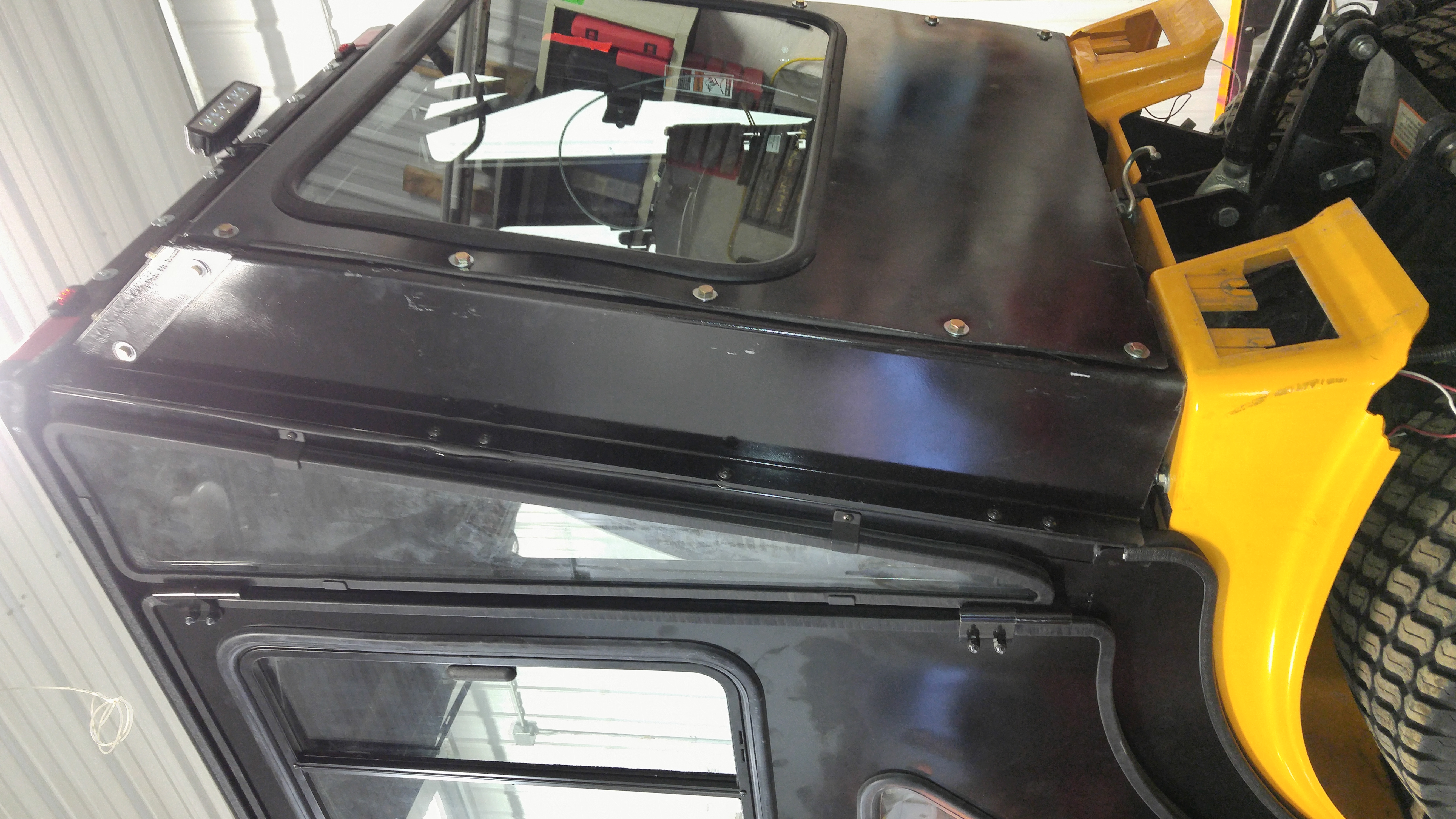

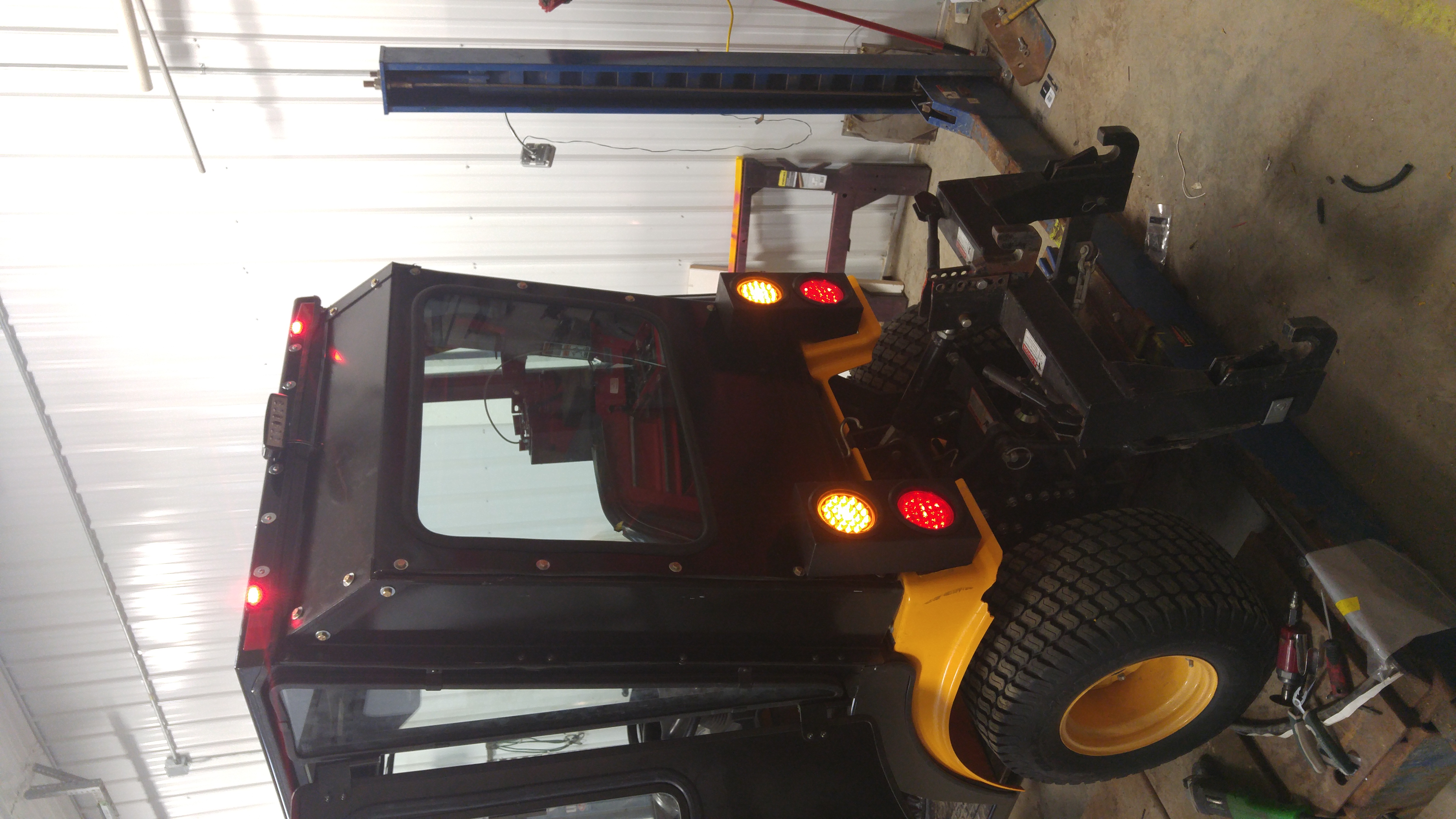

There is something to be said about lifting your work up to the right height

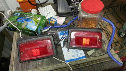

Also you can see the original tail lights one was broken or is broken but they both light
as fast as I can seem to take em off on a show bank anybody looking for a pair send me a pm you pay the freight and a 6 pack they are yours.

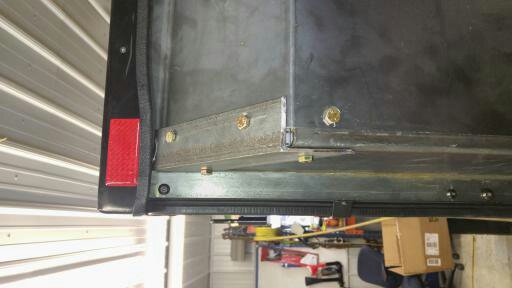

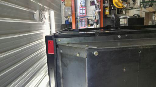

the back extensions on the cab are made from drop as my SIL calls it. He runs a lazer cutting shop and anything cut out of a piece is drop through in a bin and sold back as scrap so it was really cheap
will send more on lights and heater etc later
I had a cab from the factory on my first one hated it was all wimpy flexed a lot so this one has been reinforced and modified. No Curtis 8000 btu heater in it ordered one from Jegs a 40000 btu unit have only blown snow once now since I have it mostly on, still have gaps 1/2 " around the bottom in places but it was t-shirt and tennis shoes at -19 so I think its enough heater. more to follow in a couple days if any interest. putting those steel boxes with recessed Led's in to replace the yanmar lights they should show up.

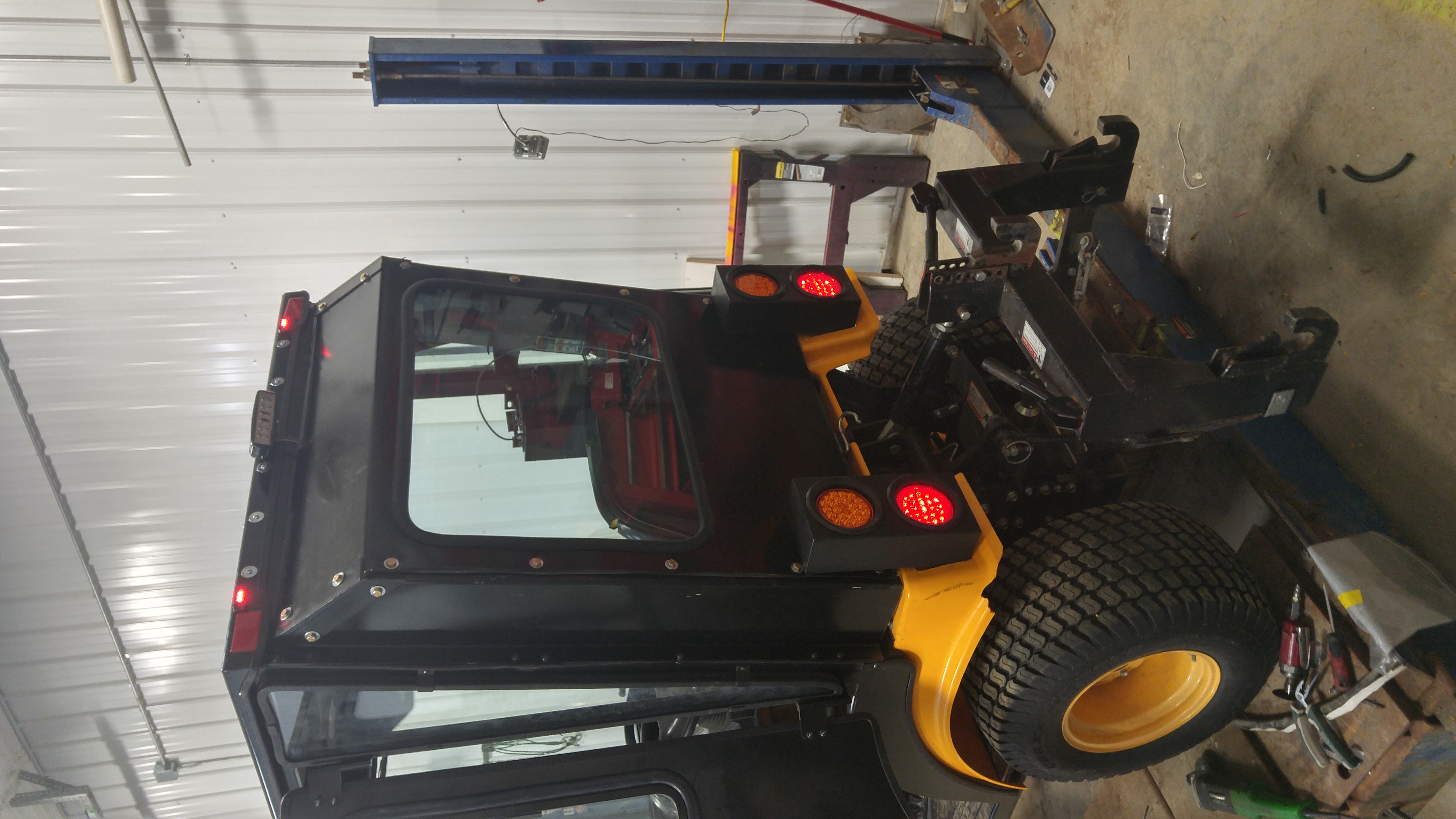

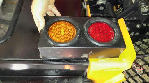

I really need to take more pics. these are the back lights in the boxes when mounted attached with brackets welded to go in and attach at back bolts of roll cage just got bolts a bit longer took them out and this way if I decide to pull the cab for the summer the lights stay on.
the only big problem is if I leave the quick hitch on it blocks about 60% of the lights but they are bright enough they show up anyway.
