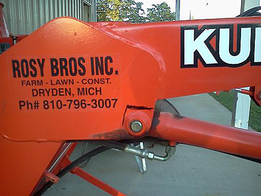

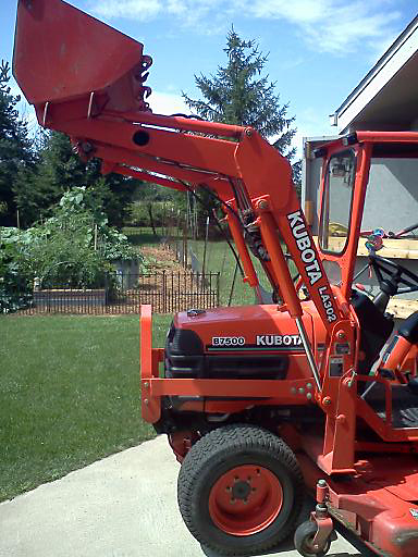

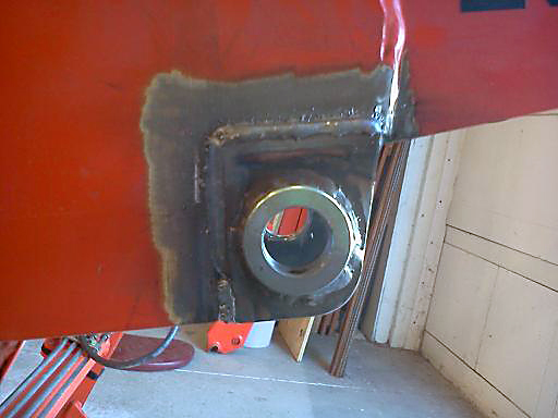

I've had a leakdown issue with the lift cylinders on my loader for some time and had been procrastinating on rebuilding them. After seeing Mars posting in January with his professional looking videos I was inspired to make a similar upgrade. My curl cylinders worked fine and I was primarily interested in more lifting power. My original cylinders are 1 1/2 inch bore with 1 inch rods. I purchased a couple of cylinders from Surplus Center that are 2 inch bore with 1 1/4 inch rods. They also had a 2 inch longer stroke. My original cylinders used 3/4 inch pins but the replacements had 1 inch tubing so I had to make some modifications to my loader to accommodate them. On the rod end I had to cut the tubing narrower to fit in the frame and simply inserted a 3/4 to 1 inch bushing. The real problem was the cylinder end. The loader frame was too narrow to accept it and I made new tab pieces with 1 inch bores which I welded on the outside of the frame to gain the additional width I needed. As it turned out I miscalculated the retracted length I wanted and ended up grinding off the tubing on the cylinder end and adding a 1 inch spacer. This resulted in the cylinder O.D. not becoming and issue with the frame and I could have used the bushing trick like the rod end. Overall I'm very happy with the result for added lifting power. Yes it's a little slower lifting but in my case I see that as a good thing keeping me out of trouble. And as a bonus with the additional length in stroke I gained 5 3/4 inched in maximum lift. My hat's off to Mars for this one.

I used a Harbor Freight 110 Amp mig welder that I slightly modified to give a stronger, steadier arc. I used .030 solid wire with the Argon/CO2 mix.

Nice work JohnZ! I didn't think of widening the loader frame to accept the bigger cylinders. It is nice the have the extra lift height and capacity. My 420 loader mods are holding up very well and I have put quite a few hours on them. I am sure that you will enjoy yours.
