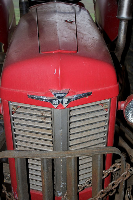

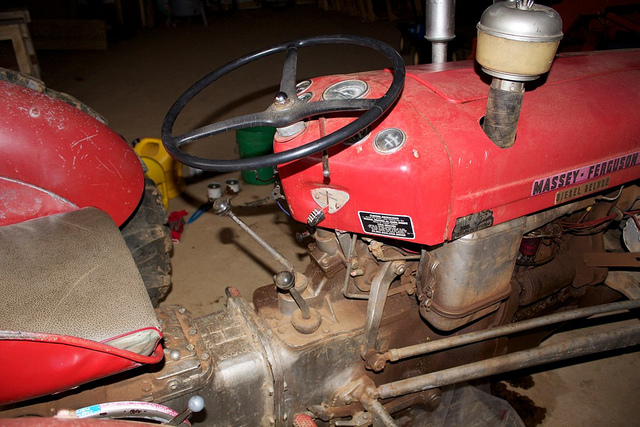

So I joined this forum when I started researching buying this tractor. This tractor was what was in my budget, since I didn't want a monthly payment. Have since purchased it, tweaked a bit, and have been running it pretty hard. And have recently inquired about some issues. This is my first tractor and I'm using it to help me grow vegetables for market. So thought I would just post some pics.

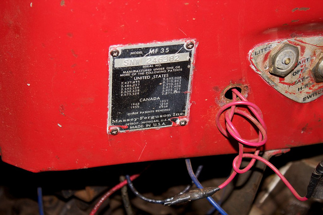

So I thought this was a '64 for some reason but just looked up the serial and it appears to be a '61. It's got Multipower and two stage clutch and live and ground speed PTO control. It's got a Perkins 3cyl, and from the serial I guess we can assume it has the A3.152.
This tractor has surprised me with it's power. I was chisel plowing with the two shanks in the picture. I only got two because they say you should allow around 15 hp per shank. The tractor is purportedly around 38, so I figured go with two shanks not to stress out the 50 year old horse, well I'm pretty certain it could handle another shank. It pulled up a huge rock and flipped up to the surface and barely hesitated, probably 3 foot diameter "boulder." I was trucking along in 3 low too. This tractor is quite beastly for it's size.

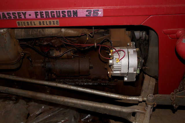

New alternator, a friend helped me wire it up.

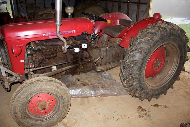

Changed rear tire spacing to 5 foot centers. 3 point hitch tool bar and chisels from Buckeye tractor in Ohio.
