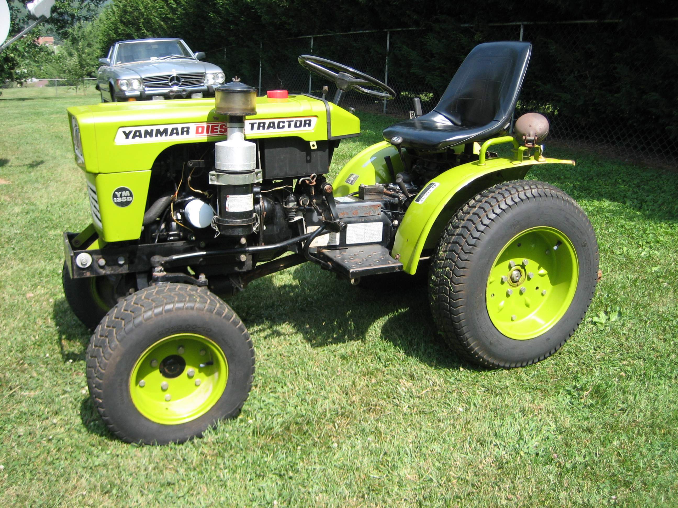

Great to have you here. Im pretty new to the forum but have owned and still own 2 135 yanmars. Presently have a 135d and looking for parts like you. If you decide to get new tires, i might be interested in you old ones.
Here is a photo of my 135d. I have the deck also that was hardly used. I might be getting rid of it also.

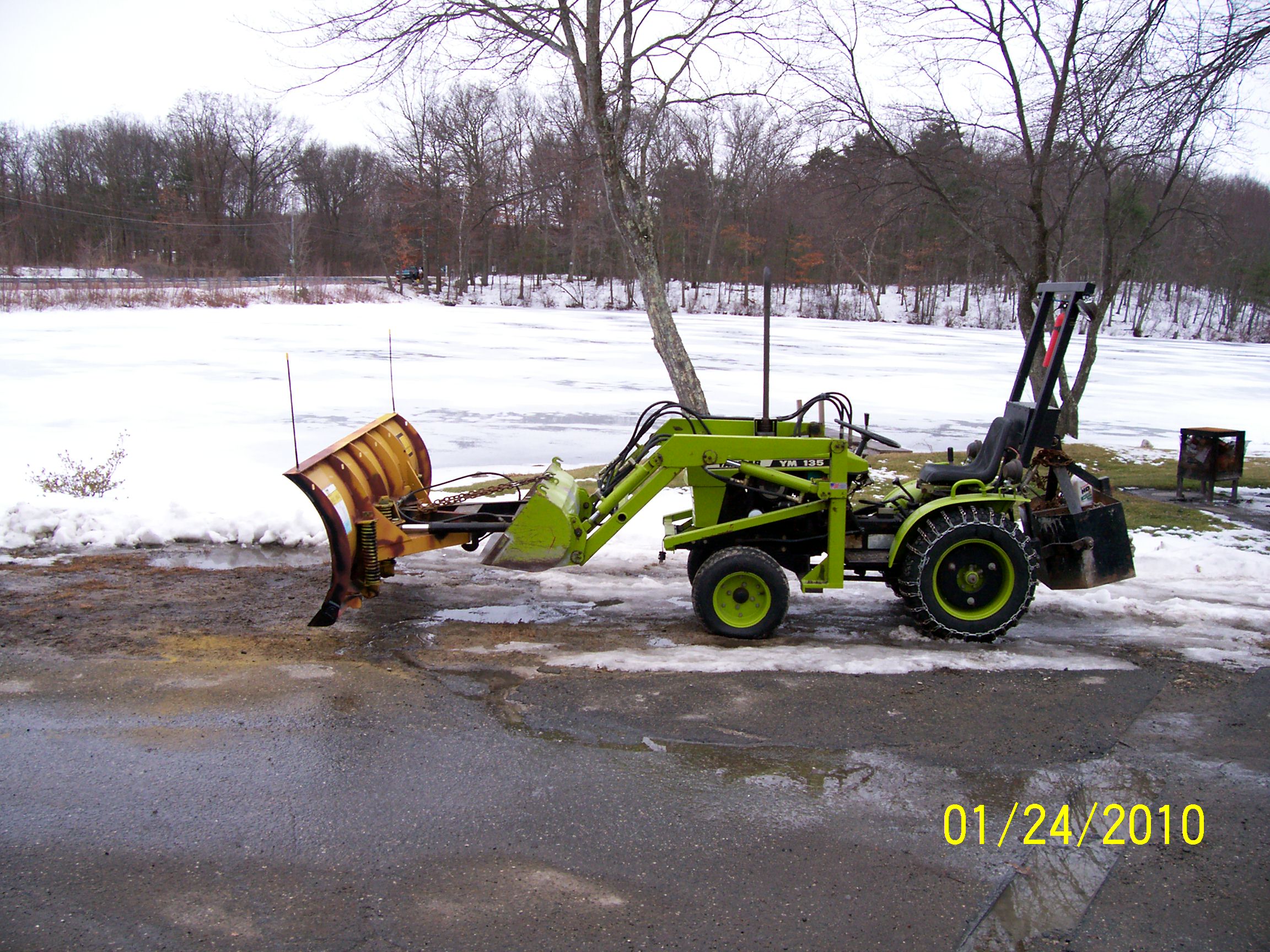

   / My new 135, needing a few things though! #7
They are great little tractors!
Here is a picture of mine.
Wow. What kind of fel is that on the little guy. Also where did you get your chains. Im trying to find a fel or front blade for my 135.
