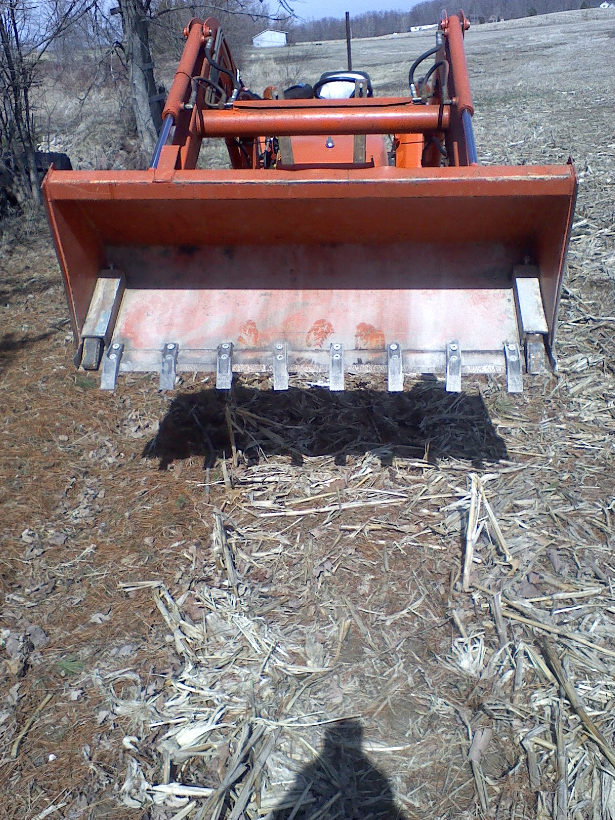

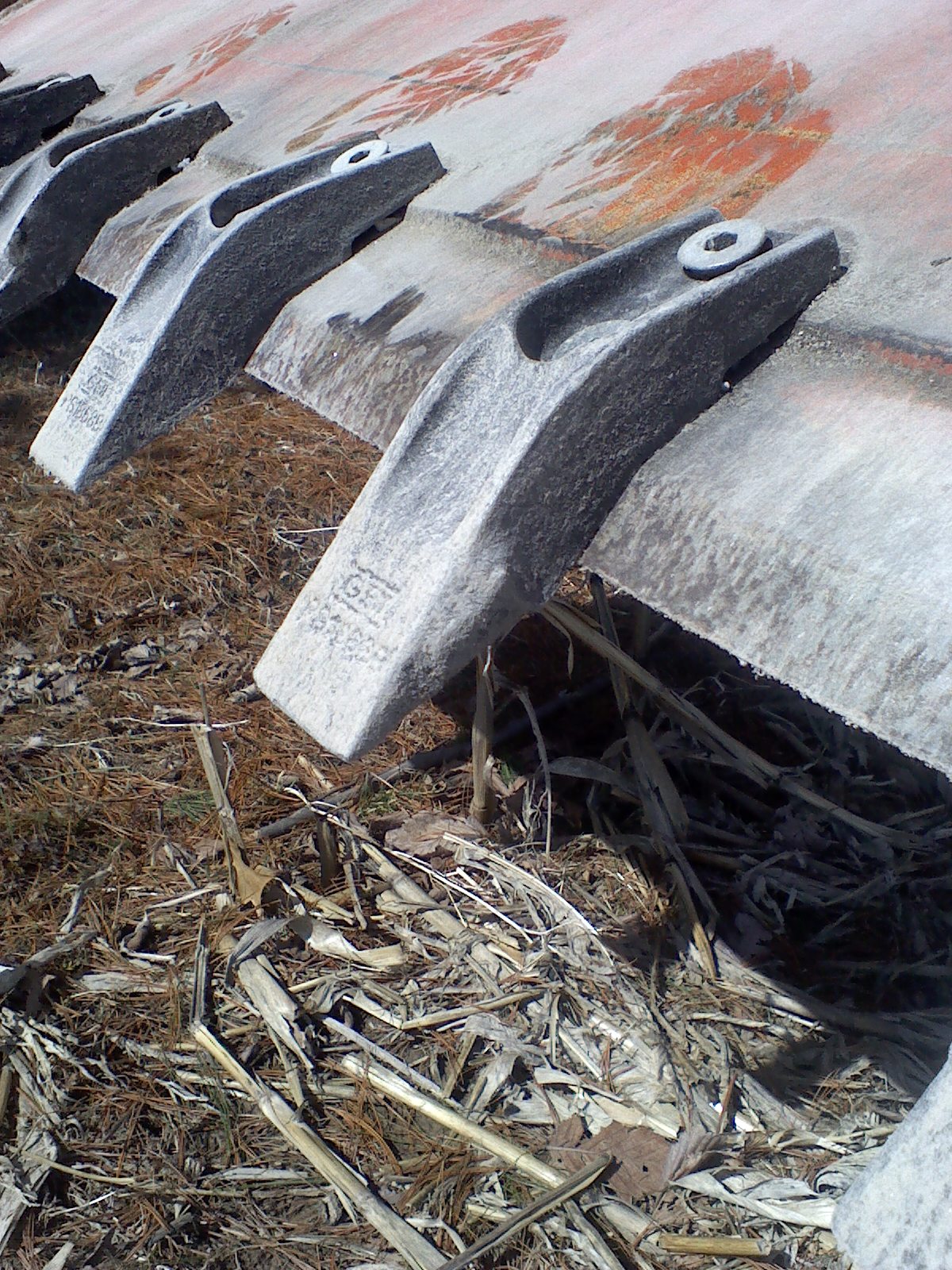

New bucket teeth.
Total cost for 8 of them delivered was $78 and some change.

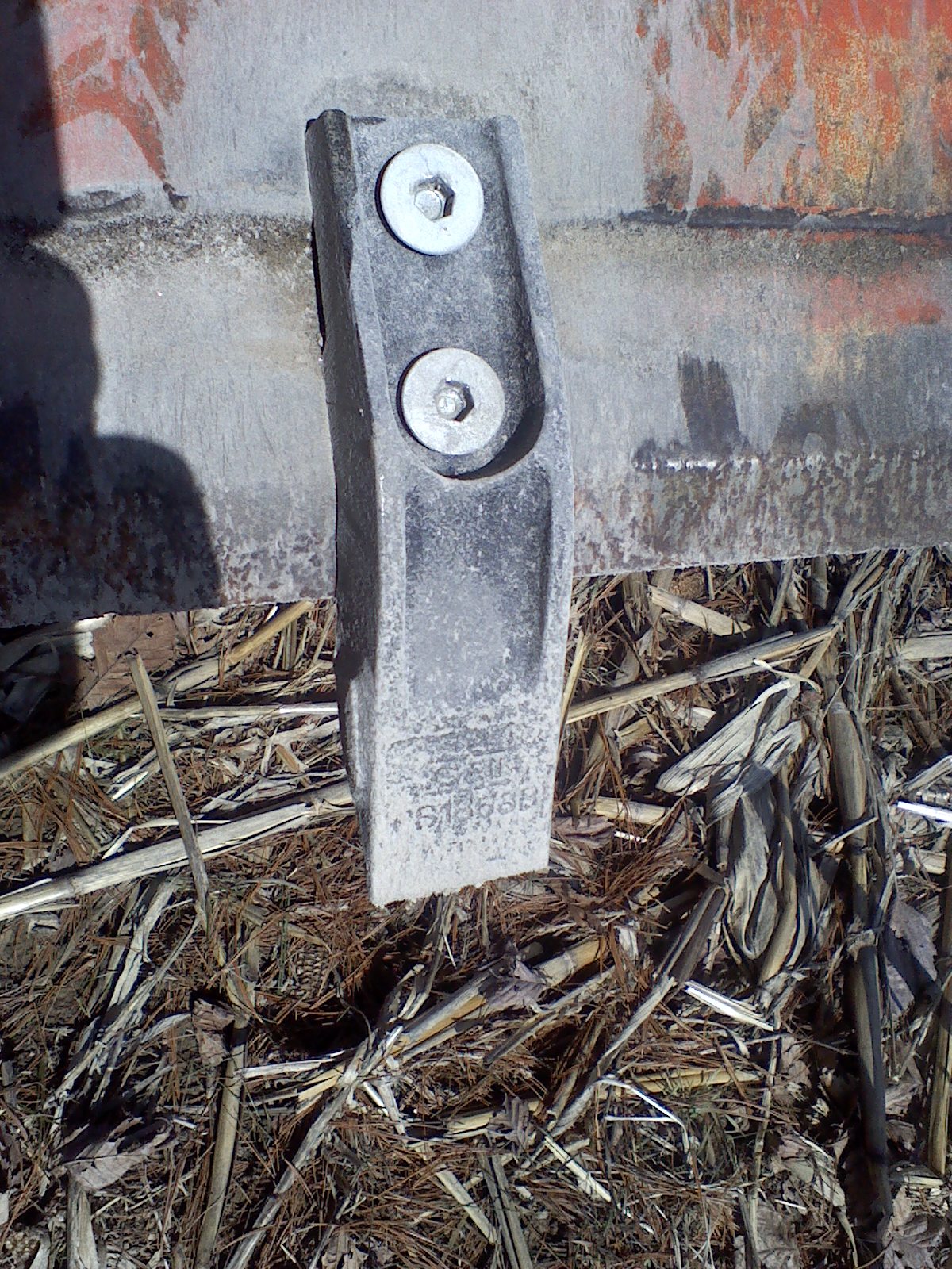

Cutting edge was easy to drill for the front hole.
But the back hole fell right at where the cutting edge was welded to the 1/8 or 3/16 bucket steel. Getting through the bucket steel was easy, but once it hit the cutting edge directly under the weld....it was really hard. Couldn't drill it.
So I had to heat the area up to a dull red with the torches and let it slow cool and ten I could drill and tap them. But trying to drill throught the un-even weld left a few holes off just a tad, that is why the teeth arent perfectally straight. But that won't make it any less effective:thumbsup:
Now I just cant wait to try them out:D

I like what you did. I take it the hardware didn't come with the teeth? What did you use and please report your digging results
   / My new bucket teeth
No the hardware didnt come with. I used 1/2-20 FHCS (flat-head cap screws). Mainly because it is what I had. I was going to countersink them, but as you can see, there is really no need to as they are well recessed anyway. If I ever have to replace bolts and I run out of my stock of the FHCS, I will go to button heads.
I wont know how it digs for a couple of months when dad starts his digging for a basement for a house. But I am sure it will be better than what it was. It also looks like it will be better for pushing brush out of the fields and into piles when we clear fencerows:thumbsup:

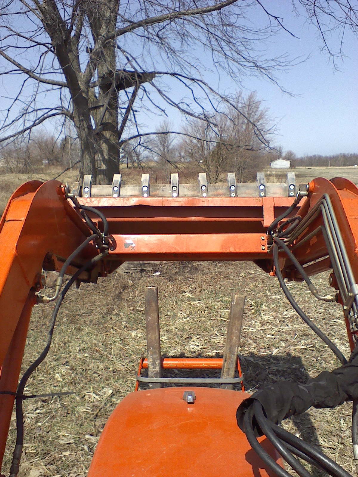

I rarley have a time when I use the bucket to back drag. I use the 3ph blade for anytime I may need to do work like that.
And I decided that for saving ~$250 over the cost of the toothbar, I can live with having to remove 16 bolts instead of two. And in all reality, with the impact, I can have all of the teeth off and 16 shorter bolts back in (to protect the threads in the holes) in all of ~5 minuts if that.
But the big thing for me was NOT blocking my fork pockets in the corners of the bucket. The pictures show the short peices in there to prevent them from packing with dirt. I have longer ones that stick out ~22" for lifting logs and to be sawed up and other things:thumbsup: I would have had to totally redesign it with a tooth bar.

LD...It looks like you can back drag with the teeth on and not leave any toothmarks. Kinda like a flat tooth bar. Is that right?
#19
Thats correct
What did you use to drill the cutting edge? I want to drill through mine to use for a bolt-on edge underneath the original. Step drill?
