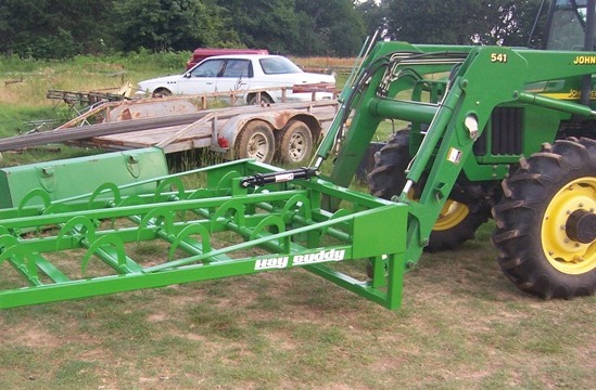

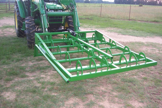

I've been building the 10 bale grapple and accumulators ... I had a customer ask for a compact unit for his 40 hp tractor .... so I made it 14" shorter to bring it closer to the tractor and 7" lower to make it a a low profile unit.
The first unit has the under basket to keep it away from the skid steer while loading and because the tractor FEL's extend further I was able to shorten it.
Thus the same 10 bale capacity, shorter to carry the load closer to the tractor and 250 lbs lighter ... I've been using it on my Little Montana an it works great .... here's a picture.
I'll paint it soon and put my logo's on it .. "Haybuddy GII" I'm waiting to paint it because I trying to break it !!! Fiqure best for me to do that and then I'll know if its customer ready!!!

You understand the concept, your welds look good and best of all you're trying to break it before it leaves the shop with your brand on it. good job.

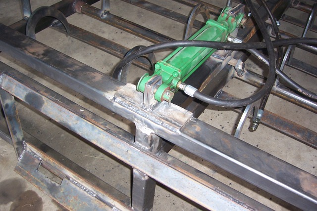

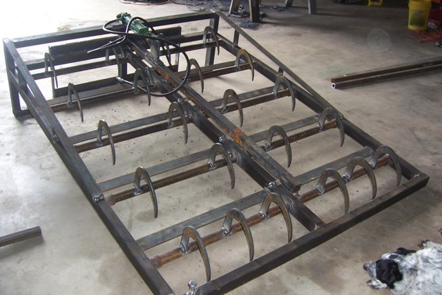

Thank you ... this back woods shop needs more tools!! My biggest issue is the side and middle bars where the pipe ends go into the larger pipe ends ... I have to clamp them down with a 3/4" spacer in the middle before I cut the center holes and weld those in otherwise I get a "bow" ... I thinking about a wire feed welder and a drill press. All holes are cut with the torch.
The grapple pipes need to move freely by hand before assembly ... just a fraction off and they will bind to much ... so if they don't turn by hand they don't get welded !!

Lookin good!
I wonder how the visibility compares having one on a FEL versus a skid steer loader when your driving into the individual bales to accumulate them?
Some of your competitors use square tubing with bolt on tooth hooks and bolt on hubs on the side rails for the tubing to rotate in.
I wonder if that wouldn't be easier and work just as well?
How would you get yours apart, other than a chop saw, if a tube got bent and stuck and needed replacing?
Just questions from the arm chair mechanic, not meant to be critical:)

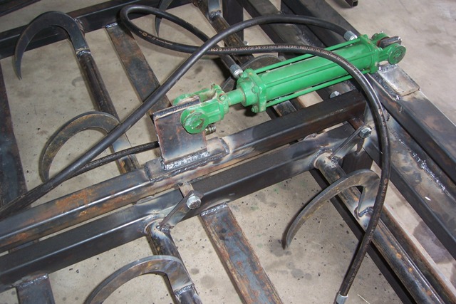

Todd, when I first looked at the grapple, I figured the hyd cylinder was too small, but with the sharp hay hooks, it probably is just fine. As you get down to the last row of hay bales, does that cylinder have to work pretty hard to push all the hooks at once?

All great questions ... I have had mine in use for 3 years and have not been able to bend, bust or twist anything. The bolt on hooks are cast iron and I worried about breaking them ... these 3/8" hooks if they do somehow get bent a 3 lb hammer moves them back into place ... you are right if something does go wrong a saw and a welder to make the repairs ... as for visability the grapple and the accumulator are being used on FEL's and visabilty is great probably even better on a skid steer.

Jim the cylinder is a 2x10 and the ease of bale entry puts no stress on the cylinder or the hydraulics on the tractor.

Painted, Logo's and cylinder on ... shipped out this morning to Arkansas.
