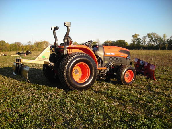

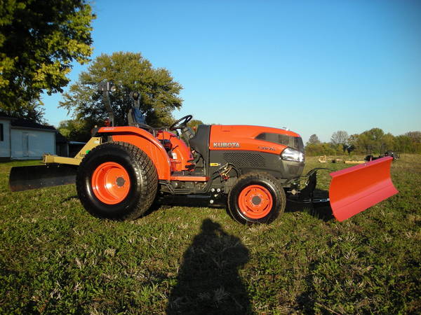

Finally got my L3940 all pimped out and ready for winter. Have owned it for 6 weeks now. It is a HST model with the beefier R3 tires, quick hitch, and 84" front snow blade. Also mounted is an 84" Land Pride rear blade that was used on my 1950 8N, which I still have. I also added work lights front and rear, and a 7 way RV plug. After various chores with the L3940, bush hogging, mowing, and others, I am spoiled with it's capabilities.

Nice! You are going to have fun this winter.
   / My new L3940 with front blade #3
Looks like you'll be plowing snow coming AND going ! The poor snow isn't going to have a chance. ;)
   / My new L3940 with front blade #4
Congrats on the new tractor!!!
That tractor is gonna have an easy life, even Armorall'd the tires!! ;)
   / My new L3940 with front blade #5
Nice tractor, Philip. You don't see many compact tractors with the dedicated front blade. I almost bought one for my previous tractor, a Ford 1920, and it had a stout frame that hooked to the tractor's frame in several places-maybe even the rear axle. Is yours like that? Are you going to get chains for those turf tires? Last question-when you added a 7 pin trailer connector, did you hook up a wire for trailer brakes?

Why didn't ya get AG tires?

The sub frame connects with two large pins in the front, two large pins in the mid section, and through the draw bar (using its own pin). Remove 5 pins, a few other steps, and in just under 10 minutes you can back away from the entire assembly. You can also pull two pins and just disconnect the front blade. I do not plan to add chains to the turf tires, I figure if I can move the snow ahead of me, I wont need them. These turf tires are very aggressive, 3/4" deep tread on the rear with lots of sipping. I think they will do well, I will find out. The 7 pin has running, left turn, right turn, ground, and brake charge pins hooked up. I thought about adding a potentiometer or push button switch for electric brakes, but decided against it for now. Philip.

Main duties of this tractor will be finish mow and move snow. R1 tires are, especially on the front when turning, tear up the grass. The turf tires I have are very agressive, 3/4" deep lugs on the back with lots of siping. I think this will be a good compromise. I have R1's on my 8N, plus chains as required, so I will have somewhat comparable experience here. Philip.
