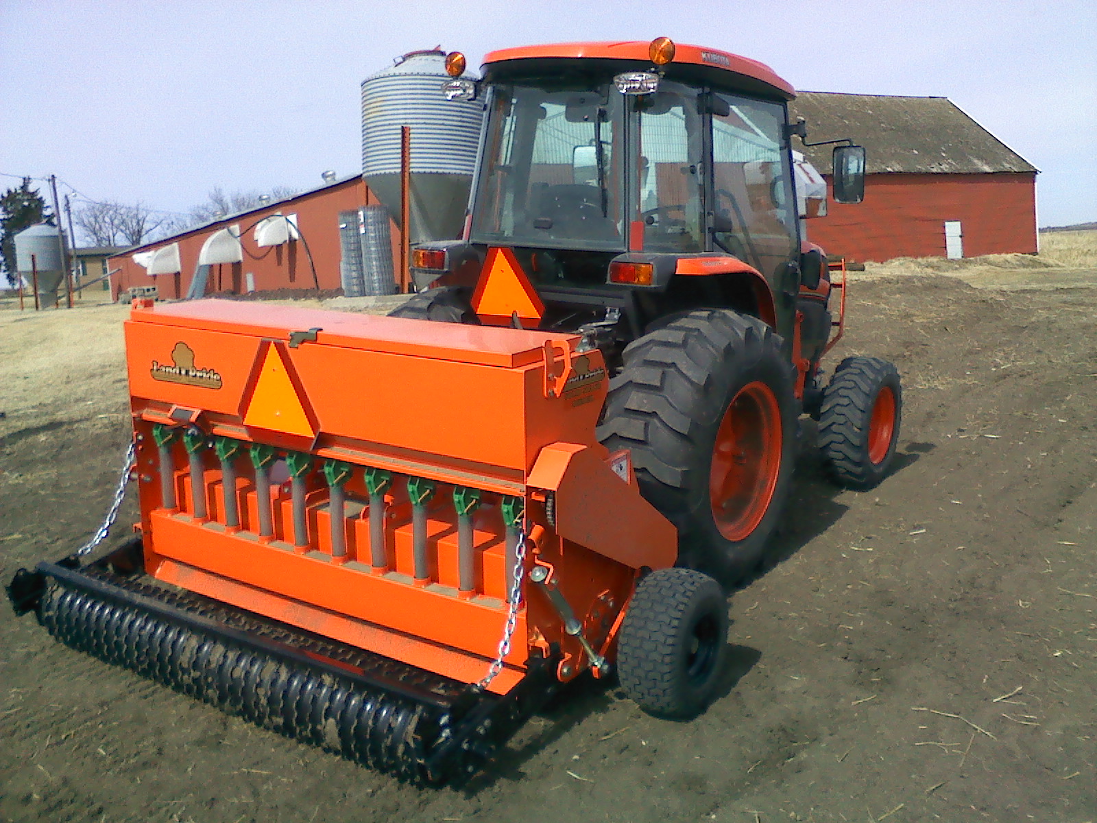

Show and tell, I bought as new OS1572 with guage wheel drive. This will seed many yards and lawns with fesque but I also intend to make this thing seed brome and other seeds that I get asked many times to plant during the year.

nice rig! I also appreciate keeping your money local for us Kansas guys by going with Land Pride. Nevermind that their stuff is top notch!

Very very nice :thumbsup:
Can I borrow it? :D

I have a 5 foot wide Befco Greenrite III seeder that is very similar to the Land Pride, that is over 10 years old. It runs off the rear sheep's foot-type roller instead of gauge wheels. It leaves a really nice looking seeded yard when done. I can only imagine that the Land Price does an equally fine job.
A couple of years ago I was thinking about trading up to the Land Pride in a 4 foot model so I could use it with one of my smaller tractors. The price quoted for the implement quickly disabused me of that notion. WOW, has machinery gotten expensive.

I have heard these overseeders have some issues. Please ship it to me without delay so that I can test it for you. Two, maybe three seasons, and I think I can get all the bugs worked out for ya. :D

thats a fine looking seeder.
