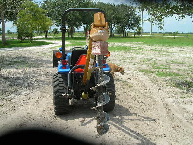

Nothing special about my new post hole digger unless someone happens to be looking for a little basic info.
I bought a Leinbach Model 7400 from Corriher Implements in Newton, NC (they advertise on this forum). It came with a 9" auger and I added a 6" and a 12" auger. The Phd with one auger was $400; the additional augers were $80 and $100, for a total of $580. I happened to be on my way to our cabin in the northwestern corner of NC, so I was able to swing through Newton (near Hickory) and pick them up, saving freight. The also had me sign a statement that I was picking it up for delivery out of state, saving me the NC tax. Florida has a Use Tax, and I'll declare the purchase and pay the Use Tax, Real Soon Now, when I get a round Tuit.

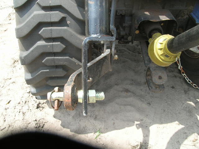

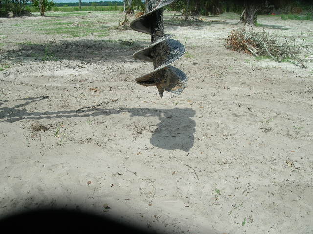

The folks at Corriher assured me it would fit on my TC18, but I don't think they've actually tried it. When I first mounted it, the 3 point hitch would not lift it high enough for the auger to clear the ground (this picture is after I had it modified). We knew it would work because we used a come-along to lift it a bit higher, positioned it where we wanted a hole, and let it down, first with the come-along, then with the 3ph control. But, I had to figure a way to get it higher when lifted. The problem is simply that that TC18 is a small tractor, the wheels are a bit smaller than most, and the 3ph is simply closer to the ground than larger tractors.

Leinbach and others make a special model for compact tractors, but Corriher did not have them, and the other places I found were more expensive and further away.
So, I did some measuring, and found that if I extended the length of the yoke that actually does the lifting by about 4", it would lift the auger with more than enough clearance. I took the yoke to a local fabrication shop, and they removed the factory angles at the bottom of the tube and welded on longer angles, then redrilled the holes for the category 1 pins. The holes are now 4" lower than it was originally, so the back of the boom lifts almost 10" higher.

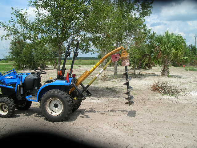

So far, so good, The auger has more than enough clearance, and the boom can be lowered enough to bury the gearbox, so there is no limitation on the depth. Some of the models for compact tractors sacrifice the depth of the hole with a shorter auger in order to fit; I didn't want that compromise if it wasn't necessary. The modification seems to be strong enough, but if I see it bending, I'll take it back and have the sides reinforced.
The modification cost $102.50 including tax, so my total investment is now $682.50 for the phd and 3 augers, still less than other brands/locations.
Florida sand is extremely easy to bore, with no rocks or other impediments, the toughest thing I'll come up against are roots. So, I didn't need the assurance of buying one of the supposedly heavier-duty brands. I haven't heard anyone complaining about the Leinbach units in any conditions, regardless.
We'll use the 6" auger for 4"x4" posts and 3" round fence posts; the 9" auger for 7" - 8" round corner posts, and the 12" auger for landscape planting. My health will not let me dig with a shovel or use a manual phd or wrestle a gas-auger, so this purchase was easily justified.
