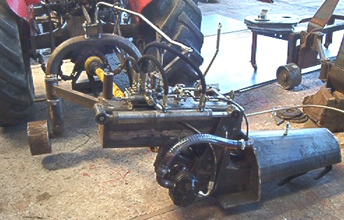

which is under-construction at a blacksmith workshop of a friend. This 3' tiller is sensitive to the trees, or to other obstacles. It automatically shifts to the other side when the curved pipe on the right side of the tiller hits a tree and goes back its original position after it passes the tree. That is, this has a mechanical feedback system. Building the farm implements at home is not a heavy / hard task unless you are a lazy person. Why pay much $$$$ for such simple objects.

Where (what?) is the application for a tiller to till around 'trees'? An orchard? Vineyard?
Normally if a tree plantation, tilling is not done unless the trees are small (less than 1" stem diam at ground). Otherwise, tilling is done where there are no trees that would shade the crop to be planted in the tilled soil.
Curious as to the application. I can see a rotary mower in place of the tiller, where the grass could be mowed up to and around a tree.
Really like to see some pics of a field trial. From the pic shown, it looks expensive but looks like it might work.
   / My new Tiller #4
This is common tiller for vineyard/orchad. It tills around trees, to kill grass. This is not garden tiller.
Nomad's have hydrostatic drive, but can be with PTO shaft, too. Congrats!!!
Nomad, Italians made lot of this type machines, even a power harrows on same principle. /forums/images/graemlins/wink.gif
