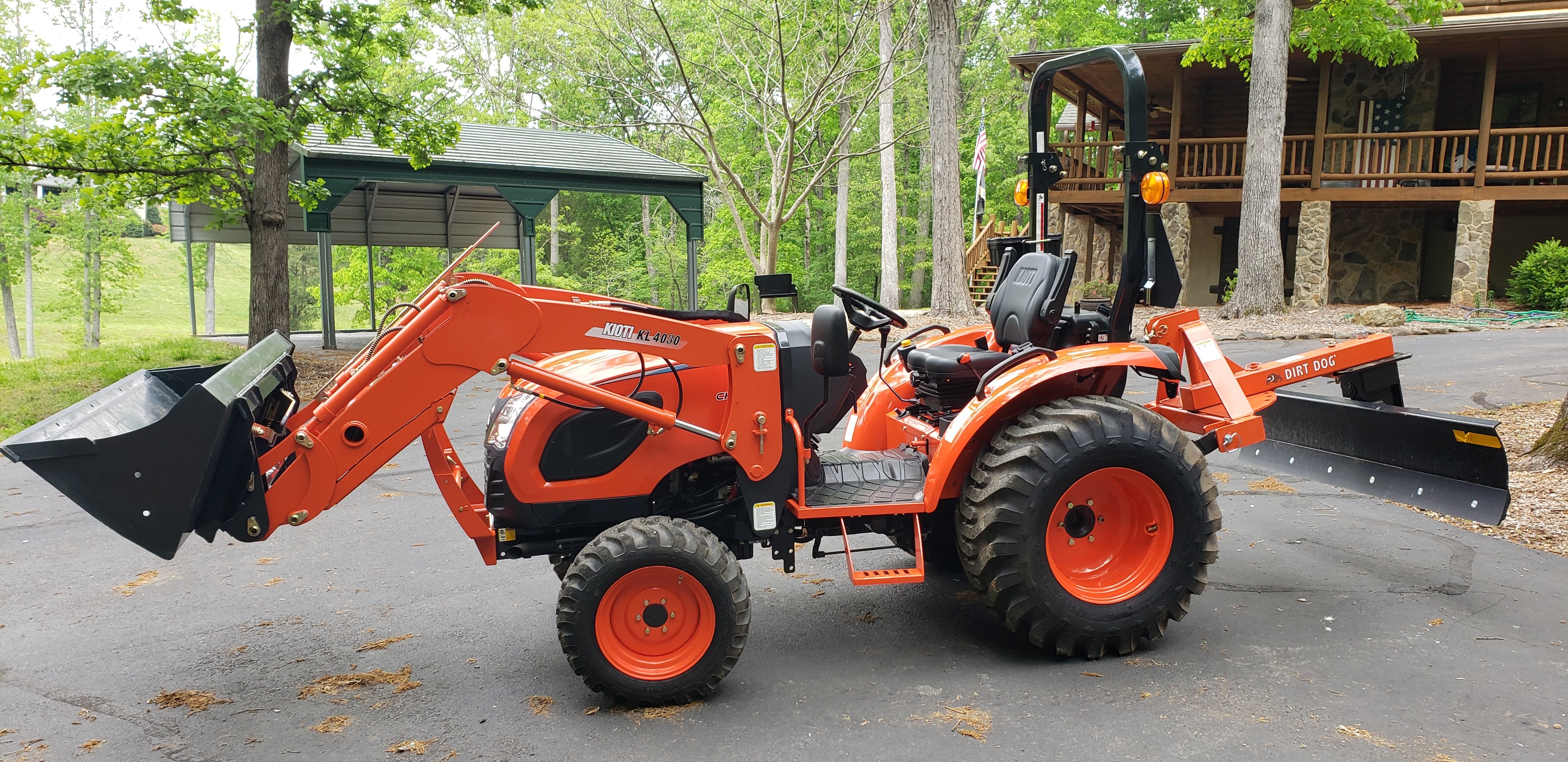

After a few months of research and watching for deals I took delivery of a used CK3510SE HST today and I would like to know if there is anything I should check over or maintenance that I should do to it before I start to use it. The tractor is 1 year old and has 11.5 hours on it.
Now its time to buy implements. If anyone has suggestions on a grapple (and 3rd function kit) and rotary cutter please let me know.

Forgot the picture.

Oh right, things to check:
Loader and wheel bolts - re-torque to spec (edit: don't loosen and re-torque, just set your torque wrench and check if they are still tight enough). Hopefully none are loose, but it can happen.
I would find every grease point and inspect/clean/grease.
Check hydraulic and engine lube oil levels/condition. Coolant too.
Might as well put some wax on it now too, if the body panels and big frame areas are still clean enough!

That looks just like the one I got last week.
Kioti has a 3rd function kit for these tractors. Or you could have hoses made to run from one of the rear remotes to the loader bucket.
Crawl under the tractor with a flash light & look around. Also open the hood & look around.
I leveled the loader bucket & then cut the bucket level indicator off even with the top of the guide tube.

Congratulations. I agree check books for tightness. Also check out hydraulic hose connections to make sure they're tight onto the fitting and that the fitting is tight onto the cylinder.
I recently had my dealer install a Kioti 3rd function kit into my CK2610 and it looks great.
I ordered an Everything Attachments Wicked root grapple and an waiting for it to arrive. From all the positive reviews for EA products on this site they're the best.

I am looking at EA attachments for the grapple. I just realized I am right down the road about 20 minutes from them.
   / My New (to me) CK3510 SE HST
Can anyone tell me what type of tires I have from the picture that I posted? The seller told me there were R1, but I am not sure. I was hoping for R4.
