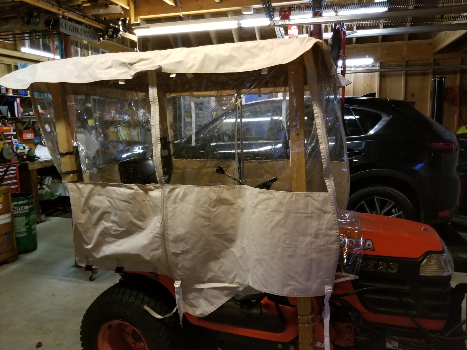

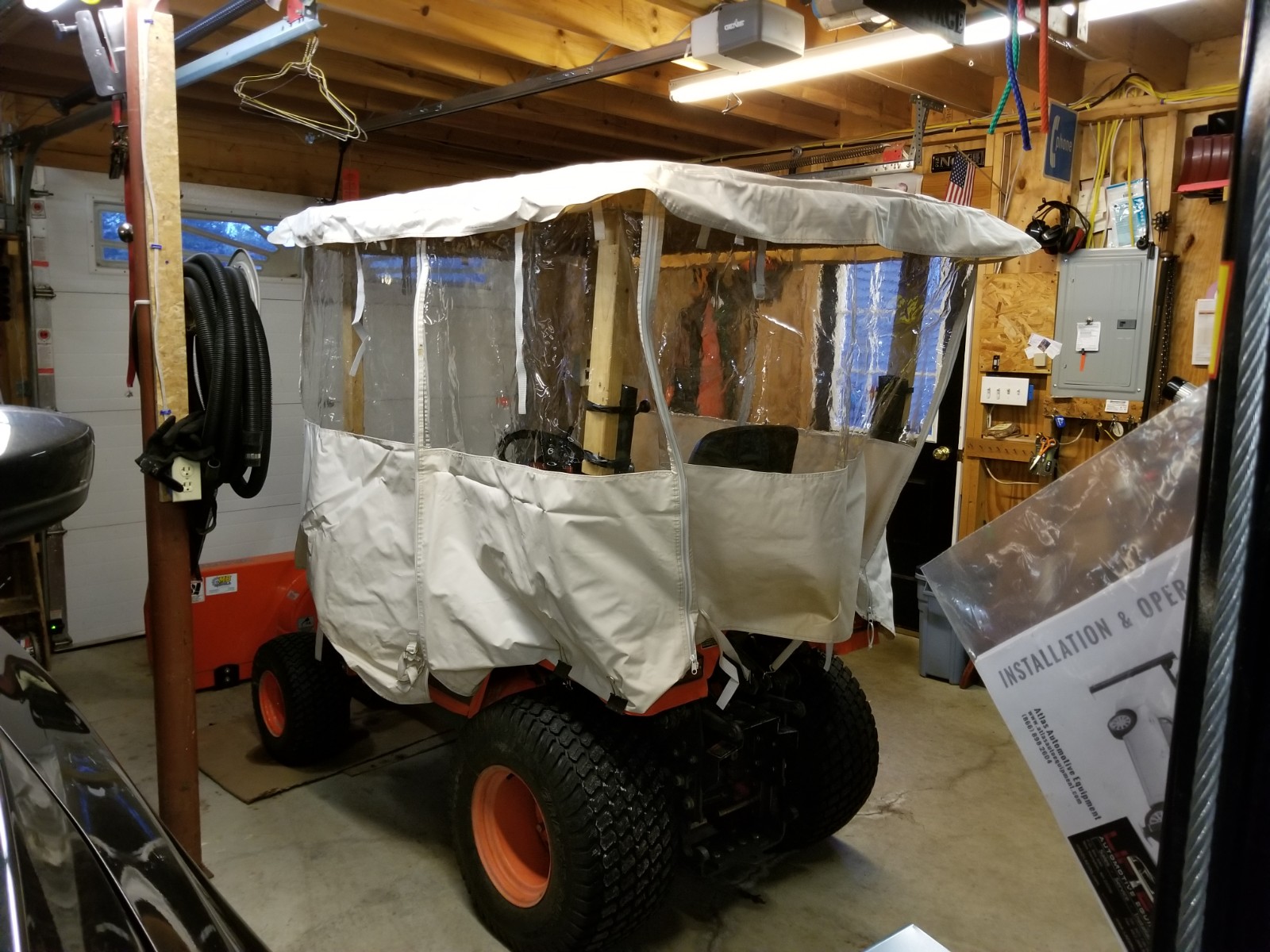

This is what I did 5 or so years ago.
Cut a piece of plywood the same size as the golf cart cover plastic roof, some 2X3's hose clamped to the ROPS bars and then to the supports for the front end loader and slipped the golf cart cover. Maybe $100 in for the whole thing. Take it on & off every year for the white (snow) months!
   / My own PVC & Golf Cart Cover Cab JD 3033r #5
Tks BugsRLB! I have been looking at getting a a covermytractor cover for a couple years and keep balking at the price. Thinking of going cheap and your way seems to work.
