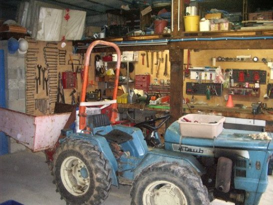

Here is a picture showig what a nice workbench area we have.
I think our tractors must be okay becasue my hsuband leaves the rotottiller ont he back of the big tractor, the Goldini and it is raised and it never bleeds down. The same thing on the blue Staub tractor. Taht little wagon on the 3PH just stays up and doesn't go down, because of hydrolics. I learned about bleed down on this forume, thanks guys /forums/images/graemlins/cool.gif
