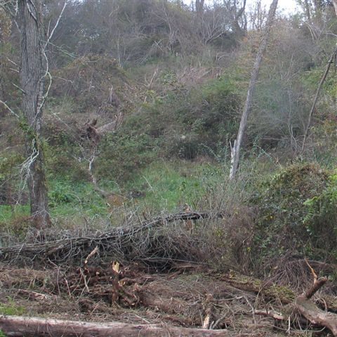

Had it clear prior to Hurricane Katrina, 5 of my 9 acres. I've managed to clear the acre around the house, but now it's time to start on the mess in the backyard. It goes for about a 1000 ft up the hill with a couple of dozen trees scattered on the ground. It's gonna be a lot of fun clearing it with my MF135.:D

Be Careful - Especially if those trees are laying across one another, or if you have leaners. There can be lots of unsprung energy just waiting to be released.
I am still cleaning up many trees on my property from the mess Ivan created 2 years ago. It's a lot of work but steady as she goes will eventually get er done. Make safety your first priority.
Good Luck!

What's the plan? That low green stuff looks like Privet. Are you going to try to mow it? A 135 and a 285 Bushhog will handle that, but you better be ready to keep it cut back for a couple of years or hit it with herbicide everytime it sprouts.
I have a big problem with invasives, notably Kudzu, Privet, and Chinaberry. Blown down trees just makes it more exciting to try to get in there and handle it.
Like 1bush2hog said, be real careful.
   / My project: Reclear 4 acres
Where in GA are you redlevel? My brother lives just outside of Cordele is why I ask. You've got a good eye, it's mostly privet with some sumac and briars thrown in for fun.
My plan is to bushhog as much as I can, then skid the trees that are on the ground out. After that I'm gonna rent a trackhoe or hire a dozer to get the stumps and the trees that are still standing but leaning or with the top broken out. Luckily I had it pretty much cleared before the storm went thru, so all the brush is only about a year old.
