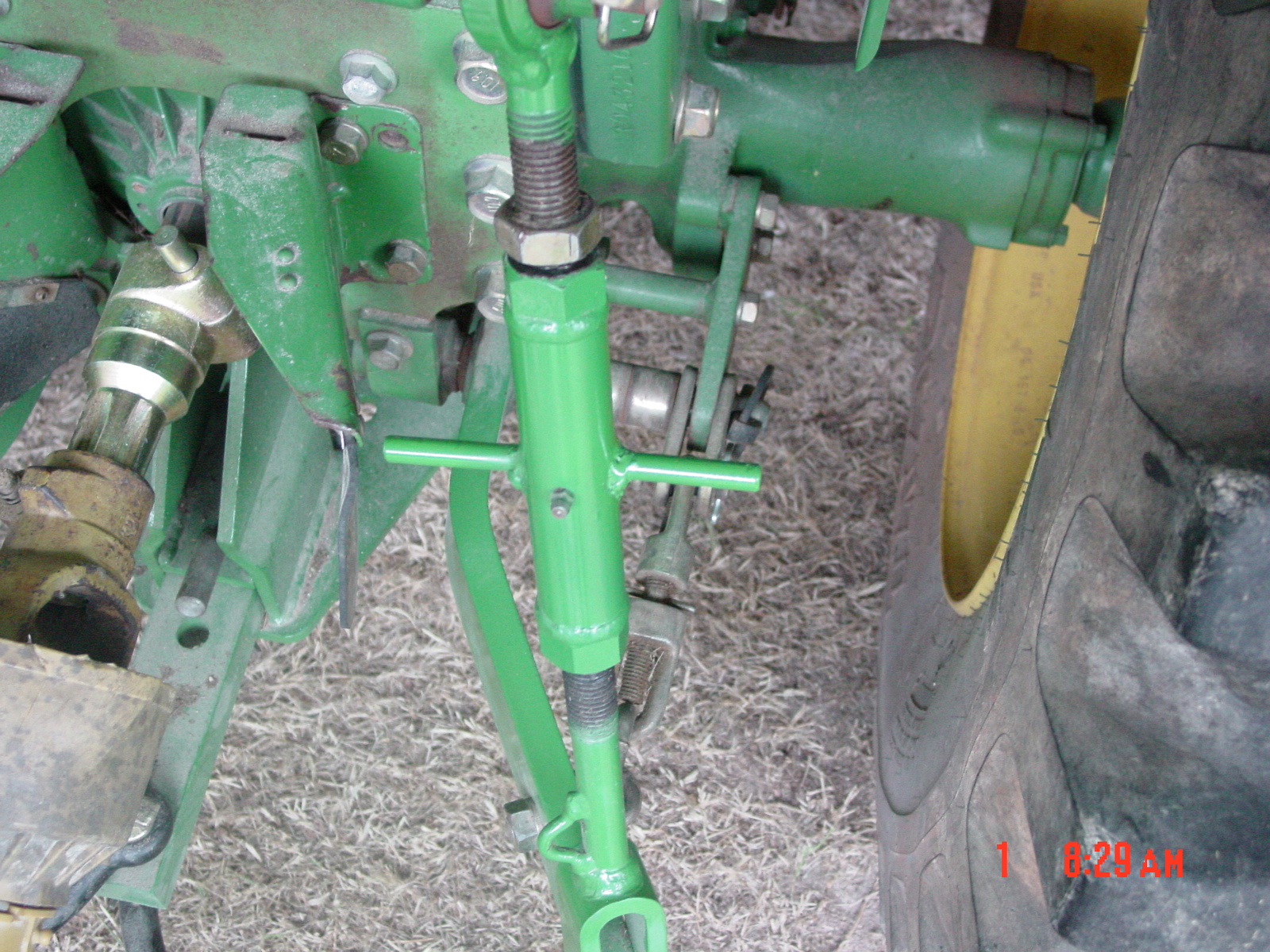

Is it too short or could it be jammed. I'm hooking up a landpride brushmower to a MF 1533 using Pat's Easy Change. The PEC adds about 2 inches length to the lower hitch arms.

Roy's right, the PEC extends the implement about 4 inches more to the rear. You might need an extension like the one I have on my 790. The picture is not the best, you can see the extension I added to the PTO output shaft. I ordered it from agrisupply.com, if you need the link for the exact part number, I think can dig it up for you.
