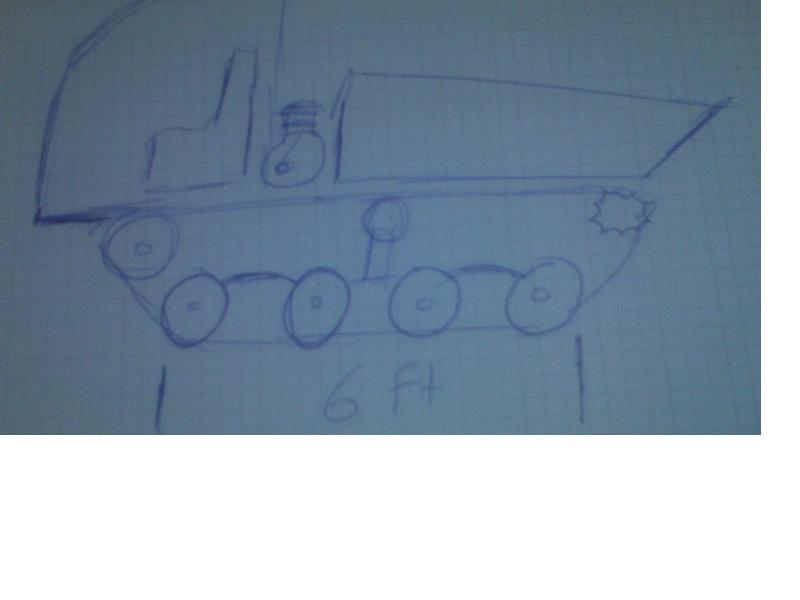

Been waiting a long while for the right tire at the right price to come along. Finally it did and I picked up 20 tires (13.5x5x6). each can support 370 lbs. Each track will have 10 tires. 8 road wheels and 2 tensioning wheels + metal drive wheels powered by hydraulic motors. Each of the 8 road wheels per side will be paired and mounted on upside down trailer leaf springs, two springs per side.
I have now two hydraulic motors, one big pump, a cylinder for a dump bed, my road wheels, four leaf springs. Now I need to source some 4-6" belting, two pieces per side connected with cleats tied together with 3/4 rod to engage the driving gears. Will be two weeks before I start assembly. Looking to haul 1000 lbs of dirt, plow, and tow a X-country ski groomer in the winter. Approx 4 feet by 8 feet?

Sounds like a fun project. What kind of motor are you gonna use?
   / My Ride-on Tracked dumper
I was looking at a 10 HP diesel but now thinking something around 15 hp gas as I don't think the small diesel has a glow plug and I want to use it in the winter as well. Either can be had for around $500. Anyway keeping my eye open for a good deal. Both those engines might be too small for my 10GPM at 2500PSI pump?

Sounds like fun, but I'm a little nervous about those 3/4" rods bending if one side rides up on a stump in the snow. Have you considered 2" channel or similar? Easy to fasten the belting to as well.....
#9
The 3/4 rod will be used to hook into the drive gear. It will be welded to plates that will be bolted to the rubber tracks. Final design not determined, I suppose I could try channel but then I would have to custom built some drive gears to engage the channel. My plan is to double up 3/4 pitch #60 gear wheels on each side to engage the Rod. I can envision 3/4 Rod welded to 2" channel though. This thing will have suspension which I can adjust by adding or removing leaf springs. It should flex somewhat over obstacles and there will likely be a Rod every 4-6 inches with channel for traction and grousers below to keep the track on the wheels. Anyway when the time comes I will look at all options for track, up to and including chain & plate tracks like on the tracked wheel barrow I made a few years ago, though they are less snow friendly and very heavy.

Hello, Im always interested in tracked vehicles. I often thought of making one myself. I have quite a few J5 bombardier tracked machines. Very good machines. I have done hydraulics only a little, but noticed you were wondering about the size of your engine. I believe your engines would be too small for your pump and flow rate. HP needed would be about
Horsepower = (Pressure in PSI x Flowrate in gpm )/1714
so = (2500 x 10gpm)/1714
= 15 hp
And due to inefficiency and such you would probably stall the engine quite a bit when pulling maximum. Use a larger engine, maybe 18 or 20. Or cut your flow or pressure down to compensate for the smaller motor.
