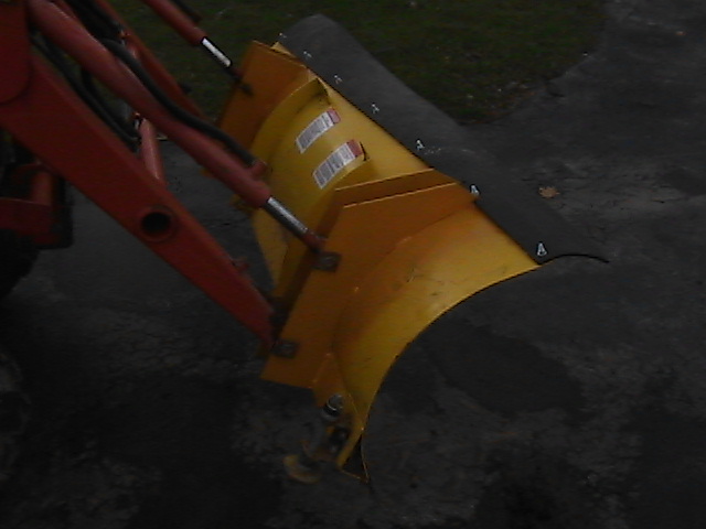

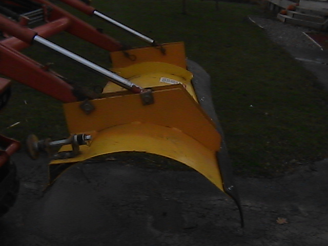

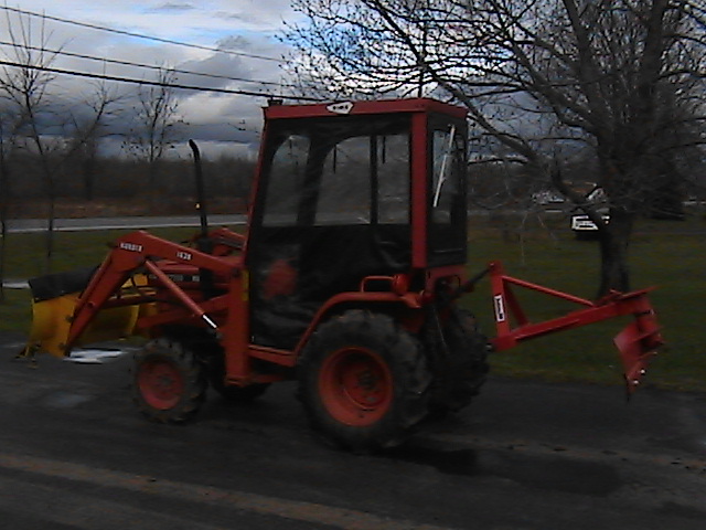

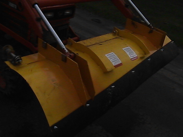

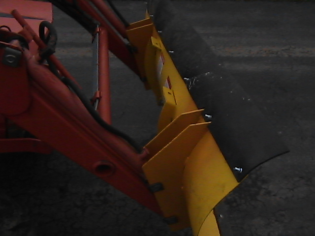

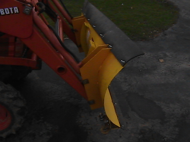

Well it's that time of year again so I thought I would post some pics of my humble B7200 and the front blade I use.
Couldn't spring for the Kubota blade, frame, hydraulics, so I bought this blade @ Gander Mountain, about $240, and welded some new brackets on that I made. The added brackets really strengthened the blade. It does a great job of dozing dirt and gravel, and works well for fine grading. I used it recently to spread and final grade a driveway extension for a friend of mine. About 25 yards of runner-crush.

My drive is 180', paved, and the blade rolls the snow well. I'm off the east end of lake Ontario, and we can see 200" or more of snow a season, with 24-30" overnight. Actually, it does pretty well picking up the snow against the bank and dumping it over the top.

At first I thought about how to mount it to my bucket. Pondered forever. Didn't want clamps that could loosen or slide. Didn't want to stress the bucket or blade by imposing the entire load as a few point loads on the bucket or blade. Maybe I thought about it too much, not an engineer but I am an architect.
So I thought the best way was to attach it to the FEL at the points the loader frame was designed for, and added four more ribs to the plow, thus reinforcing the blade that much more.
Thomas, I agree about the trip springs. I originally was going to have a second set of brackets that fit in between the outer ones. The inner ones would be welded to the blade and the outer attached to the FEL as I have them. They would share a pin at the bottom hole, but the blade bracket would have the trip spring attached to the top hole and then back to the outer brackets. The top hole of the outer brackets would attach to the hydraulics on the FEL.
But I don't plow that fast and my driveway is paved so there's nothing to really hit. But they probably would save my lawn when I push the snow off the drive.
