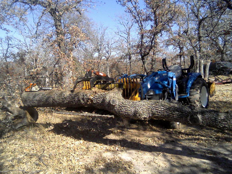

Here is a photo of my bucking stand. This works so slick because I can even cut between the teeth on my rock bucket/grapple. My post oak and blackjack oak trees are perfectly sized for cutting rounds this way before splitting. I learned a lesson in another thread from someone who said to touch up the chain with a file every time you fill with gas/oil. I can easily make a touch-up to each tooth (55 on my 16" saw) and be back to cutting in 5 minutes or less (I think that tip came from LD1...Thanks!). It keeps my saw so sharp that it goes through these hard dry oak trees like butter. This little saw is all I need. I have 3 or 4 other saws that people have given me with not much wrong, including an old McCulloch 110 that I have not used in forever. This Stihl is so good, it rarely needs anything, but the pull rope was the exception.

Geeze, if i tried that with my "tractor" it would nose forward. Looks like just the right height for bucking. Now you need to set up so the pieces fall into a wagon for you to hall back to the wood shed.
