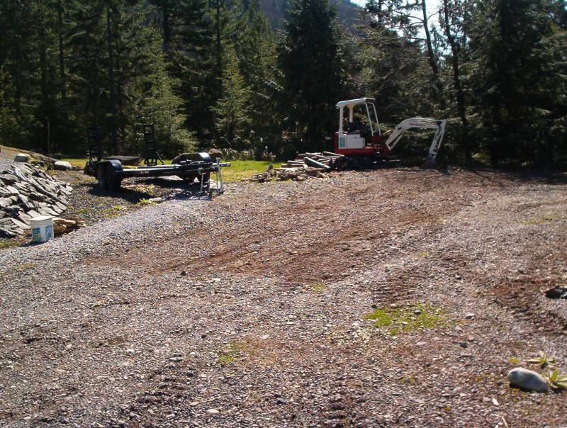

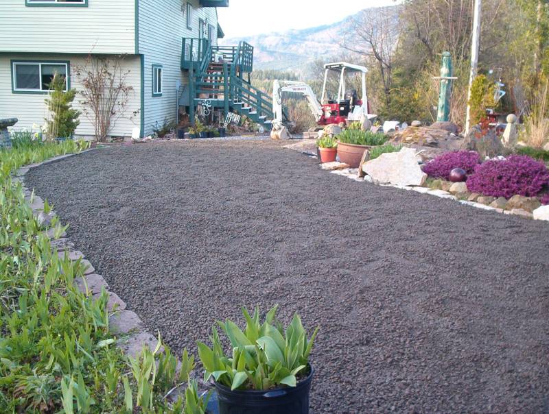

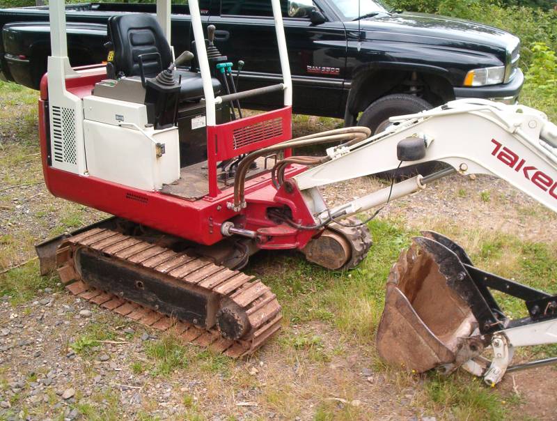

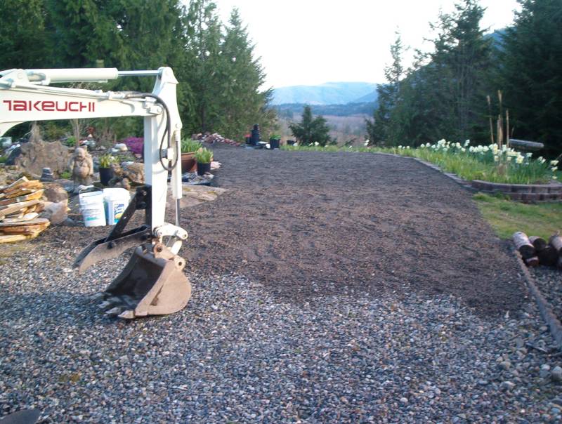

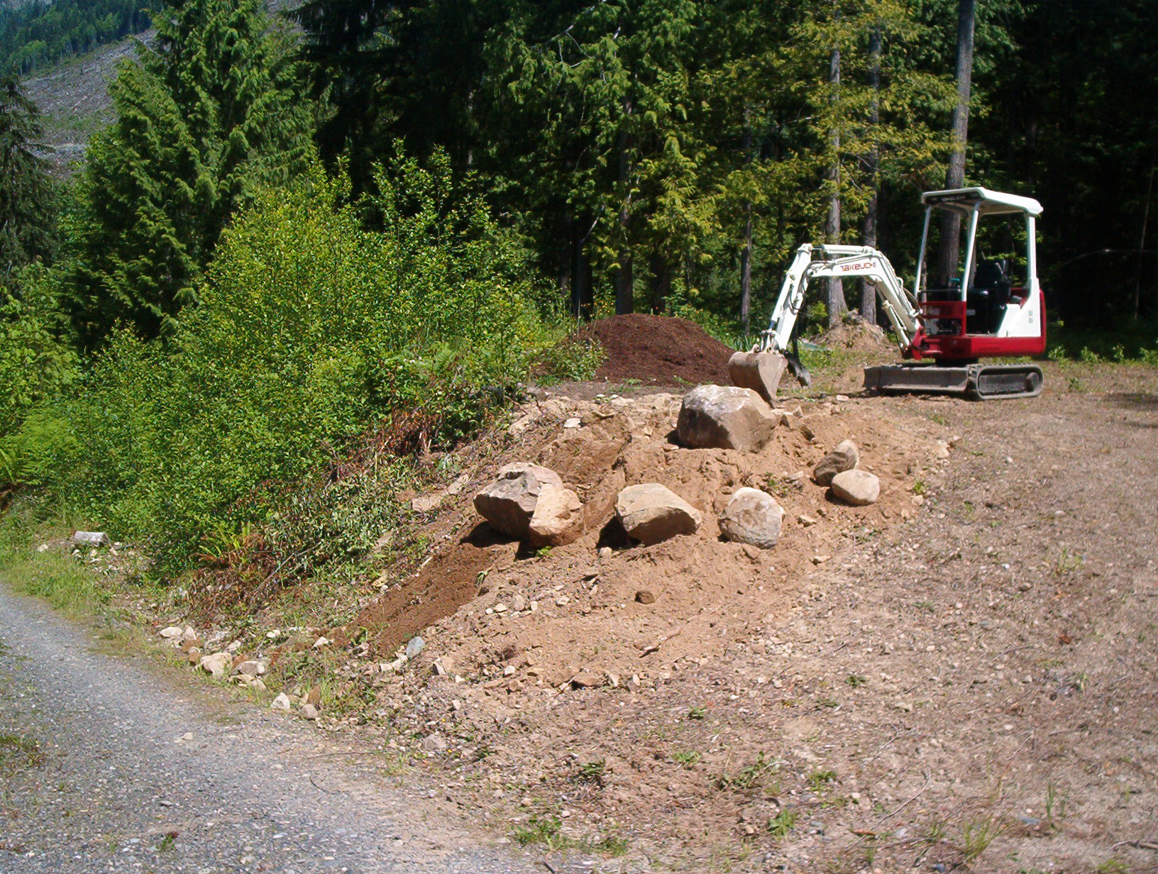

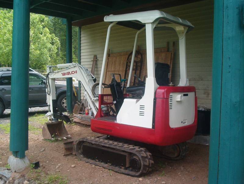

a couple random pics of projects in the works or done. along with a pic after my track fell off and I had to put on the steel track for alittle, lol. Great forum BTW.
