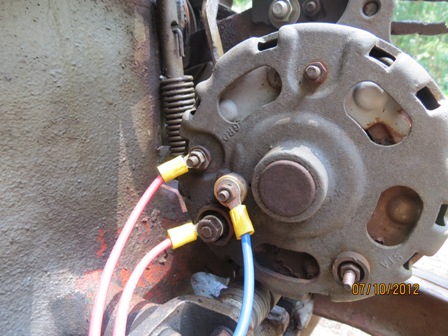

This is a pic of the 12v alternator on my TO30 Z129..it doesn't fit the description I'm getting from some as far as the P1,P2, and BAT connections. What I'm seeing is a BAT, GRD, and FLD..and a STA that never had anything hooked up to it before. I'm quite a newbie and am just trying to wire the alternator the way it was previously..which was...
Alternator GRD - grounded to one of the four bolts on the gear shift starter switch
Alternator BAT - ran it along battery cable to positive battery post
Alternator FLD - to a voltage regulator(Echlin VR32) then out to L on dash ignition switch
This Voltage Regulator has only two connections..one labeled Field on the RH side and one labeled ignition on the LH side
   / My TO30 Z129 12v alternator #2
ok quit trying to figure out wiring diagram your tractor originally came with a delco generator at some time it was converted to the alternator system you are showing in the picture which happens to be a ford 1g externally alternator. and as luck would have it just down the road from you is one of the best alternator repairs shops on the east coast it is called b and h auto electric phone number is 904-269-7052 the owner is bob thomas have known him for over 20 years he can help you sort out what you are trying to fix and by the way the sta hook up means stator tap a part of the chargin sytem he may be there today good luck

My other wiring issues are with my dash ignition which has three terminals with four switches(Two on the B terminal)..This is how it was wired...
L <--- FLD Alternator Post...Thru Voltage Regulator
B <--- Positive side of Ignition Coil
I <--- + Ammeter...Charge side
I have the neg side of the Ammeter(Discharge) wired to the same gear shift starting post the positive battery cable is connected to...with the starter connected to the other gear shift starting post
BAT Alternator post wired to positive battery terminal
