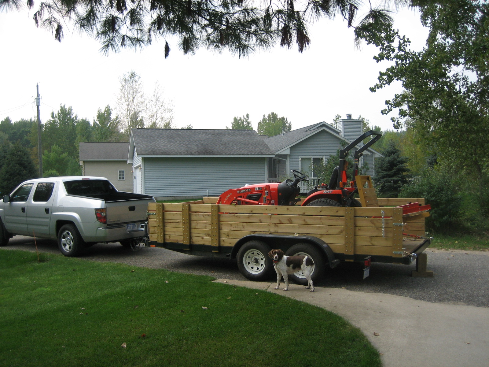

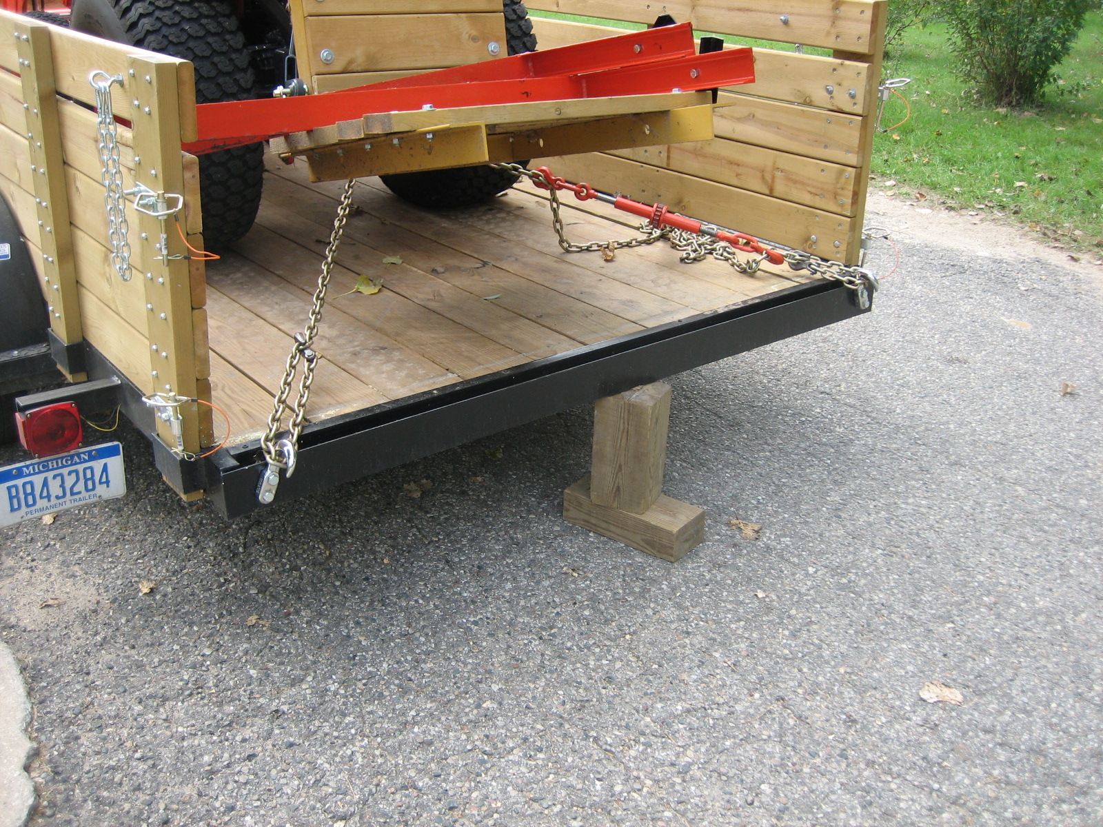

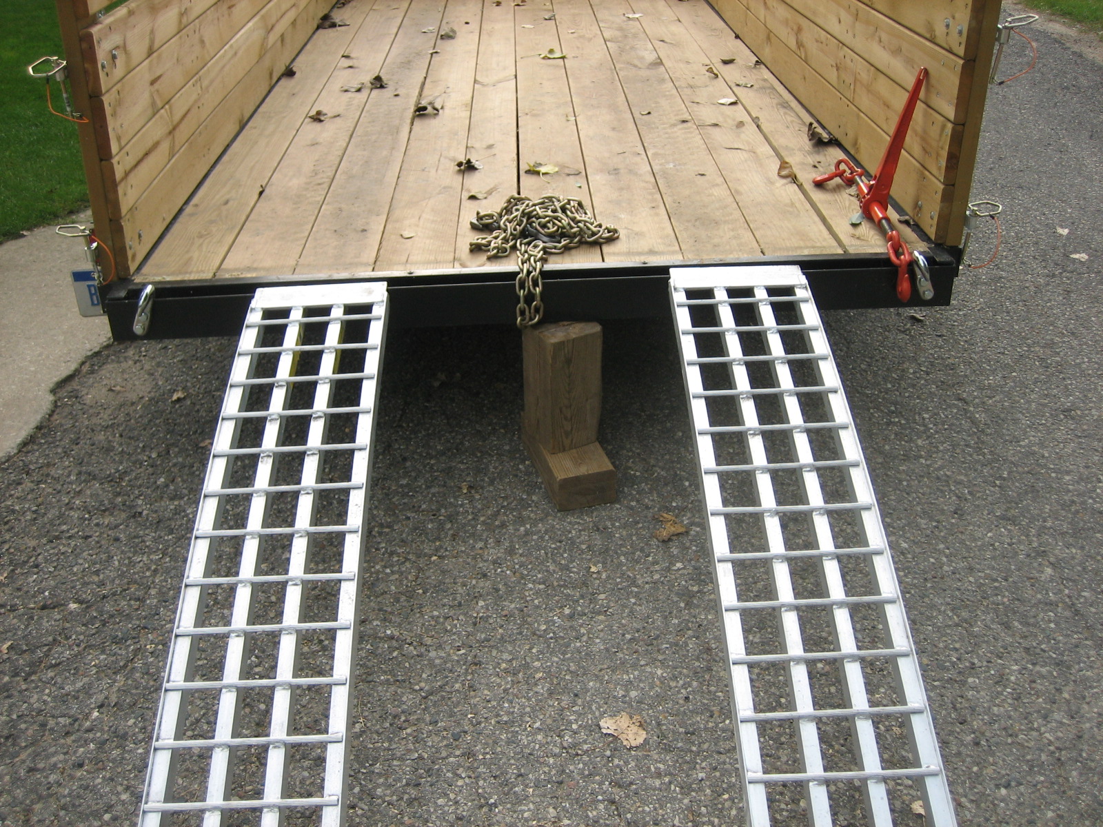

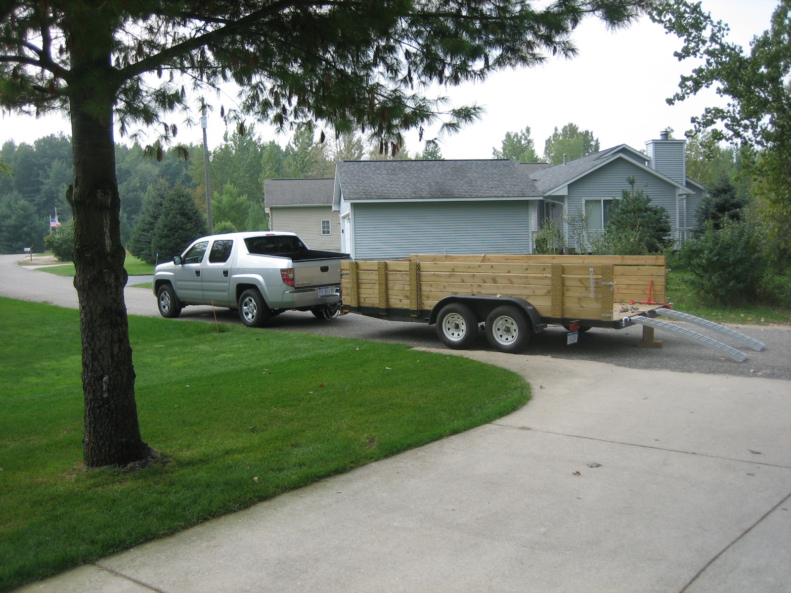

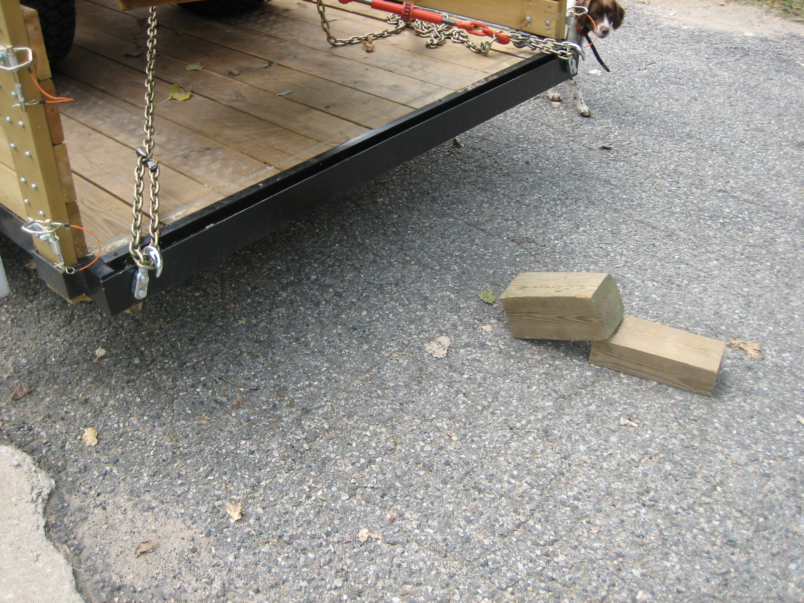

I though I would share how I handled the trailer situation. The tractor is a Kubota B2620, with filled tires it weights about 2000 lbs, MMM is about 300 lbs and loader is another 600 lbs, total is 2900. The trailer is a 7k by 16' tandem that weights 1300 lbs. The sides I built are 5/4 x 6 treated deck boards, about another 300 lbs so the trailer is 1600. Total load is then 4500. The truck is rated at 5000 for the trailer load. After a few hundred miles it seems lake a fine match. Notice the aluminum ramps. Very light but rated for 5000 lbs. They are Dambach's costing about $200 delivered. The rear support is obvious and if trailer settles on it, just drive ahead 3'. There a lot of ways to rig your trailer but this works for me.:)

   / My way #4
For trailer support I use jack stands that have the handle you lift up to release. Works slick.
jb
   / My way #5
I had a set of ramps once upon a time like those you have only they were in steel. The very first time I used them was to load a Chrysler shadow (very small car). As soon as the car front tires were midpoint on the ramps they fell to the ground in a crumpled mess. I think the ratings are a little miss leading. I would be careful and maybe block the center of them. They are really designed for lawnmowers and ATV's.
   / My way
wkpoor
Nope, these are not for atv's. Check out Dambach's web site. They have ramps good for 10,000 lbs.
