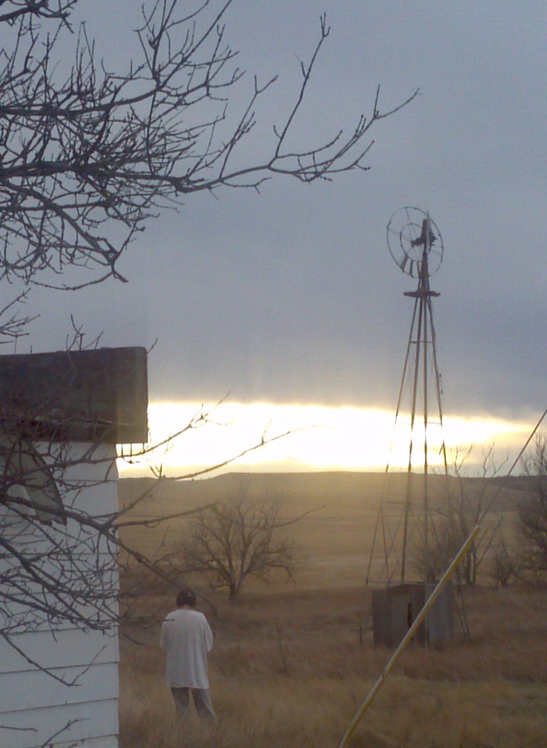

This has to be my day for nostalgia. I visited dad's now abandoned farmstead I for the first time since 97. The windmill which was so familiar now looks like a plucked chicken. Quite sad really.
