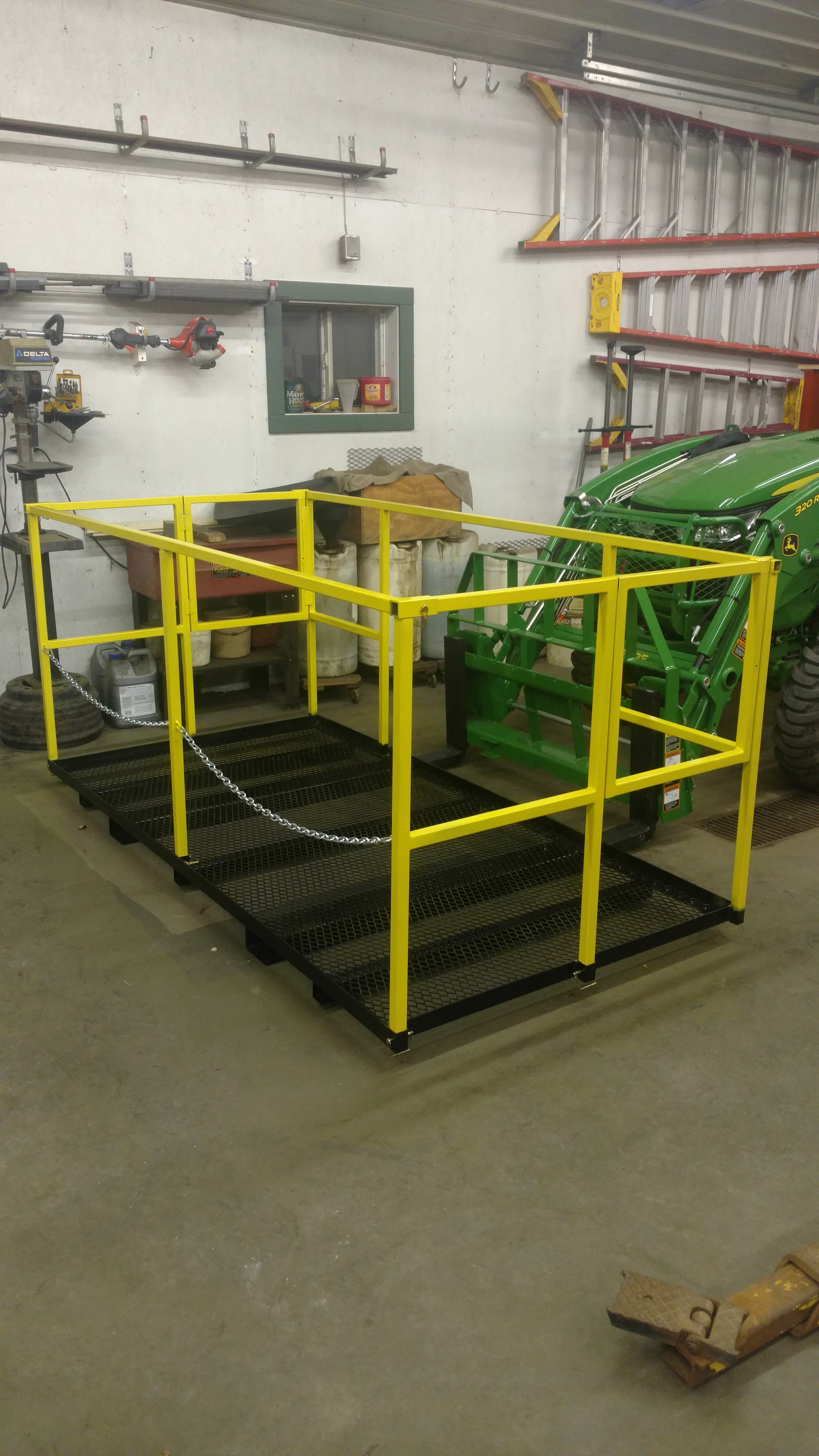

I absolutely hate ladders. This is my latest none ladder.
Front and sides come off with only removing pins.
Back side is welded.
Stays on pallet forks with 2 1/2" draw pins that run thru 3" channel and 3/8" angle. That allows scaffolding to float on forks and still be stable.
240#s 3033R handles it very nicely with 2 men and equipment.

Looks good, but do you need to have someone else operating the tractor to raise and lower it when you're in it?
   / My work platform. #3
Nah, Mate. A very looooong handled hoe will reach the joystick. She'll be right... :thumbsup:

Nice job but I do find the picture ironic. You hate ladders so much yet you have three hanging on the wall.
But now he will not be using the ladders any more.:laughing:
Welcome to the forum and very nice build on the cage.

I’ve done that!!! Works real well until you drop the handle or it rolls off the platform
   / My work platform.
The back half of both ends are gated. I will have to use a ladder

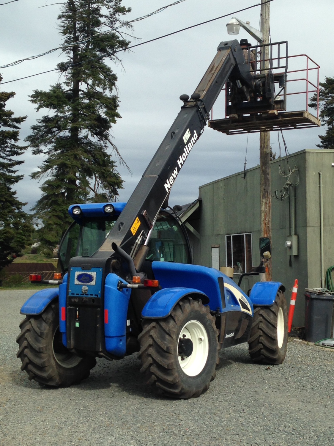

Here's my work platform, it's 4' wide and 10' long (I wish it was about 2' longer)
I can boom up 34' :)
