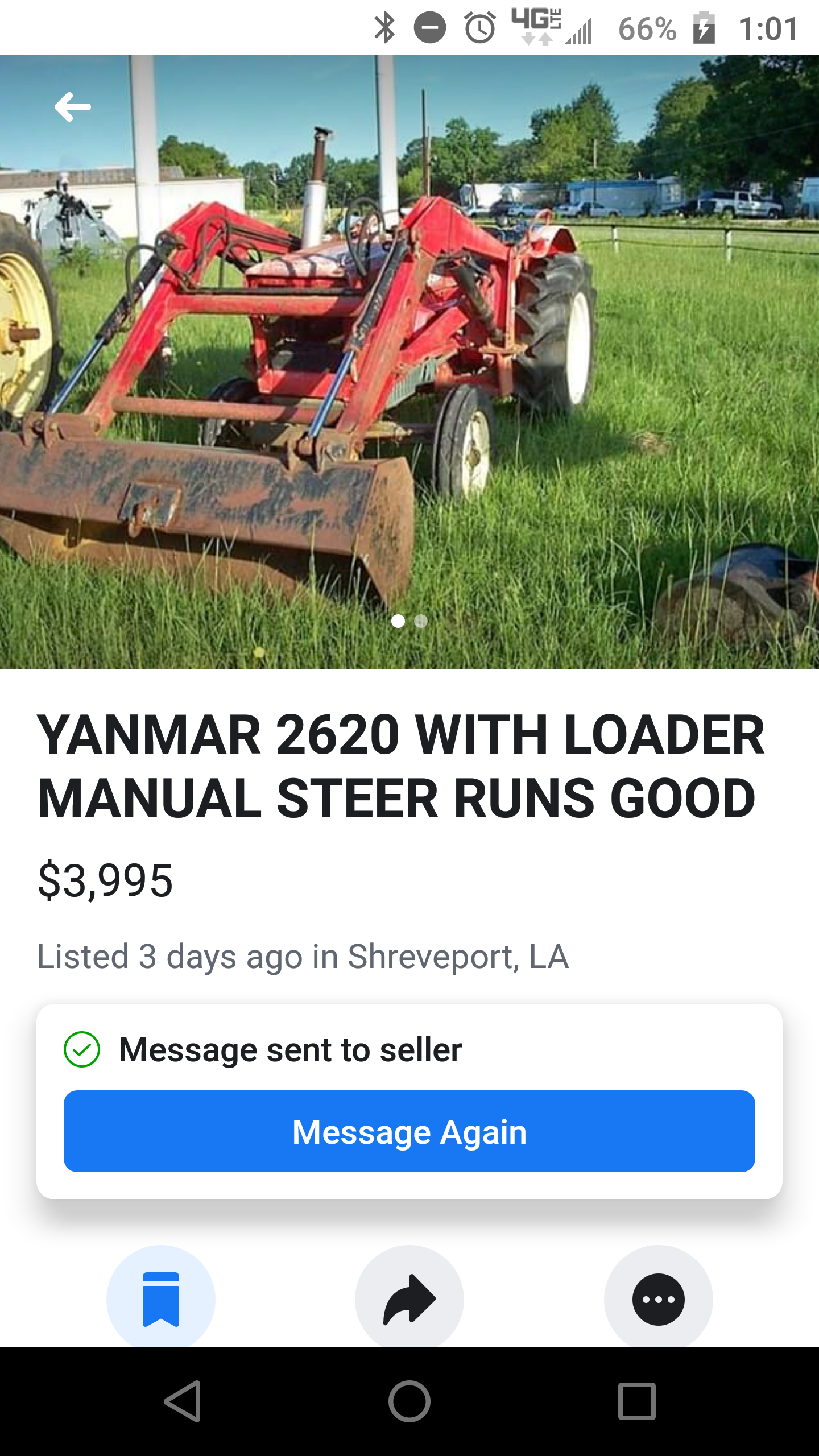

The loader on it almost seems like it came from the factory with it, but I don't believe they were ever produced that way. It's painted red, same as the tractor, and there are no descriptive markings or stickers on it anywhere. At any rate I've got a lot more to read and learn.
Thank you all for your replies thus far.
   / My Yanmar 2620 #8
Post a picture of it. People will tell you what it is or if it's home made. These guys know what the loaders are o. These things.
   / My Yanmar 2620
I think the Yanmar-Japan loaders had curved arms in that era. Does this one?
No, it has straight/angular arms like a koyker. I did actually find a sticker on it, saying it is from 'Apple Implement MFG'. Here is the only pic I have of it at the moment:
