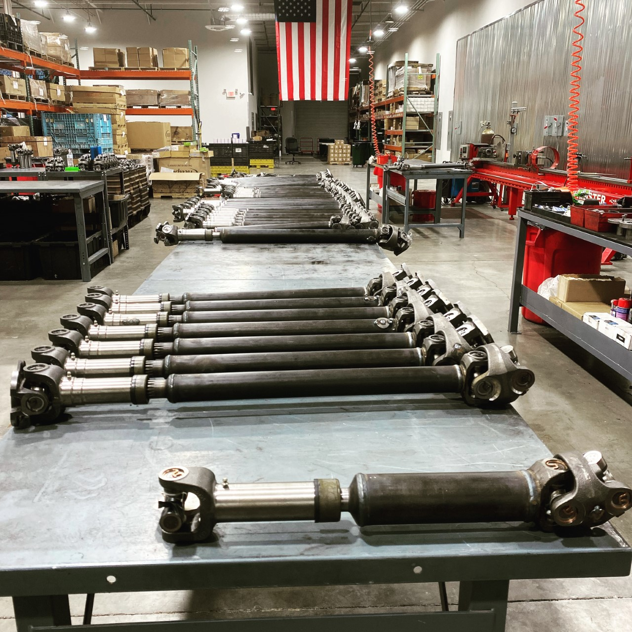

@beankp60 Any luck?
These folks do lots of custom driveshafts in the US, and not just for off-road;

Peter, a really nice find. (y)
FYI, use their measurement page to determine how to specify what lengths you will need with the interfaces!!!

Thanks, and I hope it is useful to others. To be clear, I only know them through others who have bought unique driveshafts from them, and all of them rave about them.
