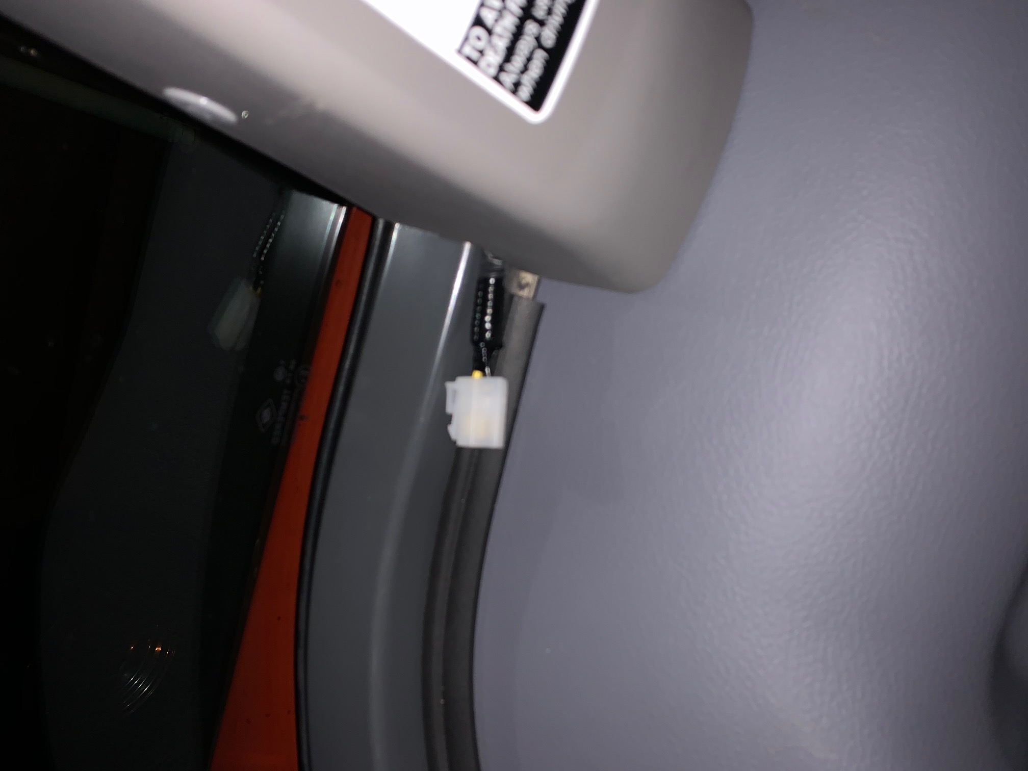

Hello,
I noticed a mysterious connector in the cab of my new tractor. The tractor is an L3560LE and the connector is on the left side of the cab near the bottom of the left window (see pic). Anyone know what it is for?

Worklights, or optional heated glass?

It's for the worklight. The fuse is on the fuse panel below and to the left of the steering wheel. I think it's ten amps.

On mine that is just keyed power. I tested it and it was not switched, key on = power on, key off = power off. Saw somewhere that it was and auxiliary power.

I will put a multi meter on mine later today and check it out. Thanks for all of the feedback.

I think that is for a heated rear window or wiper;on a cab Kubota the work light(rear) are (out-side)wired under the caution lights.I hooked mine up and bought the switch from Kubota.

I would agree. My L4060 has the same plug; my tractor has front and rear work lights plus front and rear wipers. However, mine does not have heated rear glass.
