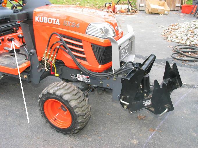

I searched to no avail and I currently do not have an owner's manual.
pic (from BX24) attached
   / Mystery knob below the seat (BX23) #2
I believe it controls how fast the 3pt hitch travels in it's downward movement. As you tighten it the hitch will travel slower.
   / Mystery knob below the seat (BX23) #3
Probably the hydraulic control for the rate-of-drop on the lower arms of your 3pt hitch.
Cheers!
   / Mystery knob below the seat (BX23) #5
Bimmer, that a new grill guard? :)
Did you get a loader too??
Hahah, no, I snatched someone's picture for illustration purposes. I am looking for a loader!
