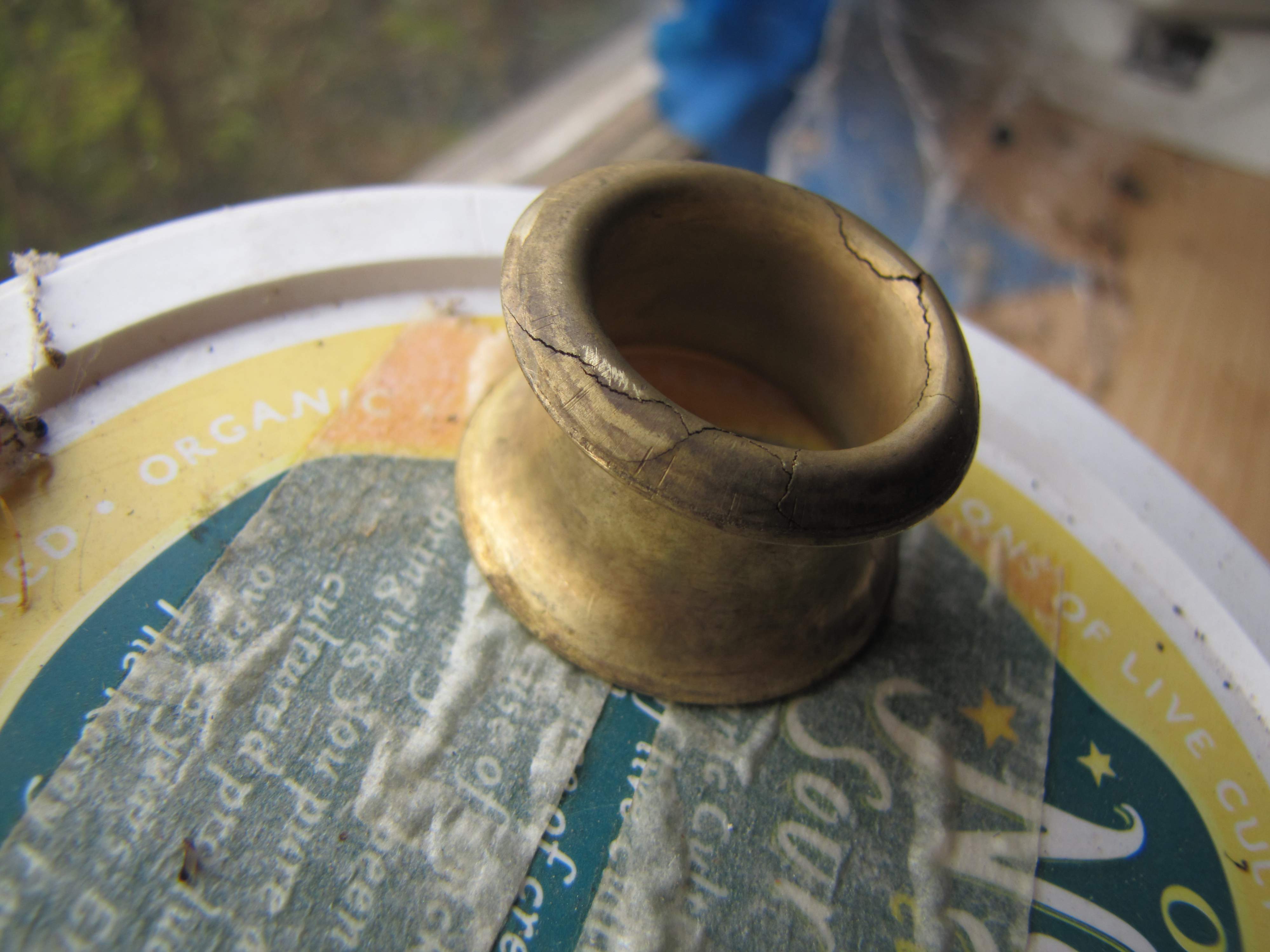

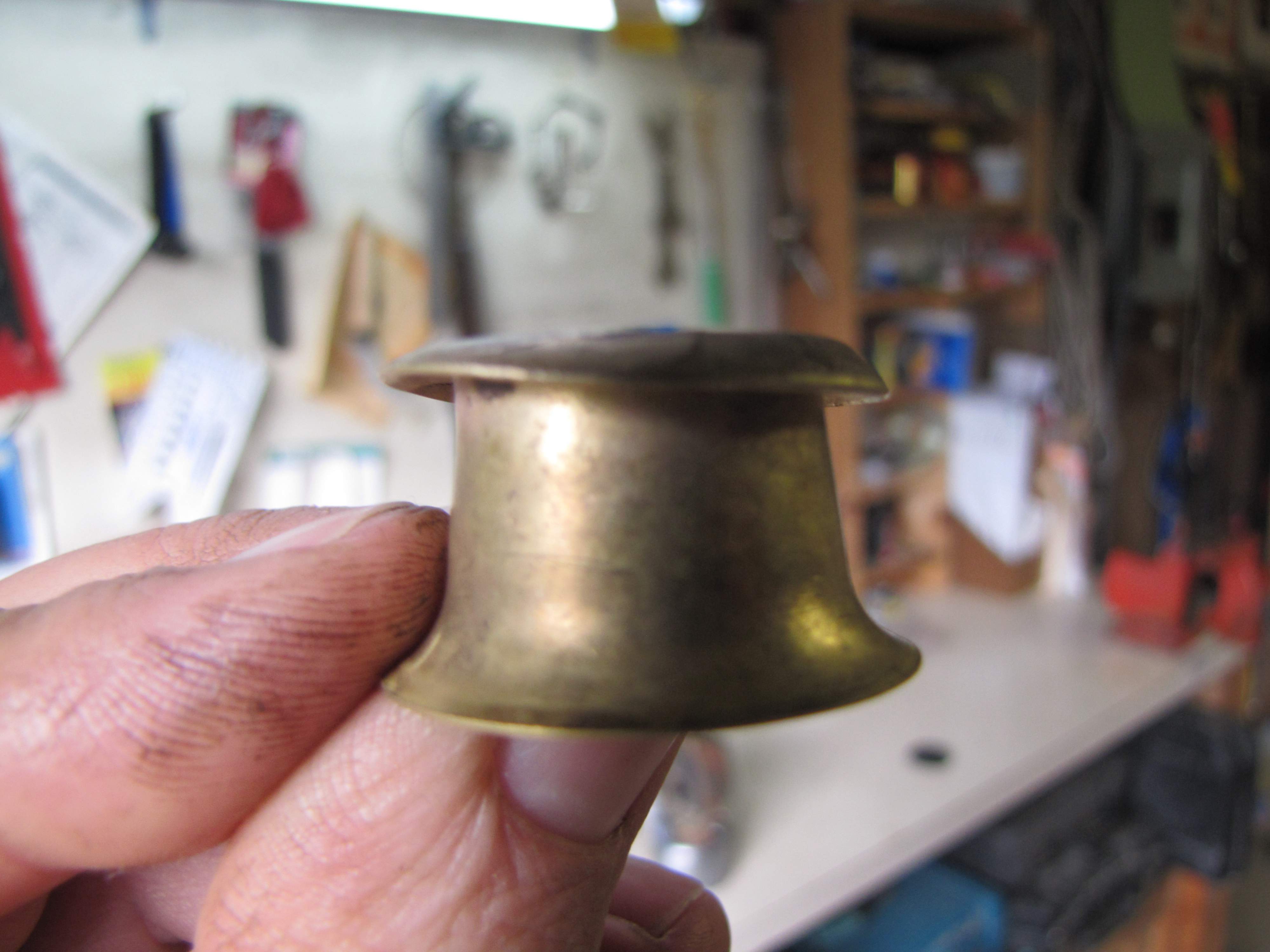

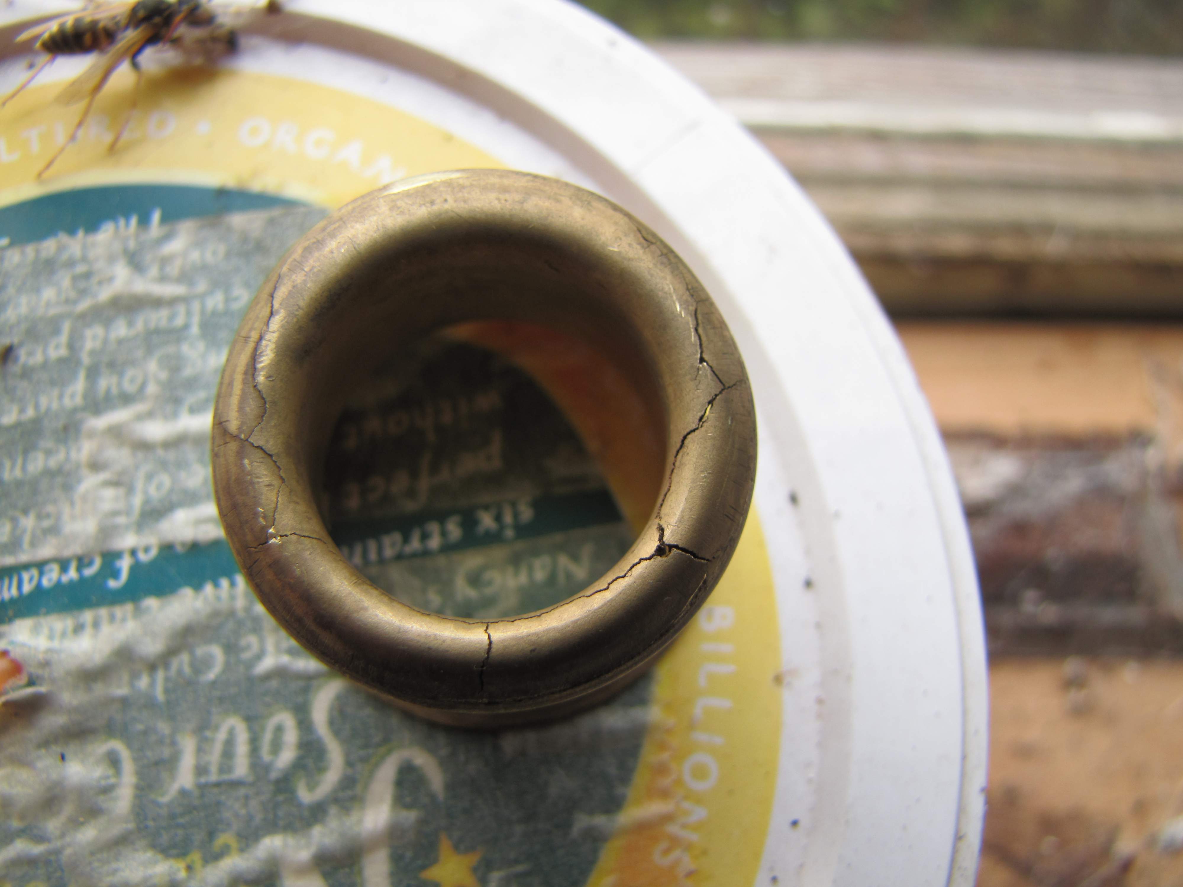

I have the carb off my NAA disassembled and cleaned up and ready to go back together. The venturi piece looks to be bent/malformed and has several cracks in it. The parts suppliers That I've looked at don't show this as a part that is available, so any new piece would have to be scavenged from another carb.
My feeling is that I don't want to put this back into the carb, but perhaps others have run into this and found it not to be a problem. IMG_2030.jpgIMG_2028.jpgIMG_2029.jpg

Try Dennis carpenters, they have good parts
   / NAA Carb venturi cracks #3
They have them for the 9,2,8 n's for 9.50, the naa carb is just about the same as the n series, give them a call
   / NAA Carb venturi cracks #4
new ones are usually plastic.
I'd carefully bend that one back out with care to not print the brass or copper it is made out of..a pair of pliers and some scrap thin cardboard may do.. take your time.. work it a bit.
on the cracks.. get them bent true.. then lightly sand to celan.. then solder up.. then file and sand the solder joint smooth
I've fixed many soldering them.. floats and bodies too.
