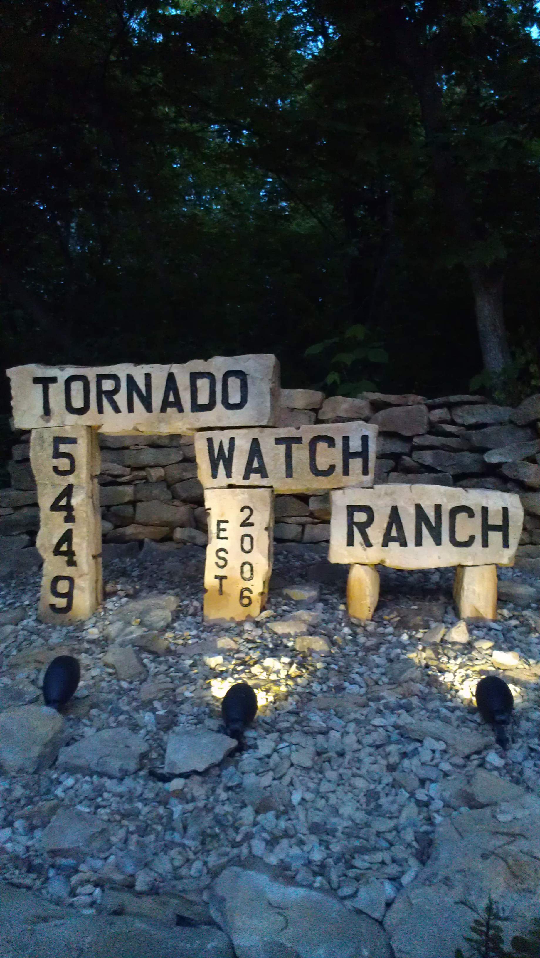

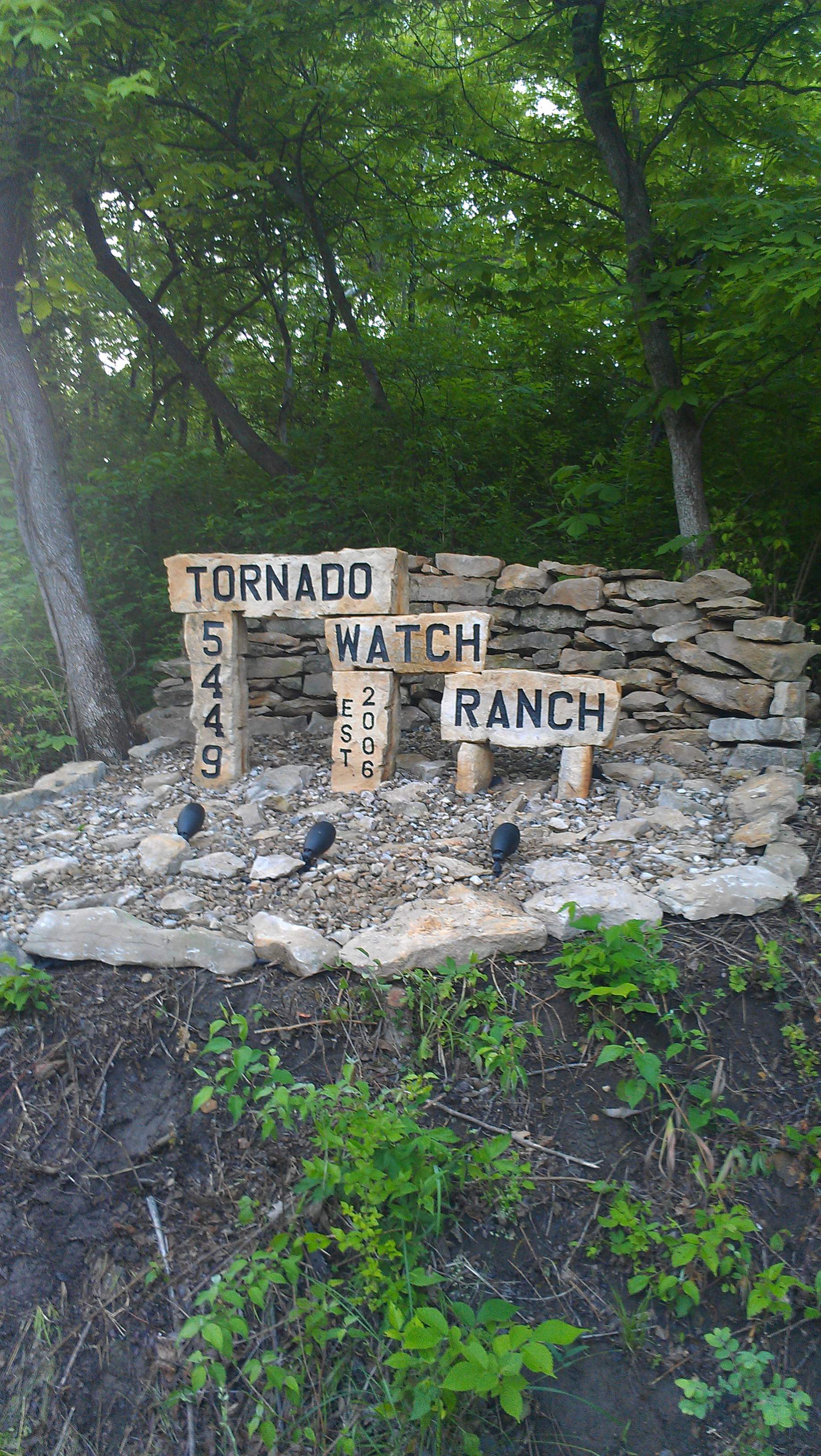

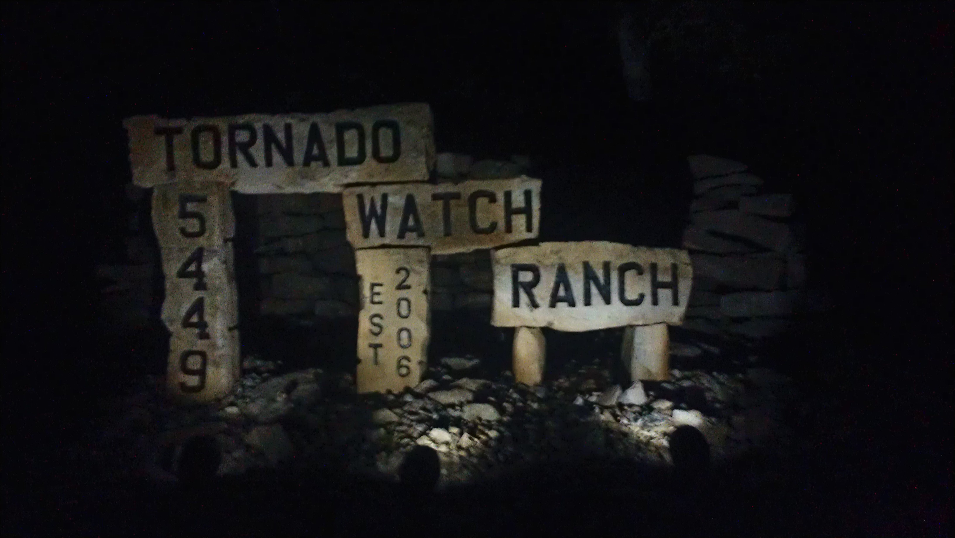

#22
Here is the finished project. The left two posts are set 28 inches deep. The right two are only 14 inches as they do not come up that far and that is the size of the post I had available. The solar lights last almost all night. When I walk the dogs at 0500 they are just about dimmed out but recharge nicely during the day. The location does not allow for much sun so I am sure it would do better in full sun. I drilled rebar down into the bottom posts which protrudes up into the next layer about 6 inches but does not go all the way. I did not want rain to get in the holes. Where the rebar goes down filled the holes with liquid nails prior to placing rebar. This is daytime, twilight and night. The night pic does not do justice to how bright the lights are.
