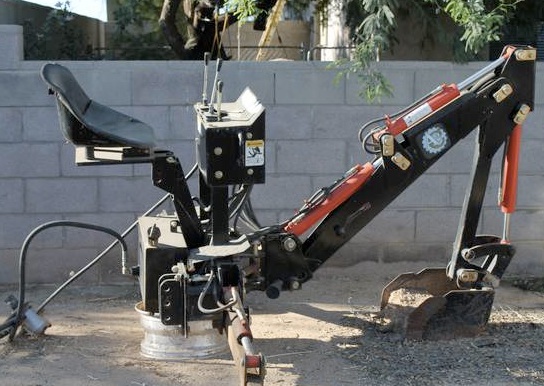

ive been looking and looking to identify this thing just to find a manual but can't come up with anything online.. anybody ?
the bucket is very square @ 12"

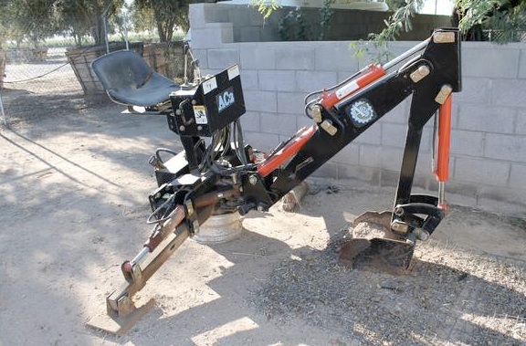

The labels seem to be intact. There should be a name plate on it somewhere with mfg and serial number. All I can see in your pics is an ACa logo that doesn't get any hits when I search.
   / Name this hoe #7
Case made a lot of equipment that started with AC2. You might try researching there.

thanks guys.. found the friction control works great. looks like a koyker older model bh as it was very similar to the 60 in a picture - with side hand bars (not top) and squared bucket..
Here's another question.. the independent pump has a shaft with a 'key' that fits onto a coupler that attaches to the PTO... that key is worn out really really bad and makes the pump slide off under too much pressure..
anyone have had experience replacing this shaft without having to replace the pump? where to get a shaft (perhaps coupler too) that attaches to pto on the cheap?
