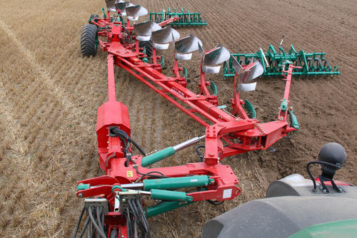

hi
Will painting attachment with nano technology paint reduce friction between soil and attachment? If this work much lower power is needed for job. But how durable this types of paint is?:confused:
   / Nano technology paint for reducing friction in agriculture attachments ... #2
I'd say save your money. Paint will wore off in minutes in any ground engaging equipment. Even the nano stuff.
   / Nano technology paint for reducing friction in agriculture attachments ... #3
I totally agree. If you owned a boat, you bet, get the slickest thing on the bottom to reduce friction. But a tractor plow or disc harrow?
Very unlikely and who told you it would reduce power needs a lot? You are trying to move the dirt, not slide by it...

Don't bother...:)
Kverneland plow nice paint on the moldboards when delivered from dealer...:)
Look at the moldboards after a season of plowing...:)
