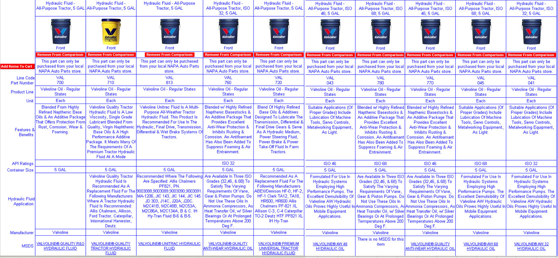

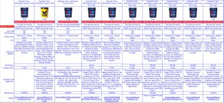

Folks,
I was looking for some hydraulic fluid specs for the different 5 gal pails that I have in my shed. Specifically since I ran out of 134 for my Ford 1710 while completing a change out. I ended up leaving the tractor low as none of the pails really has a good description of the specs that the oils live up to.
When I went to look online at NAPA or Valvoline, finding the specs was not as easy of a task that I would think it should be. So after playing around, I came up with the following chart. Figure I'd post it here so if ever needed someone would have an easier time then I did.
