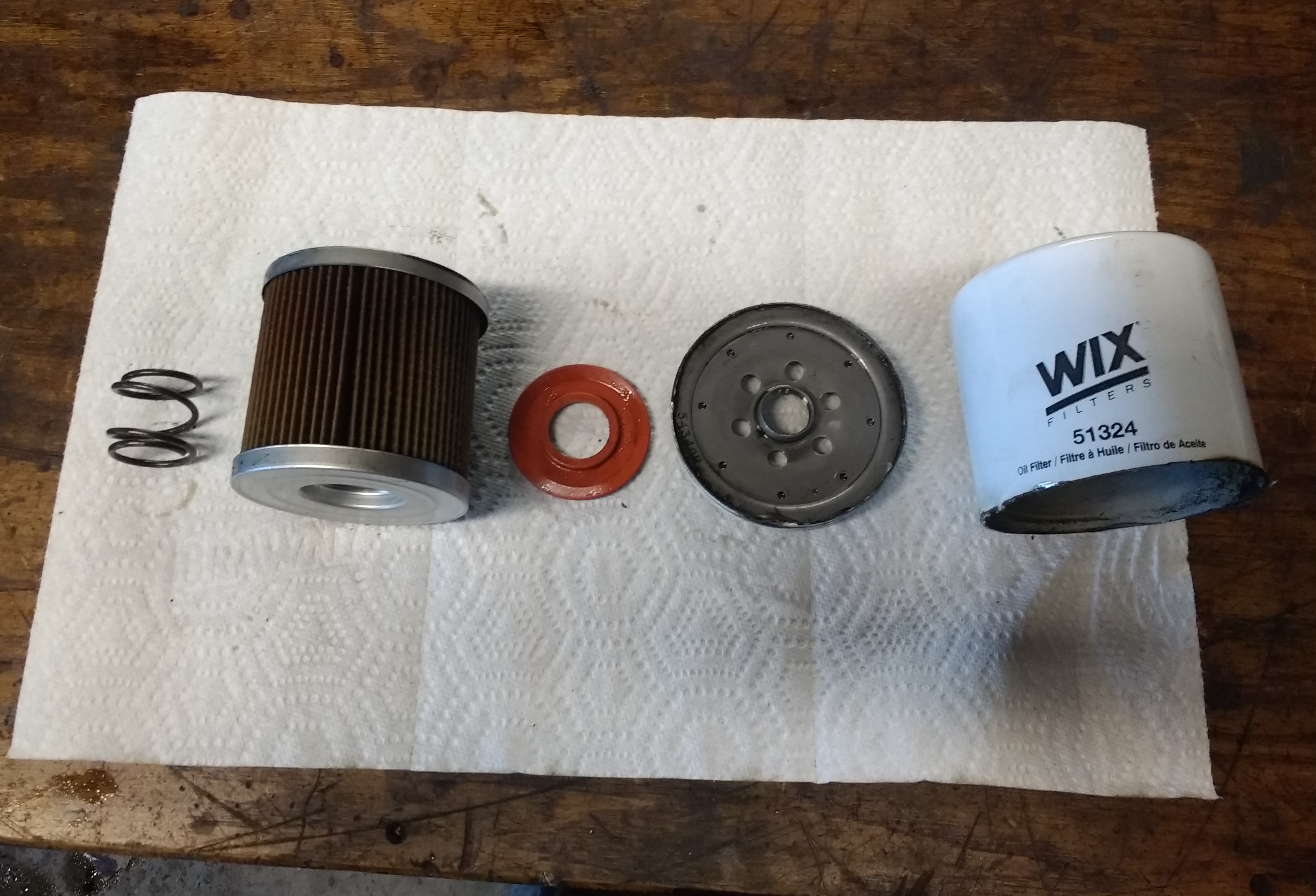

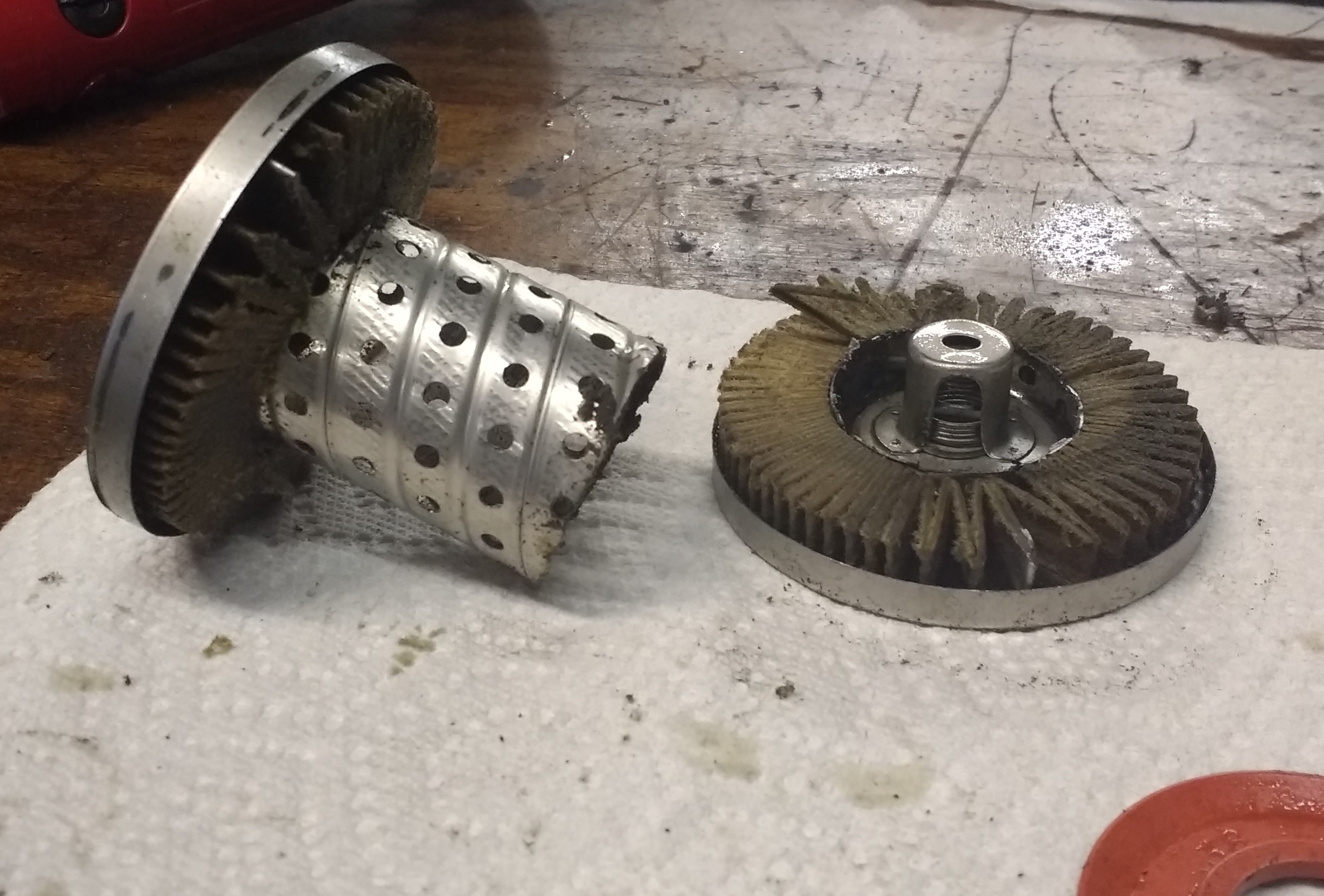

I really like the Messick videos, but after seeing this one about napa/wix oil filter Napa Filters VS Kubota Filters - Do you need OEM filters? - YouTube
I wanted to set the record straight a bit. They have a pretty unusual napa gold/wix filter there with a small filter cartridge inside. This is not typical of wix filters from my experience cutting them open.
Here is a picture of my most recent wix 51325 (Napa1325), a cross reference for kioti E6201-32443 I use on my DK45se.
You can see here that the internal filter cartridge is not unusually small in any way, and has plenty of pleating. It appears as though the messick video has taken an unusual circumstance from the bottom of the barrel, and brought it to the top, effectively making all wix filters, or aftermarket filters for that matter, appear of lesser quality. Wix makes a number of filters for the same engine in many cases, with low, medium, and high capacity. I don't mean to bang the particular drum of wix, there are many great brands. Donaldson, Parker, Purolator ONE, and Fleetguard to name a few.
I still like the Messick videos, They were just using an example they had. I just wanted to point this out for people who live a considerable distance from a dealer, and have a Napa right down the road. Don't fret aftermarket filters, you don't always have to make that 2 hour drive to the dealer if you have done your research.
