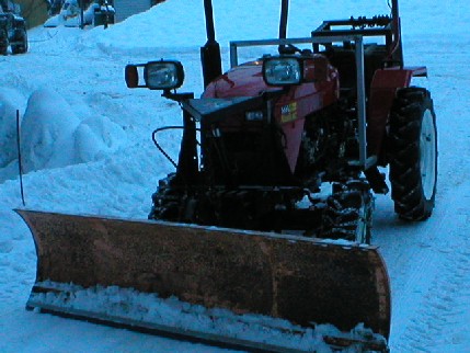

Not quite understanding the size of your machine /forums/images/graemlins/frown.gif I ask why would you cut it down? I have a 20hp compact and it handles the 7' plow just fine. the width of my unit is 49" if I remember right.
