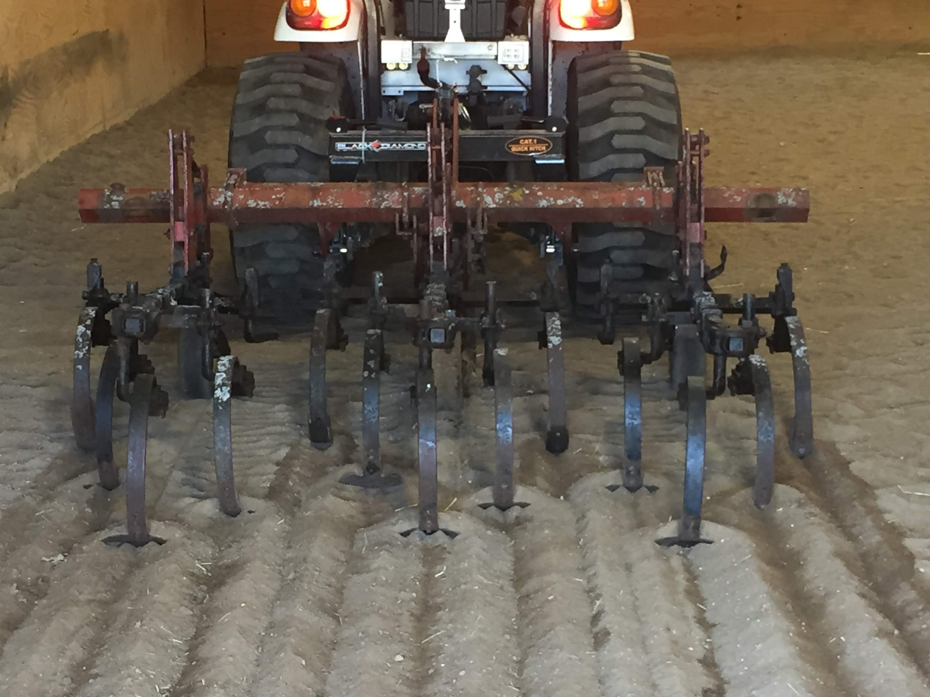

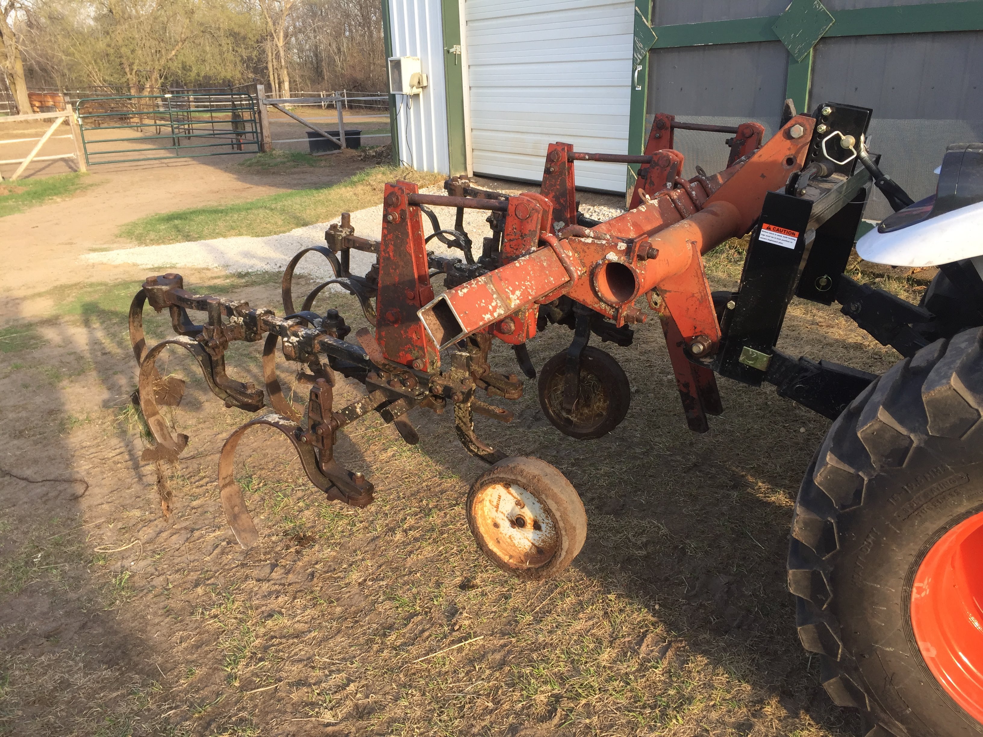

I found an old row-cultivator and compressed it. I use it on my 30HP CUT. I need to get through an 8' door with it - I narrowed it down to about 6' but I left some extra main tube so I can spread it out more if I desire. My tractor handles it pretty well in our soil. It cost me $200, a couple cut-off blades, a lot of penetrating oil and a few hours.

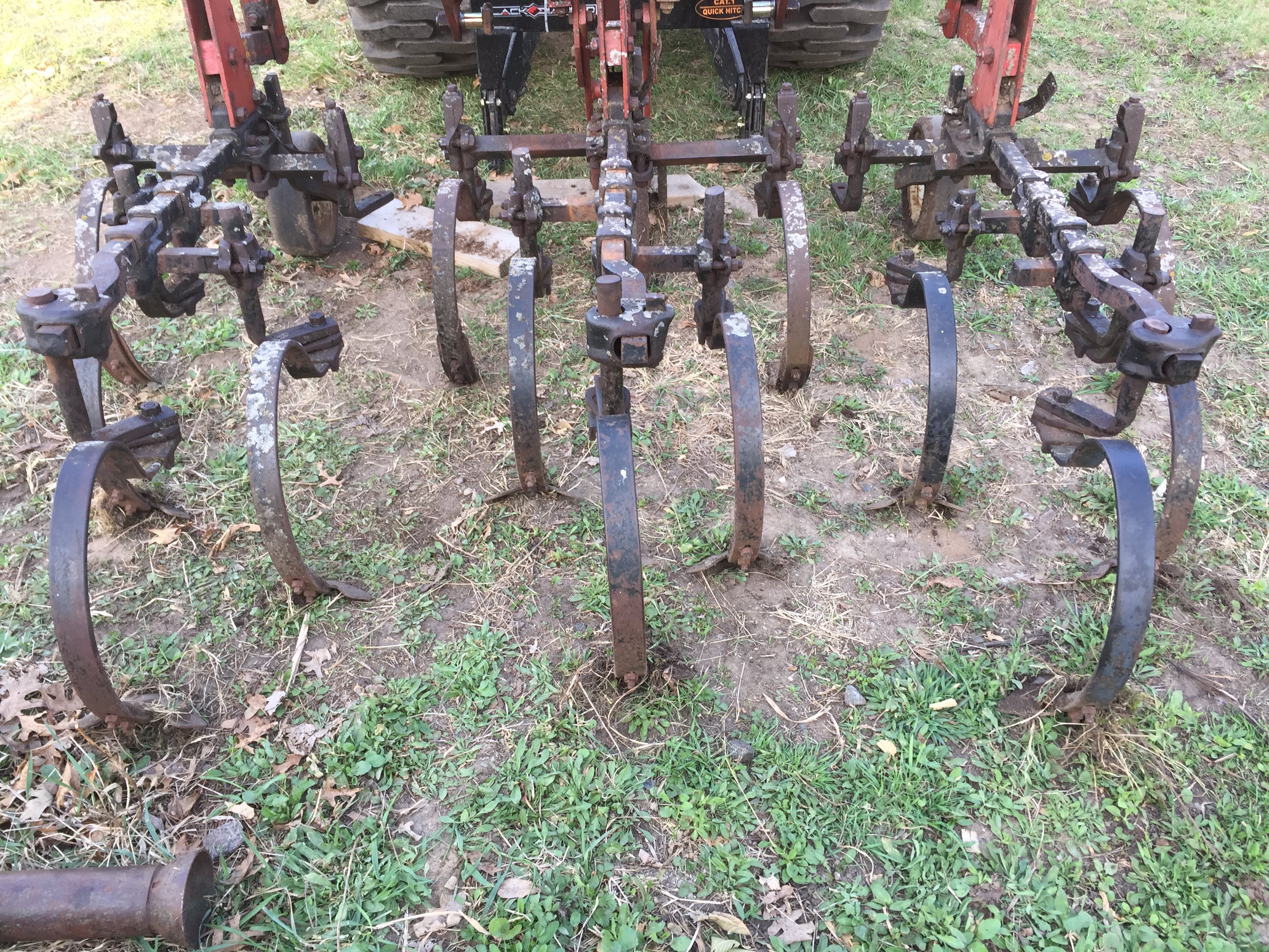

I bought a Dearborn 13-2 cultivator for the same purpose last year. It痴 7 wide and works very well behind my tractor. I have about $130.00 in it after putting new teeth on it. It works well in new ground, here anyway. Not sure of your soil composition. You need to make multiple passes at progressive depths. For new ground I bust it once, give it time to soften from a rain, the hit it again.
My garden this year after three passes probably won稚 need the rototiller prior to planting. They are built very tough and parts are easy to find, although all I have had to purchase are the teeth. I would think your 45hp tractor would pull it easily.
