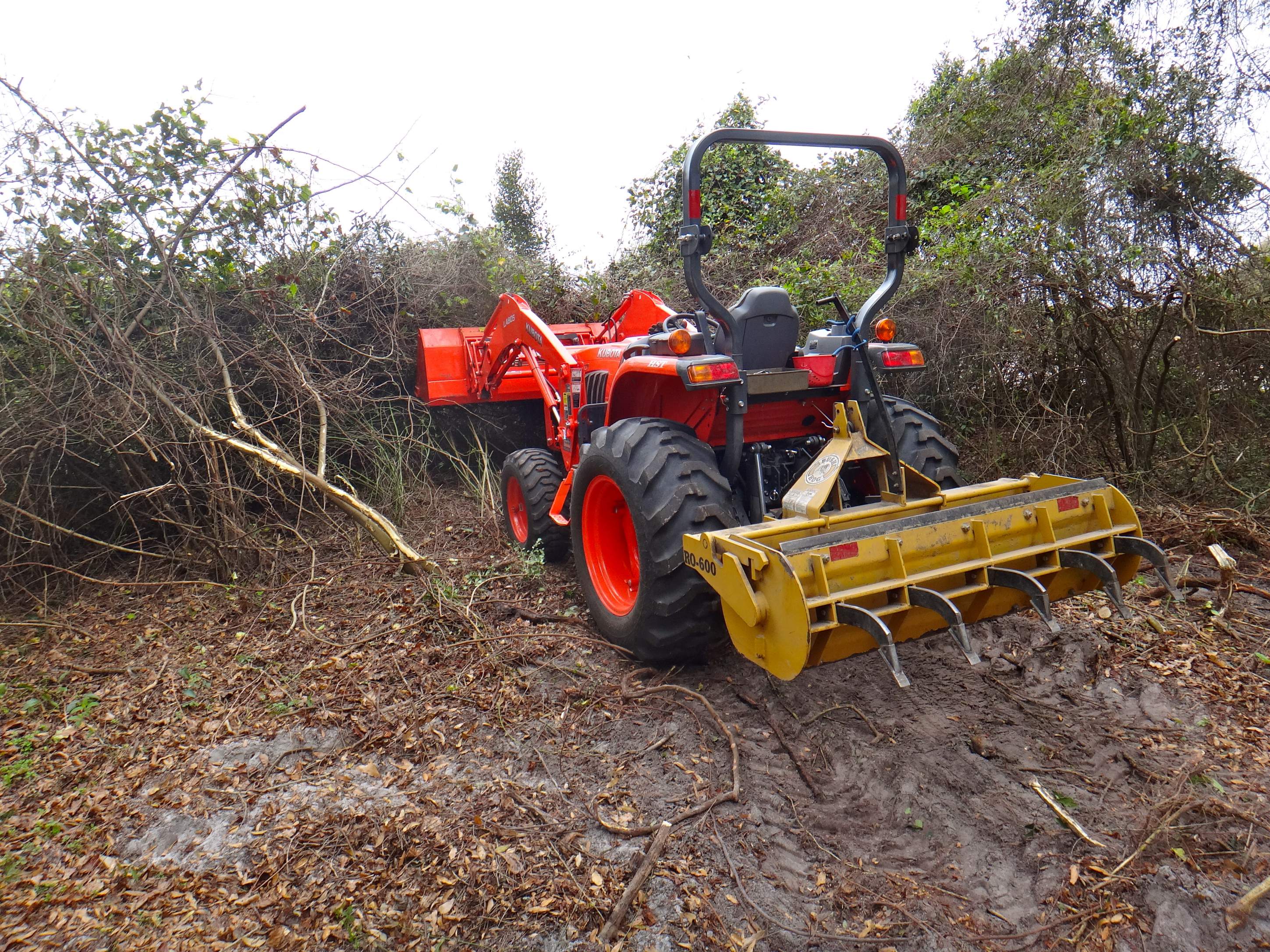

A Rotary Cutter on the Three Point Hitch and a Ratchet Rake attachment for your bucket will handle those Blackberries, although control will take a couple of seasons. If you want to speed up control spray herbicide after mowing brambles down.
The Ratchet Rake is also good for minor grading of all sorts.

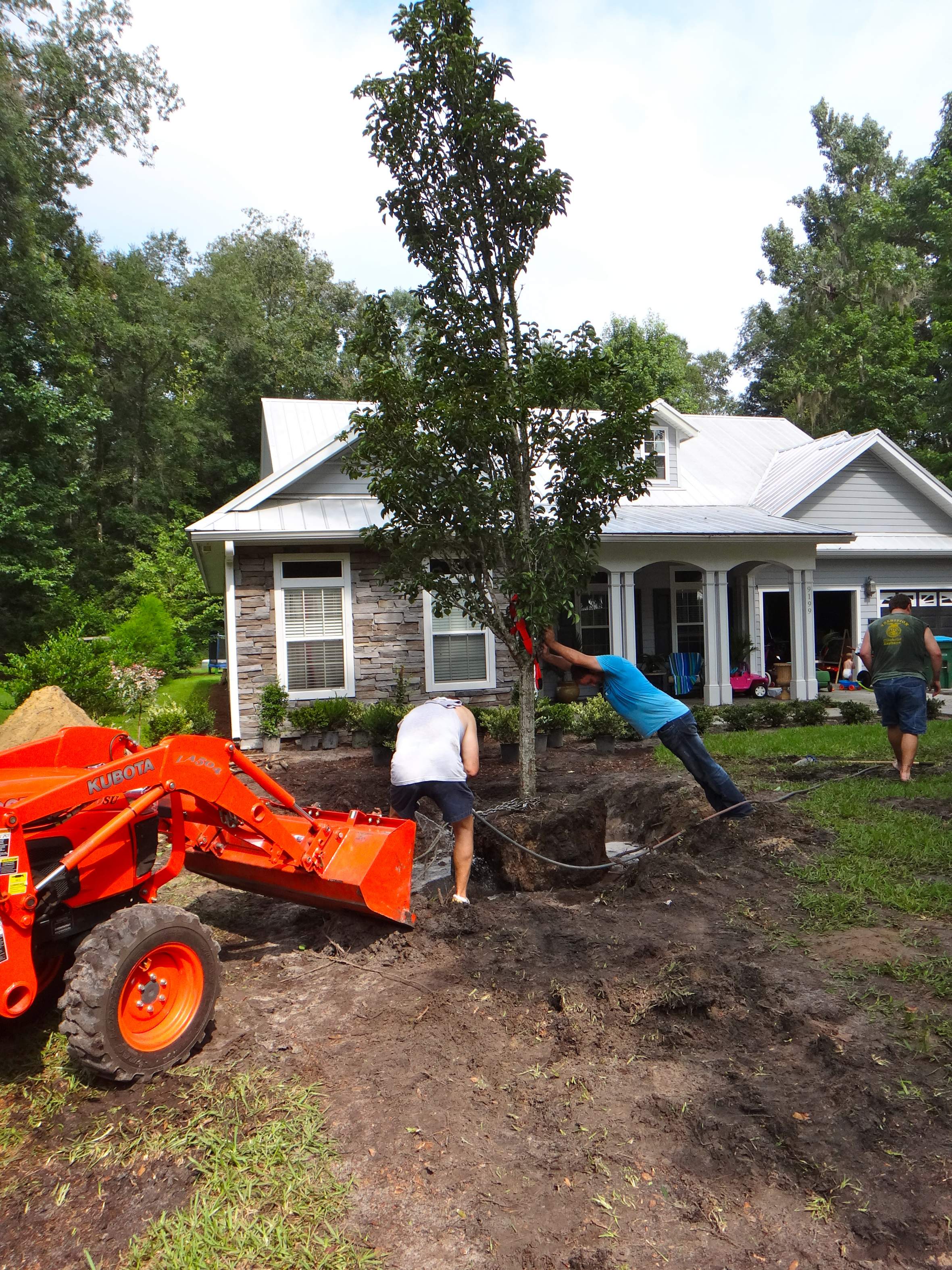

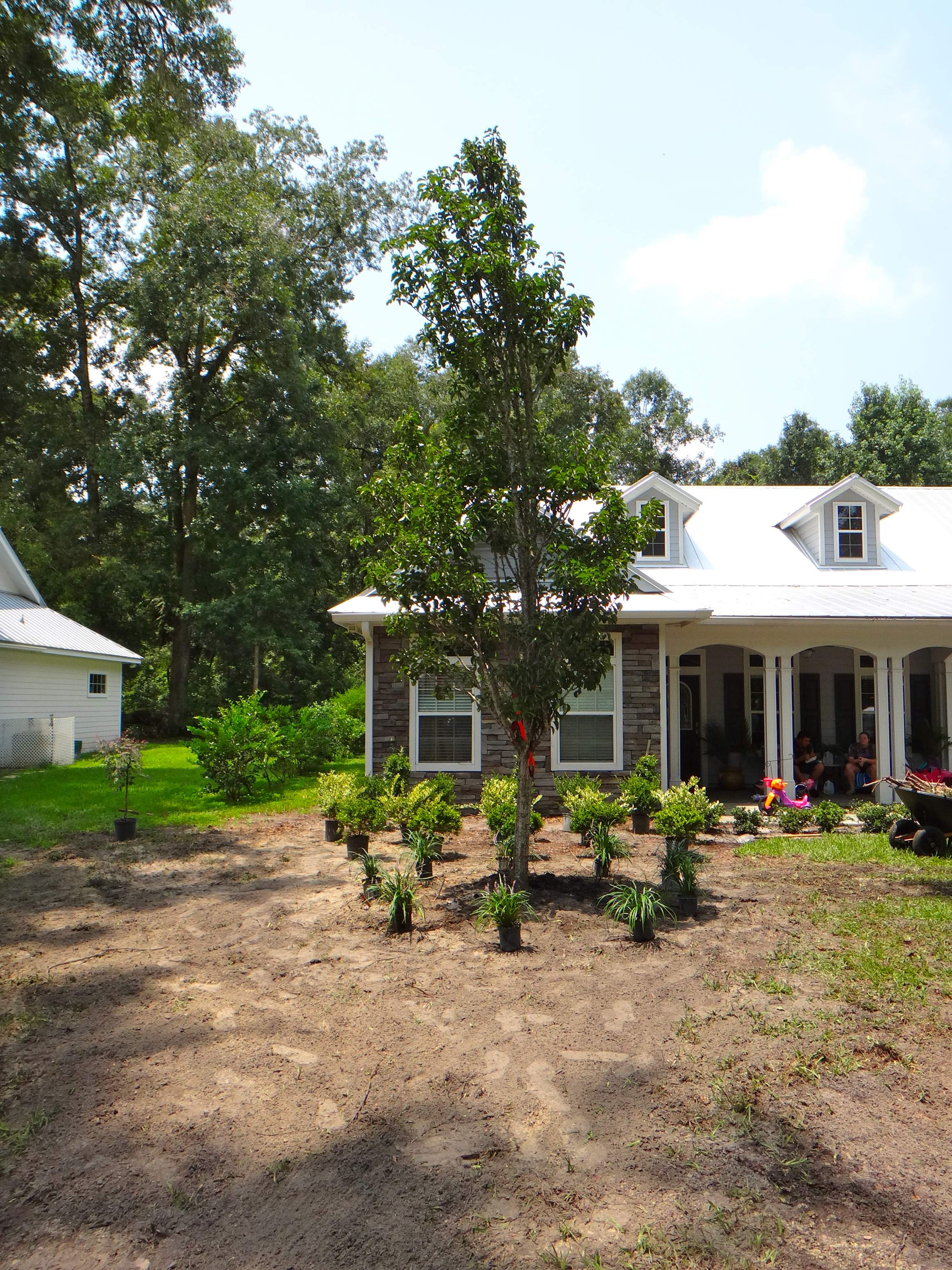

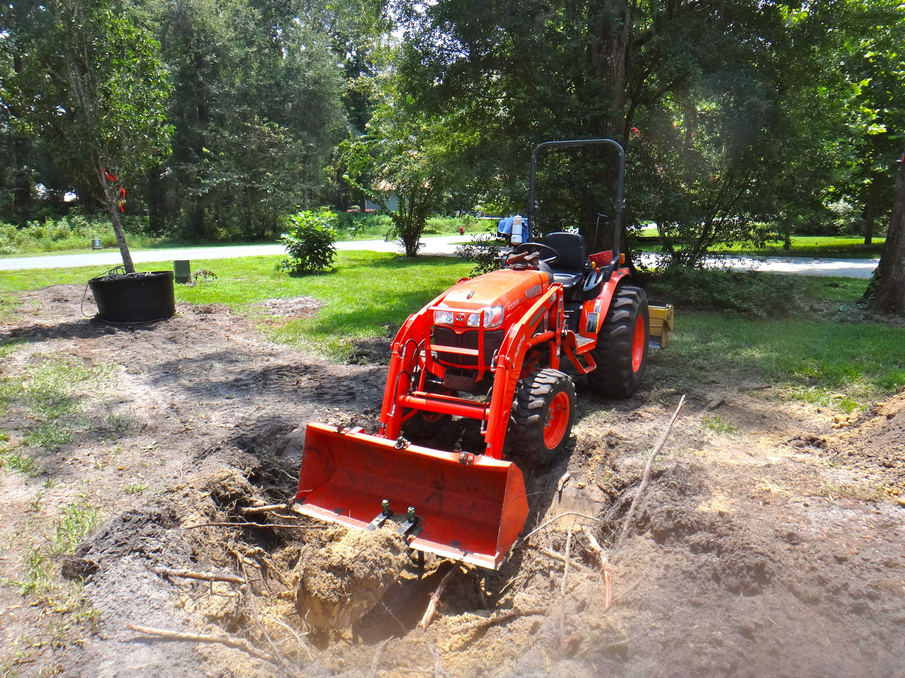

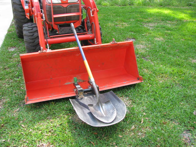

If you acquire a heavy enough tractor with a proportionately heavy FEL and bucket, a <$400 Bucket Spade attachment works very well for planting trees.
I have a Kubota L3560, my third tractor, and rate it a great tractor-loader. I was out rough cutting brush with my Land Pride (brand) RCF2060 Rotary Cutter all morning. Like so many others it took me quite awhile to realize what 'enough tractor' would be for my conditions.
