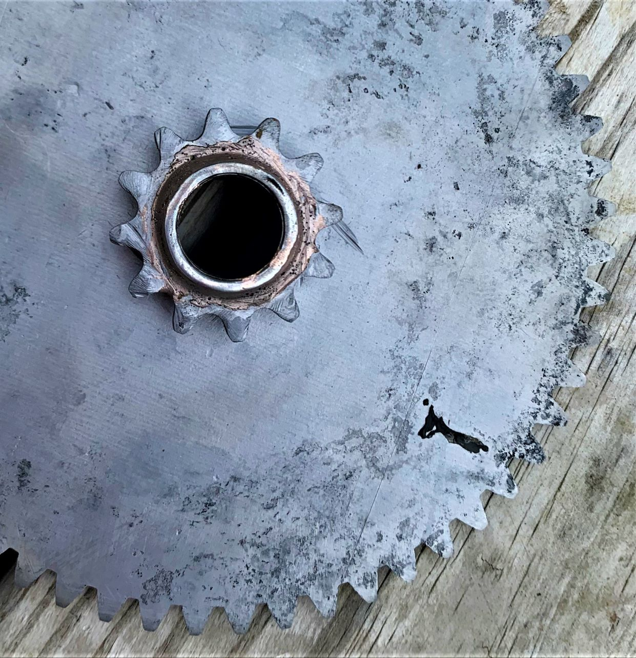

Got my hands on this a Craftsman tiller 917.293482. Think it was manufactured in 2002. Took a little work to get the engine running but the transmission has stumped me. Found a gear missing teeth and I can't find this gear anywhere online. Was wondering if anyone has new-old stock around or a broken tiller they're selling parts from.
Partstree.com shows them in stock but after a phone call they do not have them. No luck on ebay or contacting Husqvarna via phone. No local shops have one either so I'm sitting on this pile of parts. Kind of feels like a dead end. Would appreciate any leads!!!

DONE -
A local machinist cut the other teeth down then brazed a new sprocket onto it.
