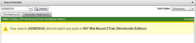

JD parts number AD882534 mower fuel injector pump
Where did you get this number? It doesn't show up on the Z997 parts list.

The part number was given to me by the Green Parts store. The usual parts listed on the JD catalogue website and all the dealers websites only contain information for model years 2015 and newer. One has to email or call the dealer to look up the part numbers for older units. A real pain.
