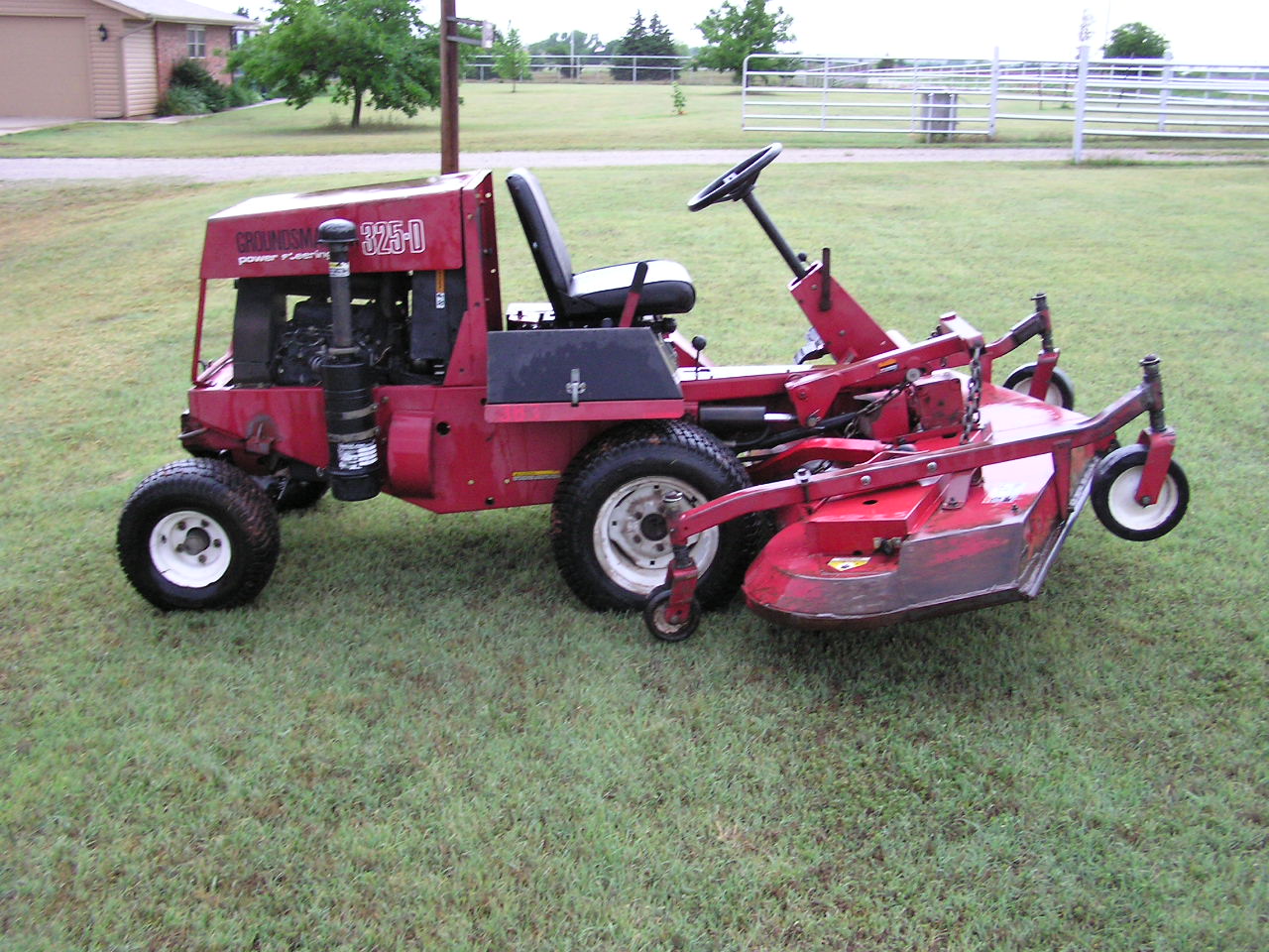

Here is my 6', found it on eBay. Much faster than a shredder.

Yep, me too. This one is diesel, 3 cylinder, 25 hp. 4WD handles hills no problem, 6' deck will cut 1 inch brush easily. I got it to mow the dam and brush at the edge of the woods.
