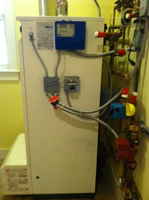

#9
water.JPG this is a mystery heater,42 gal tanked unit i think,even my plumbers baffled,2001 triangltube HMG-30P 42 GAL 120BTU something
   / Need a new tankless "combi" water heater
not sure if its tanked or tankless...someone broke into the home i,m buying and cut the copper pipes out...outa my pocket unfortunatly cause its a "hud" home
